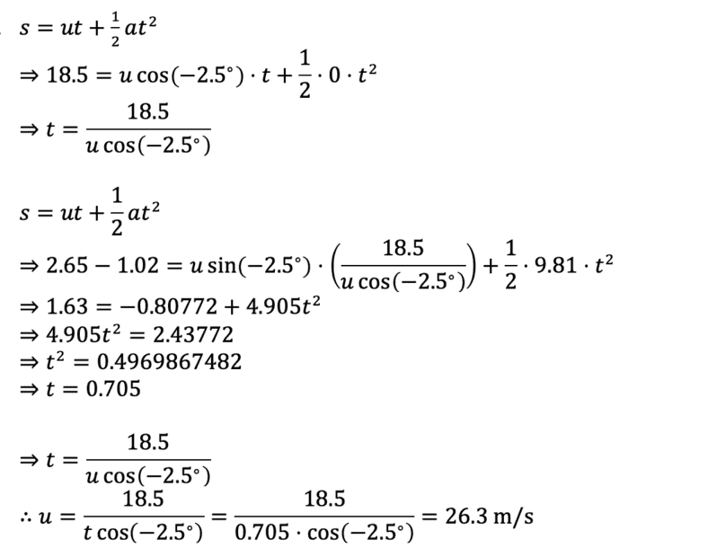

A pitcher throws an overhand fastball from an approximate height of 2.65 m and at an
angle of 2.5° below horizontal. The catcher, catches the ball high in the strike zone, at a
height of 1.02 m above the ground. If pitcher's mound and home plate are 18.5 m apart,
what is the initial velocity of the pitch?
s = ut + 0.5 at^2
Answer given in book: 45.2 m/s
My reasoning was to use this kinematic equation to first get time of flight of the baseball using horizontal components, and then use this same equation again to find initial velocity.

Hello @Kaiser98 .
:welcome:
You are inconsistent with your use of signs.
You have vertical distance the ball drops as being positive as well as acceleration due to gravity as being positive. That's all fine.
However, you have the angle below horizontal as being negative. Since you had been treating the downward direction as being positive for the other quantities, so should the 2.5° angle be positive.
Likes PeroK and Kaiser98
Also, your solution uses unnecessary algebra and the more you do of that, the more you expose yourself to mistakes. Why not substitute ##t=18.5/(u\cos(2.5^o))## in both occurrences of ##t## in the second (vertical) equation and solve directly for ##u##?
Likes Kaiser98
I did what both of you said, and finally got the right answer. Thanks a lot!
Likes kuruman
