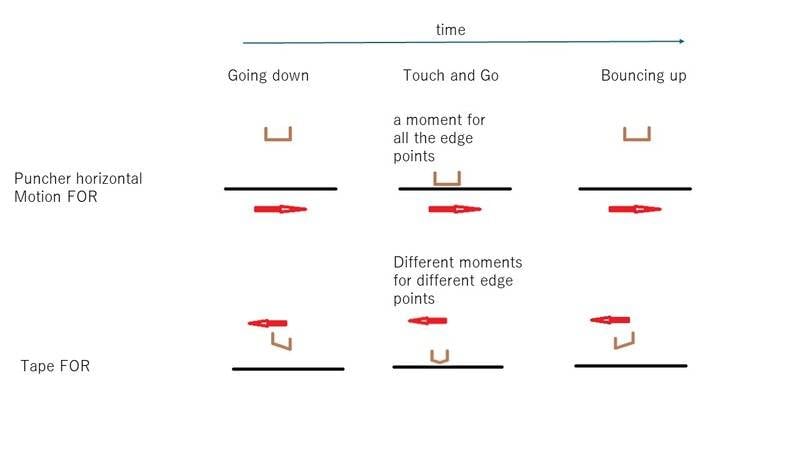

I think that this how the thing works in the puncher FoR, on the left, and in the tape FoR, on the right:

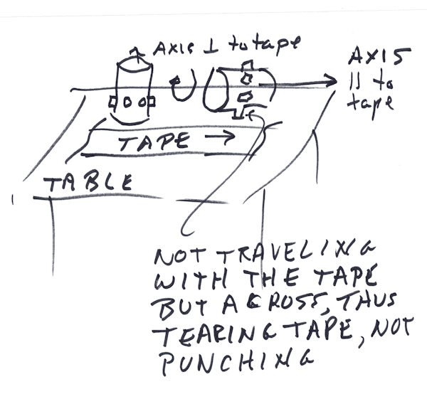

phinds said:
Which is exactly what I was pointing out. It won't punch holes in the tape. So ... the issue is in the statement of the problem.
No. The problem is fine. Yes, if the tape is horizontal then the cylinder axis is vertical. It then moves down through the tape - making a hole.
So I do not agree with your assessment. Granted, the cylinder being very thin means it is more of a cutting ring than a cylinder.
Indeed. The cut is simultaneous in the frame where the cylinder (or rather - circle) is horizontal. In the tape’s rest frame, it won’t be.
I really do not understand. The tape is in a horizontal plane. The only way a cylinder can cut a round hole into it is when its axis is vertical, i.e. perpendicular to the plane.
The cylinder is above the tape, then it goes down through it and emerges below it. If the tape is not moving horizontally, the hole is there, and it is definitely round.
Now the question is: what is the shape of the hole if the tape is moving horizontally, and the cylinder moves through it vertically?
Of course, if the height of the cylinder is finite the answer is "a mess". I think this is the reason why the height of cylinder is assumed to be extremely small (like, the cylinder is really a circle, or a disk).

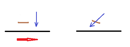

anuttarasammyak said:
Say the puncher is going down, yes.
Sure. Here:

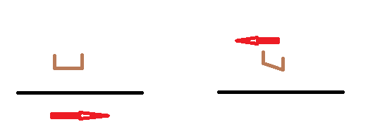

Hill said:
Not to scale, should be added. The cylinder should also be more of a line (negligible height) and the cylinder is moving down/left in the tape rest frame (it might be better with a single arrow).
So?

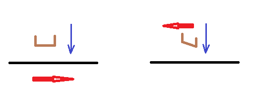

@Hill based on your interestiong illustration, I add touch and go sequence.

The left is obviously what is intended. But what are even the things you have drawn onto the cylinders? There is nothing in this task about anything else than the cylinders.
Ah. NOW I get it. Everyone but me is talking about a cylinder which IS the punch. I was envisioning a cylinder with the punch thingies around the circumference of the cylinder.
