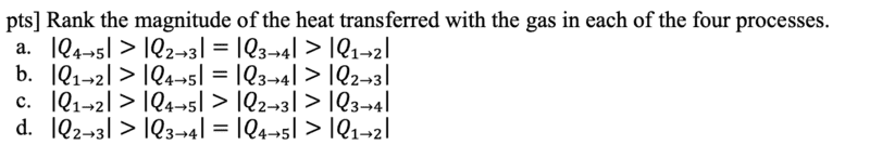

Rank the magnitude of the heat transferred with the gas in each of the four processes.

Problem: Rank the magnitude of the heat transferred with the gas in each of the four processes.

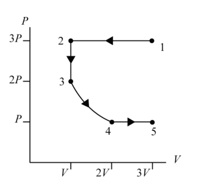

Given pV diagram

Here is my attempt at process 3->4
ΔEth3->4 = 3/2(2pV-2pV) = 0 (My professor has the answer as "0pV" and not 0, not sure why?
Wgas,isothermal= area under the curve?
Area of triangle + Area under rectangle = 2pV? (correct answer is -pVln(Vf/Vi)
|Q| = -pVln(2V/V) = 1.4pV (I am not sure how this is the correct answer)
Any help would be much appreciated!

##dW=pdV.## Replace ##p## using the ideal gas law and integrate. Note that "isothermal" means "constant ##T##."
Update, I think I figured it out but not really understanding
For process 3->4,
Wgas,isothermal = area under curve = 1/2bh + Arectangle = 2pV
We can plug in our area into the work in isothermal equation, thus
Wgas,isothermal = -pVln(Vf/Vi) = -2pVln(2V/V)
|Q| = ΔEth(3->4) + Wgas,isothermal = 0pV -2pVln(2V/V) = |-1.386pV| = 1.4pV
She doesn't want us to use integrals unfortunately
Integrals was plan A. Plan B says call the heat entering the gas during the isothermal part ##Q_{34}.## Add an extra row to the table that completes the cycle from 5 to 1 with an isochoric process. Calculate the new entries the same way you did step 2 to 3. Now add all 5 elements in each column. Note that ##W_{34}=Q_{34}## so you have one equation and one unknown, ##Q_{34}.## There is no plan C.
