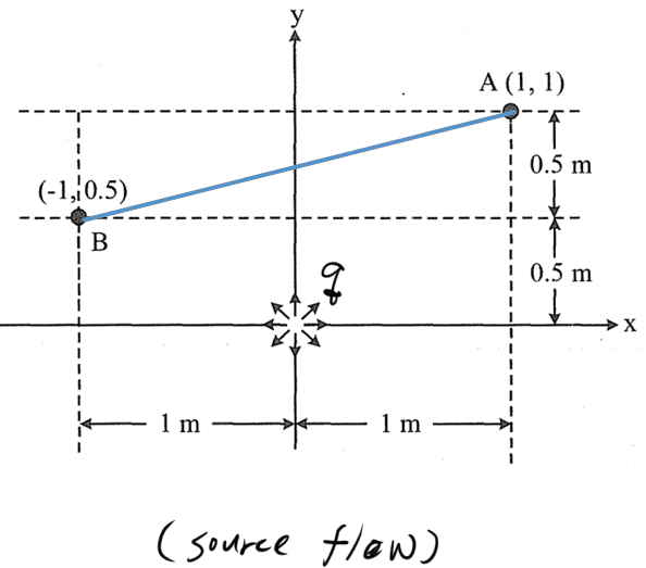

Determine flow rate per unite width in the line
flow rate equation

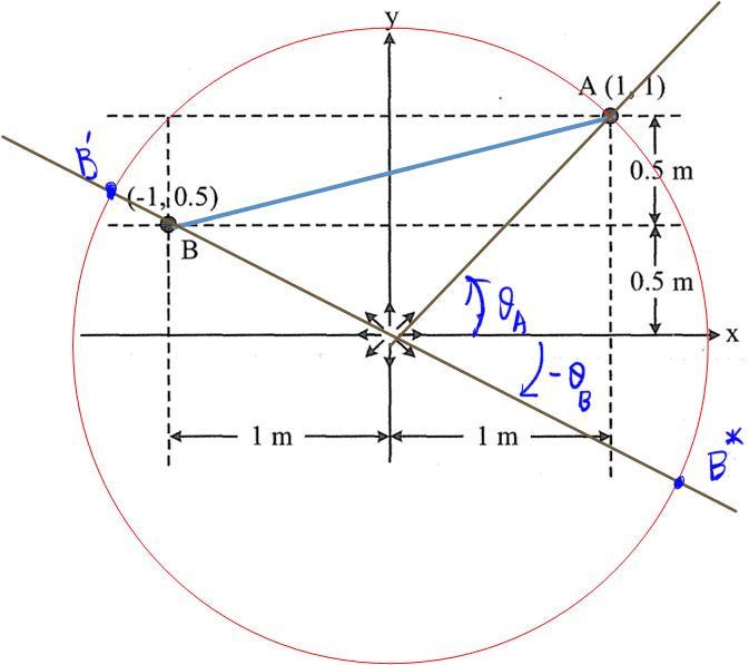

Q:Please hlep me to understand which ans is correct.To determine the flow rate in Line AB.
$$\mathrm{Known}:V_A,q,r_A = constant.$$
so/

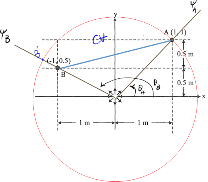

select:## A,{B}^{\text{'}},B,A,## is control volume
$${Q}_{AB}={Q}_{A{B}^{\text{'}}}=\iint _{A}^{}({V}_{A})dA={\int }_{{\theta }_{A}}^{{\theta }_{B}}({V}_{A}){r}_{A}d\theta $$$$\overset\rightharpoonup{V}=\triangledown \phi =<\frac{\partial \phi }{\partial r},\frac{1}{r}\frac{\partial \phi }{\partial \theta }>=<\frac{1}{r}\frac{\partial \psi }{\partial \theta },-\frac{\partial \psi }{\partial r}>=<{V}_{r},{V}_{\theta }> $$$$\therefore V_A=\frac1{r_A}\frac{\partial\psi}{\partial\theta}\;$$$$Q_{AB}=\int_{\theta_A}^{\theta_B}{(V_A)}r_Ad\theta\;=\;\int_{\theta_A}^{\theta_B}{(\frac1{r_A}\frac{\partial\psi}{\partial\theta})}r_Ad\theta=\int_{\theta_A}^{\theta_B}{(\frac{\partial\psi}{\partial\theta})}d\theta=\psi_B-\psi_A$$to find ##\psi##,
$$F(z)=\frac q{2\pi}\ln(z)=\frac q{2\pi}ln(re^{i\theta})=\frac q{2\pi}\ln r+i\frac q{2\pi}\theta=\phi+i\psi$$so $$\psi=\frac q{2\pi}\theta$$
$$Q_{AB}=\psi\left(\theta_B\right)\mathit-\psi\left(\theta_A\right)\mathit=\frac q{2\pi}(\theta_B-\theta_A)$$$$\theta_A=\tan^{-1}\left(\frac11\right)=0.7854\;rad,$$
$$\theta_B=\frac\pi2+\tan^{-1}\left(\frac1{0.5}\right)=2.6779\;rad$$
So ans by myself is
$$\therefore Q_{AB}=\frac q{2\pi}{(2.6779-0.7854)}=0.3012q............(Ans(1))$$$$////////////////////////$$
But book say:
$$\theta_A=\tan^{-1}\left(\frac yx\right)=\tan^{-1}\left(\frac{\mathit1}{\mathit1}\right)=0.7854\;rad$$$$\theta_B=\tan^{-1}\left(\frac yx\right)=\tan^{-1}\left(\frac{0.5}{-1}\right)\;=\;-0.4636\;rad$$$$Q_{AB}=\psi\left(\theta_A\right)-\psi\left(\theta_B\right)=\frac q{2\pi}{(0.7854+0.4636)}=0.19878q........(Ans(2))$$
You may have noticed that the two values for θB differ by π.
The result of arctan is of course multi-valued, with the values at intervals of π. So it is always necessary to make sure that the right value is selected. Question is, which of you selected the right value? (I'm with you.)

I think the flow rate in book is ## {Q}_{A{B}^{*}} ## not ## {Q}_{A{B}^{\text{'}}}##.
So the book answer is not correct.
Am I right ?
Am I right ?
I think so.
Likes tracker890 Source h
I agree with your result. The included angle is ##\tan^{-1}2+\frac{\pi}{4}##
