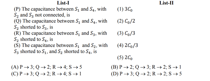

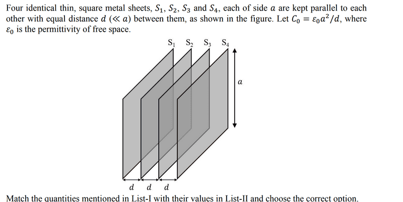

C=Q/V ## 1/C_{net} = 1/C_1 + 1/C_2 ##
Till now, all I have found out, is that for option P, it matches with ## C_0 /3 ##.
not able to understand, how to find the capacitance, if two plates are "shorted".
My attempt (to solve Q): I mentally connected ## S_2 to S_3 ## with a connecting wire, to ensure that the two plates are at the same potential.
would that make two capacitors?? Like ##S_1 + S_2 ##as a single capacitor, which is (probably) in series with ##S_3 +S_4##, which yields, ## C_{net} = C_0/2 ##
however,
1. I am unsure whether this logic is correct
2. How to apply the same, to solve R and S? not able to solve them.

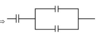

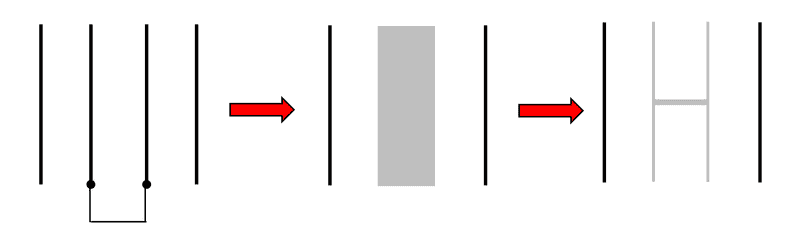

When ##S_2## is shorted with ##S_3##, the surfaces are at the same potential. This is the same situation as if a conducting plate of thickness ##d## were inserted halfway between ##S_4## and ##S_1## as shown in the attached schematic. Then you can remove part of the conducting material and match the conventional depiction of series capacitors.
(Edited to add schematic.)

For Q, you have @kuruman schematic - with, effectively (as you have described), 2 capacitors in series.

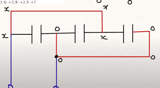

ok. here is my attempt for S
also I think it is valid to "break" S2 and S3 and connect them with a connecting wire, since they would be at the same potential and hence nothing would change (stored charge would be the same)
now, i marked the potentials as x and 0, wherever applicable(with positive terminal of battery connected to S1, and -ve terminal to s2, as the option S asks for the capacitance between S1 and S2.). not sure how to proceed, but hope I am right till now
OH wait, are these in parallel? it seems so. guess the answer is ##3C_0 ##
Very good !! You did it.

solved it, two came out to be parallel with the other one, so I got ## 2C_0 / 3##

I meant something like this
Please redraw your idea showing the battery connections with a "+" and a "-" and also the shorted plates. Besides, you are showing six plates when there are only four.
