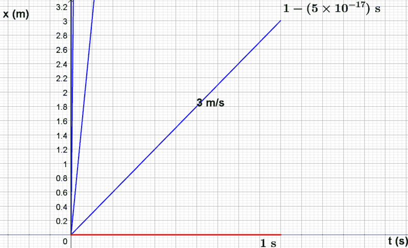

ffp said:
I don't understand what the heck it means to bend the line that is just used to count seconds.
First of all,
the line (more completely, the worldline) is
the position-vs-time graph of the particle moving in this frame of reference.
In PHY 101, that line is drawn the same way.
What's different in Special Relativity is that we are not making the
incorrect Galilean approximation that the elapsed time along all worldlines
is given by the vertical displacement on the graph (assuming time runs upwards),
which you can think of as the worldline of Big Ben ticking as a master clock for the universe.
Instead, the elapsed time is given by a measure along that line,
ticked off by the particle's wristwatch,
akin to the way it is in Euclidean geometry (where distance is marked off by an odometer).
This may help...
Taken from a figure from a chapter of mine about to appear in print,
with time running to the right (like the usual position-vs-time graph)
when the blue worldline (describing a particle with velocity 3 m/s in this frame)
meets the t="1 s" vertical line,
the elapsed time along the blue segment from the origin to that t="1 s"-line
is not 1s, but 1-(5\times10^{-17})\rm\ s,
which may be measured by high-precision wristwatches soon,
but which we (for practical purposes) treat as "1s".
The problem is that this approximation is terrible when the particle speed is comparable to the speed of light. Since most of our lives, we deal with low relative-speeds,
our "common sense" approximation is so ingrained that we have trouble letting go of the approximation.

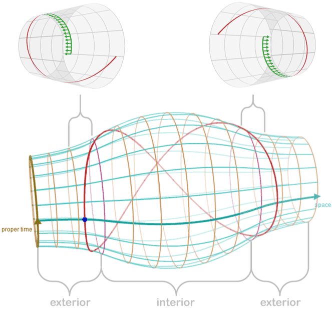

I don’t understand how there CAN’T be time curvature since clocks do not tick at the same rate relative to altitude. I mean, when you look straight down at a curved surface, the only reason you know it’s curved is because points of perspective appear further away from each other or closer to each other than they would be if the surface were flat. Likewise, if you compare ticks of a clock where time curves to a clock where time doesn’t curve, I imagine the time between ticks on the curved time clock will be greater the closer you get to the surface, while a “flat time” clock would have the same interval between ticks (relative to the clocks you compare with, which are at different altitudes). Drawing little dots (ticks) that get further and further away from each other on one end and closer and closer to each other intuitively feels to me like an exact analogue of one dimensional curvature. If I wanted to draw a 1D curvature, that is exactly how I’d draw it. Like this:
If you are running holding a leaking bottle, the drops will be further apart when you’re running fast, and closer when you’re running slow. Which means there’s an acceleration, and if you plot that on a time vs space graph, you’re plotting a curve. The analogy only goes so far, but the plot points resemble a curve to me.
That’s kind of what curved spatial surfaces do when you look down at them: the distance between points you’d use to gauge how far away something is different than if the surface were flat. Since clocks in a gravitational field do something analogous to what a curved surface does, I don’t see what is wrong with saying time is curved.
And as for the spacetime thing, in SR it is already clear that one man’s time is another man’s spacetime (much like one man’s electric field is another man’s combination of a magnetic field and electric field). Since even in flat spacetime you have the mixing of space and time depending on reference frame, the notion of curved spacetime — including curved time for reasons above — doesn’t seem problematic to me.

The problem lies with the term "curvature". It can mean different things. The cone surface in the video below has no intrinsic curvature (that's why we can roll it out flat without distortion). But it shows variable distances along the time dimension depending on altitude, which implies varying time dilation and gravity (apple falls down).
Of course if you draw the global picture, there will be intrinsic curvature (we cannot roll it out flat without distortion), because there is no way to connect the local cones without introducing it:
