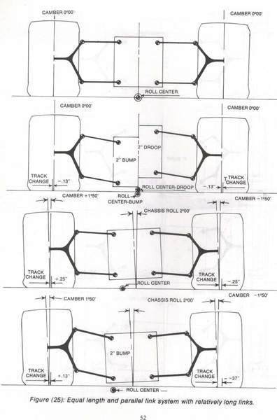

  • #472
welcome Animal
look at page 16 post 246..note location of the Roll Center..I would think on a left and right turn vehicle, you would want both to be as in line as possible. the height can vary but to me, the line up should be as centered as possible otherwise the load transfer would be biased...also make sure the differentail 3rd link is mounted as close to centered as possible..an old round track trick was to offset the 3rd link the same percentage as the perecnt left side weight...i.e. run 60 % lft side weight, and you have 60 inch rear track, mount 3rd link 60 x .60 = 36 inch to left of centerline or right rear tire..

  • #479

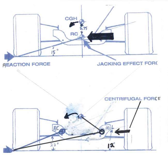

I will try to better explain the importance of Roll Center (RC) offset since I have had a lot of private messages about this.
Some of you are harping on my over zealous fixation on knowing where your Roll Center is on your race car. My answer is that if you do not know, you are only band-aid racers and the path to victory lane will be along hard road. Trying to make a car handle at the track and reacting all the time gets old. You have to be PRO Active.
There is no such thing as "Weight Transfer". The only way to put more weight on the right front tire is to place weight bars on that corner. Everyone uses weight transfer but what really happens is the car has Momentum and Inertia. Momentum is defined as the tendency of a body to remain in motion. In simple words, momentum is your force or speed of movement. Inertia is defined as the tendency of a body to oppose the change in its position. In simple language, inertia is what keeps you going. Both of these are lumped together time and time again. Think of momentum as a straight line force that resists change in direction. So this fictious "weight" is traveling in a straight line until the car hits the corner. This force is then countered by many things like ARB (sway bar) and the cars springs, tires, Track surface. So I will continue to wrongly use the term weight transfer for the remainer of this discussion.
Rule number 1 – In a turn we have to deal with weight transfer. We can not change this fact. We can only control and direct where it is going. This weight transfer consists of lateral weight transfer and body roll. If we cut down the amount of body roll we increase the amount of lateral transfer and vise versa. Both must add up to the same total regardless of proportions.
Rule number 2 – We need vertical load on the right front tire to properly turn the car. Top illustration shows stock car production chassis as it came off the production line. Pretty good compromise for grocery getter. RC is stock height centered and 2.75 inch from the Center of Gravity. Note that 50 % of the weight of the sprung weight will transfer through the RC. This transferred weight is in the form of lateral weight transfer ( large black Arrow) and body roll of CG thru the 2.75 inch lever.
Lateral Transfer – The large black arrow is pushing straight on the RC which in turn is pushing straight through to the tire contact patch and to the track at a 15 degree angle.
Body roll transfer – We also have weight transfer due to body roll acting thru a 2.75 inch lever which will slam this weight onto the right front tire increasing traction.If everything was left the same and we lowered the RC height but kept it centered, we would have a longer lever between the CG and RC. We would need stiffer springs to counter the roll. We also would have less than 15 degree angle from RC to tire contact patch and would lateral transfer would be less.
Bottom Illustration shows effect of RC offset 3 inch to the right of the car. Now 55 percent of the left side sprung mass is transferring through the RC. We have increased the distance between the CG and RC. So we have more weight being transferred through a longer lever to the right front tire.
We have increased the angle of transfer to the tire contact patch to 22 degrees. This means we are more effectively countering the lateral weight being transferred and we have less lateral weight being transferred and more roll weight transfer ( longer 4 inch lever). Don't forget, both must add up to the total sum of weight transferred. The right front corner will “ jack up” on corner entry.
If we offset the RC too much to the right we will be carrying the left front wheel through the turns ( old sprint cars ran on three wheels most of the time).
If we have the RC offset too far to the left we don’t have enough body roll to stick the right front tire. The angle between the RC and tire contact patch is 12 degrees which means we should have less lateral weight transfer than the stock set up but we do not. Only 40 to 45 % of the sprung weight will be passing through the RC. Not enough to stick the right front tire and we will be shredding the right front tire tread because too much weight is LATERALLY transferred. We we won’t have enough lift on the left front tire to hook up the right rear tire on corner exit. Car will push going in and be loose coming off.
Summary – We need to lower RC that is offset to the right side to kill off jacking effect and reduce camber build. This means a longer moment arm from RC to CG but we can use the body roll transfer to properly plant the right front tire. Too stiff spring rates, huge ARB and the use of bump stops turn the car into a giant Go Kart. Wrong move. You need some degree of body roll. As with everything in racing, it’s a compromise.

  • #480

This would permit air to get under the front end and defeat the aero down force which is what the BBSS ( big bar soft spring) set up is all about.
If we are running a traditional set up and not the BBSS set up we want a balance of placing the RC so it loads the right front tire without jacking the right front.
We want the RC as low as possible to kill of the jacking effect and minimize camber build yet...plant the right front using body roll without lifting the left rear tire.
On dirt tracks we want even more RC offset was we are dealing with a slick track 75 % of the time ( dirt track goes thru 4 phases from slurry slick to hard packed over the course of the night depending upon how the track owner maintains the racing condition). That’s why you see the super late model dirt cars really twisting the body. They set up for slick and when the track dries and gets hard the cars really hook up toward the end.
Pretty much a balancing act.
My point is that you should know where the RC is and understand what happens when weight is transferred in a turn. If you do this, your chances of making correct changes on the set up at the track are a lot better. If you get the RC close, then chance are you can bring in the balance with ARB (sway bar) tuning, J-bar, shock, stagger and wedge adjustments.
Personal rant coming on - Too many times we all have been in the pits and hear “ its pushing like a freight train”. The poor guy driving does not have a clue as to how to properly counter this condition and ends up chasing his tail all night. In fact I would bet that 50% of the grid does not have a clue about the RC thing, If you have ever been to a Saturday night race and it was quack quack...you know what I mean. No one can pass on the out side, everyone is in line like a parade of ducks..the pole sitter wins. One race team has settled on the “ hot set up” and everyone else has copied it because it “ works”. And it may be off a mile..but nobody cares and no crew chief wants to make a change from the “ hot set up”. Then when some one does set up the car with proper RC and really hooks up and runs the out side groove all night and wins.., he is immediately accused of cheating. Crazy...but I love it!
