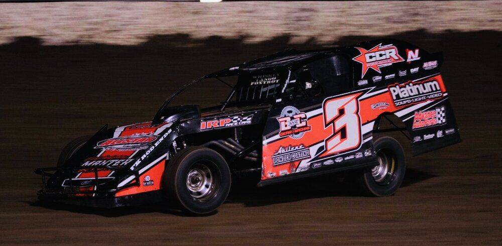

Shorttracker93 said:
Just by watching the cars running it at the Derby that won and have it figured out already it was essentially moving like a dirt car, the left rear tire was traveling into the fender well, the rear of the car was rising and the left ear tire was just being pounded into the pavement. We all know modifieds with 8" tires are an animal at the end of the race but mot anymore with this setup. same thing with the super Late models. I will add they are running the rear calipers on the bottom of the axle tube also. Yet again this is things I've seen on dirt but am not familiar with dirt as we've always ran pavement.
Several of the faster cars this year were "conventional" three link cars (DQ'd winner, and pole sitter for sure). Looking at them from a distance it appears they run a little more angle on the lower trailing arms, and the upper closer to the axle tube center than the classic recommendation. With a more "drag car" like IC, I'm perplexed as to how they soak up the off-throttle reaction. In the past when I've tried that it was automatic wheel hop. Perhaps the high spring rates and advances in shocks.
The other part of the puzzle is the new take on front...lot's of LF anti-jacking while the RF stays very similar to old-school.
If I'm not mistaken, this is representative of a fast car at the Derby this year.

Ranger Mike said:
Couple of quick observations. This Center pull suspension with J bar links combines the best of 4 link and 3 link suspensions. The 4 link is the best set up for dirt as you need maximum traction tuning. This center pull set up eliminates the lower links of the 3 and 4 link suspension. Less weight hanging below the axel and less garbage to get snagged up on a bad track. Everything is above the rear axel tube out of harms way.
Look at the Instant center angle. I do not have the hard numbers but it sure looks like the intersection of the two J bars and the pull bar is way out in front of the axle. Like 10 foot in front of the car! We want the angles of the rear suspension linkage to form an Instant Center (IC) as far forward as possible. This longer lever cushions the acceleration when the tires hook up. This set up does not have a shock damper on the top link. Too short an IC distance means we have a lot of angle change on both sides and the car will be real darty when you nail it. Longer is better and gives the driver more control because you don't have a lot of angle change as the shorter IC has. The top link angle can be zero to 5 degrees down hill for traction.See attached forces on rear axle -
It is easier to pull a chain than push it. Race cars love forces that directly pull versus forcers that push and this set up is strictly a PULL. All links are pulling on the chassis. We have more initial static angle on the driver side of 6 ° and the right side angle of 12 ° . This means the car in chassis roll will grow more angle in chassis ROLL as the right side angle reduces as the right side springs compress. This is a feature that 3 link has but to a much lesser degree due to the limitations of the lower links. About the only thing you could to bias the rear wheel loading was to off set the top link mount. With the J bar design you can dial in rear wheel load directly to each wheel.
This is HUGE!
Question for you to ponder- What happens when the rear end is in Roll? What happens to wheel base on left and right side?
RM, I've been watching this center-pull setup with keen interest since it first started winning (lots of aero on outlaw bodied cars). Firstly trying to figure out how to model it to understand if it's actually better in force management and location or just a shiny object (winners win, builders sell cars). On the modeling since it appears to give another element of freedom in the linkage. Also, one spring/shock assembly is mounted in front of the axle which helps on the off-throttle torques. So far, the best way can understand the IC effect is to model it like IRS, from the center of the axle tube and not from the tire patch. A second reason I lean toward that understanding is that the spring rates used in the competitive cars are very stiff. Another reason is that the actually-running setup I tried to model would up having the linkage intersection point looking like that of a Viper or modern Corvette, really high. Racers are using bumpstops in both rears with very high rates. Also, very low rear roll centers. Panhards under the driveshaft, 6"-7" RC height. So with the steep upward angles you get a lot of desired roll steer, but the bad potential for wheel hop checked by more freedom and dampening than traditional. I'm guessing, but my real question is how to appropriately model the forces.
As I noted to STT93, though, traditional 3 links are still running fast...but with a lot of angle in the links. No idea on the spring rates on those though. Those cars are on bumps on the front, so I'm educated-guessing 1500-2000+ lb/in front, 400-900 on the rear. Can super high tech shocks and high spring rates (less travel) make the difference on wheel hop issues with radical IC's??

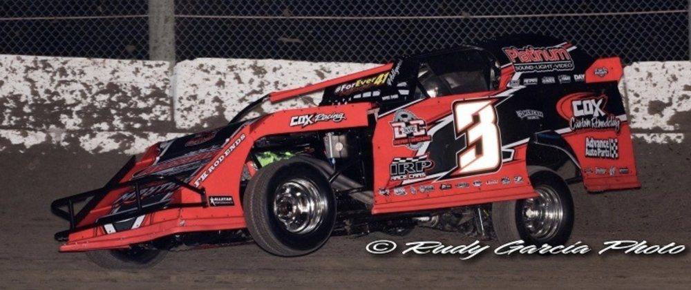

Rear steer YAW
A rear wheel drive solid axel race car with a 3 link suspension has the ability to move up and down. That is pretty obvious when you put a floor jack under the race car.
The whole axel housing can ROLL as in turn entry. The housing can Pitch ( like you pitch a softball) on acceleration. What is not so obvious is the rear end experiencing YAW.
Yaw is Roll Steer. It is roll over steer or roll understeer. This is caused by rear linkages set at different angles. If the driver side link angle is 6 ° up hill and the right side link is set at 12 ° up hill in static the rear end will yaw as the car rolls in the turn. When you are at speed and enter the turn, the left side wheel base length will shrink and the right side wheel base will grow. Watch the left rear wheel move toward the front of the rear wheel well on a dirt super late model entering a corner at speed. Dynamic roll lover steer.
See photo below on insane rear end roll steer.
3 Link rear end in action. Yaw is not so obvious as the link angles are set very close to each other.
4 link in action – note wheel base changes
This video reall shows the gimbal effect.
see post 1200 on page 48 for more roll steer detail.
Roll oversteer allows a race car to roll around a corner without breaking traction. When forward grip stops, the tire starts to slide toward the outside. Without rear roll oversteer the car has to break traction to turn. Now you are truly dirt tracking. When you have roll oversteer it steers the rear end to maintain grip and you do not break traction. This concept has been out there for years but did not get popular on paved tracks until recently. Now you will start to see the left side wheel moving to the front more vs. the old set up. Now you know what too look for. Driver side rear wheel well.

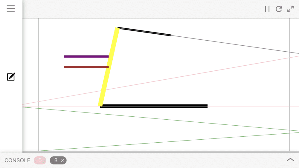

Spindle height is distance from upper ball joint to the center line of the spindle pin. The only bearing the tire diameter has is where it places the ball joint centers relative to the pavement. This is why you just about have to have a good software program to follow things like tire diameter and its effect on the spindel height , effects on suspension link angles that make instant centers that make Roll Centers.
  • #1,509
Makes sense Ranger Mike. We're using spacers on the top and bottom of the spindle to move the upper and lower ball joints to get the desired Y coordinates for roll center.
But got to thinking about what would be the optimal spindle height. The attached image shows the brown line is center of upper and lower balljoints and the purple is where you end up with spacers to get all points and match spindle snout to tire.
The brown and purple lines are going to move along the travel arc at differently, so to your point, you need to understand the dynamic affects of this stuff.
Is Performance Trends Suspension Analyzer still the recommended software these days?
BTW, thanks for sharing all your knowledge.
  • #1,510
Thanks fro the input Cave
i like Perf Trends but there are many other softwares out there. I like sys Analyzer as it has dynamic graphics ti display where things are moving during roll and dive. price is good too...

While I was mapping out the rear suspension of my dirt late model I was thinking about instant centers. On the dirt cars we do have birdcages on both sides of the rear axle which is where my question lies. In order to calculate the instant centers of the rear end you have to use the lower bars for sure. Although, I'm not sure if you would use any other links to capture the instant centers. Both sides upper bars are angled in the positive direction so you would get no convergence other than aft axle. The lift arm is level at static so that wouldn't be the correct option either. The one given i have is that obviously we do have a positive anti-squat value on the left rear given that it hikes as soon as throttle is applied. Would you suggest just using the just lower bar to map out instant center? I've consulted all of the textbooks I have and have not found much in the way of instant center calculation for this scenario. I'm interested in the theory as it seems to help me conceptualize my direction, execution and optimization.
Also, do you have any reference that would help me understand the math of the instant center? I see a lot of articles referencing 100% but I'm not understanding what the base value and calculated value is that would yield your specific percentage.
I've done a ton of work mapping and optimizing lift bar (torque arm) application and optimization. This is the next piece to the puzzle.

Wylde said:
Hey RM,
Every time I have a question I always revisit this forum (have intermittently frequented since 2014). I know you are a big proponent for the performance trends software and that is my next investment. While I'm budgeting the cash for this I do have a question.
Keep in mind that on a dirt late model you have a live axle decoupled suspension, so the typical anti-squat calculations you would normally find in textbooks for 3-link suspensions etc. do not apply. You basically have four sources of anti-squat in a typical dirt late model utilizing a 4-link rear suspension.
The forces generated by the 5th arm lift bar, the forces generated by the left set of four bar links, the forces generated by the right set of four bar links, and the forces generated by the j-bar. The 5th arm forces are a direct response from axle wrap, so that reaction force is pretty straight forward. You then have to determine the instant centers for both the j-bar system of links and the left and right four bar systems of links.
The anti-squat from the j-bar system is generated by taking a moment about that systems IC from the lateral forces at each of the rear tires. The left and right four bar links are determined by taking a moment about their ICs as well. The force you use is the force that is generated at the axle tube by the rotating tire. This approach is only valid because the 4-bar links systems (via the rotating birdcages) are decoupled from the axle tube.
Keep in mind that these calculations on their own are pretty useless other than for conceptual purposes. They should be used in a large set of equations that define the vehicle as a whole, where the anti-squat forces are but a small part of the overall picture. As for your question about how to determine the 4-bar link instant centers. You would have to project the links onto a two dimensional plane (i.e. a sideview) and find the intersection of the projected lines from the top and bottom 4 link bar. It will be below the ground plane and behind the tire CP on the left rear for example.

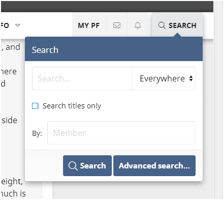

One tip for @UFO -- You can use the SEARCH feature in the upper right corner to search just this thread for keywords or phrases. Just pull down the "Everywhere" default for where to search, and change it to "This thread". :smile:
  • #1,547
Thanks for the tip Berkeman. That is a cool tool to get around on this forum.
