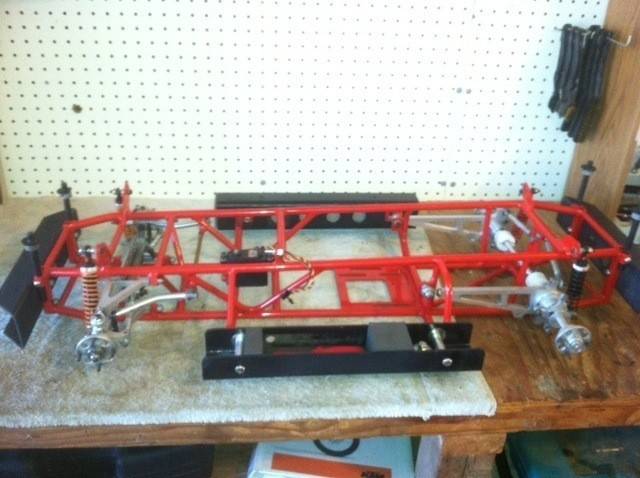

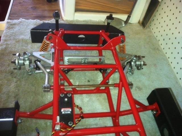

Hey mike!
Finishing up my race car build, found a friend with chassis software, now wondering where to measure my upper control arm pivot points so i can determine roll center. The upper control arms on my car are angled so at what point do I pick to plug into my software? Dead center?

welcome and sounds like a good plan. On all the chassis software i use, i have to measure the height and location from center line of the top outer pivot point and top inner pivot point and the software calculates the angle. The better and more accurate you measure, the better. I had to make stop blocks to jam under the lower A-arm to maintain exact height and slipped off the front tires on occasion when running wide tires and big wheel offsets masking the outer pivot point. Eventaully I borrowed a portable cmm arm.

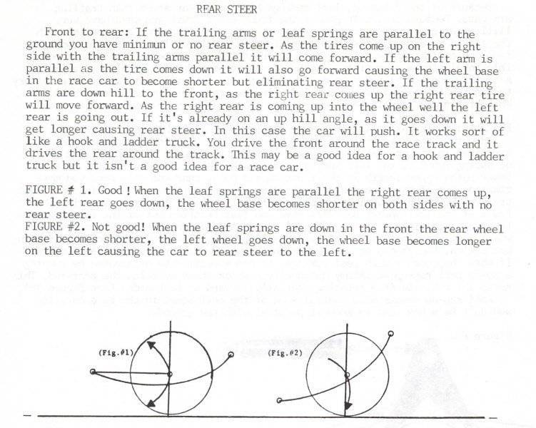

Ride height – distance of track surface plane to four reference points of the bottom of the race car chassis. This Ride Height will allow the race car to go faster than any other height setting for a particular track. Typical ride height has 3 criteria.
1. Chassis clearance –You need enough clearance to accommodate suspension travel ( 3 inch for stock car classes paved, 4 inch for dirt) yet keep the car as low as possible without bottoming the suspension components.
2. Front camber build. As the body rolls we build camber. For every 1 inch body roll we build 1 to 1 1/2 degree camber because the bottom A-arm is longer than the top A-arm. Set the ride height and check camber build over 3 inch travel ( paved). If the camber build is over 1 1/2 degree per inch the car is too low. If the change is less than 1 degree the car is too high and I do not believe this rule of thumb. More on this later.
3. Rear Steer- We want minimum to zero rear steer at desired ride height UNLESS WE INTENTIONAL DIAL IT IN. We want rear trail arms as level to the pavement as possible. Leaf springs will most likely be slightly down hill to counter anti squat.
