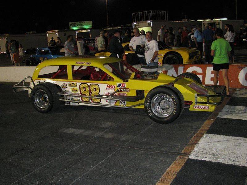

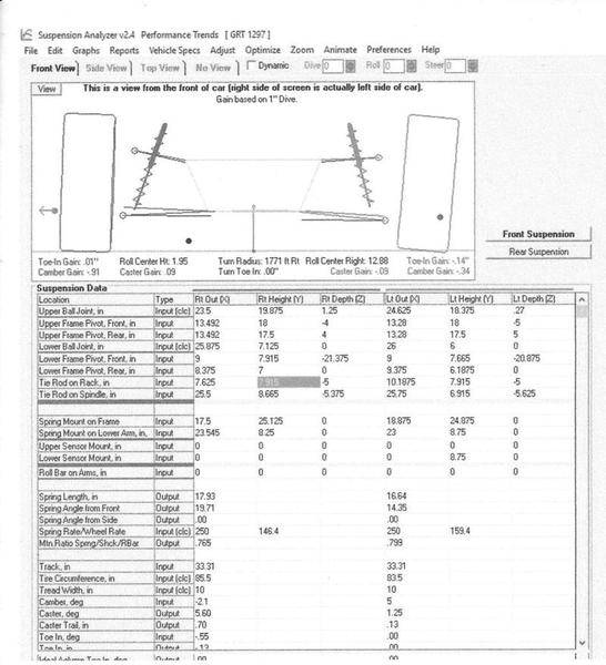

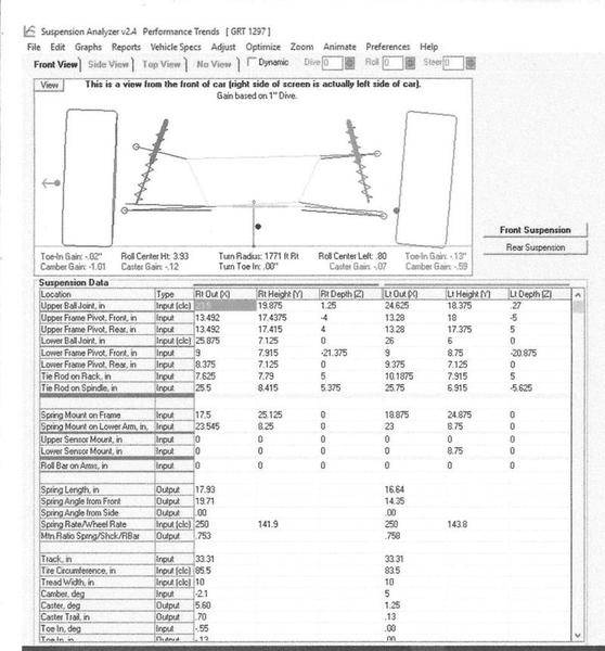

I am trying to correct a Mod-Lite dirt car, 1300 lb-14,000 rpm-1/4 to 3/8 mile dirt tracks. Looking for some ballpark numbers on where the roll center should be located, any help greatly appreciated.

Here is some numbers.

That is one light narrow car! Geometry looks pretty good. Roll center height is a little high in my opinion. Where is the rear RC?
what is % ft to rear and lft side weight?
I have never worked on a car like yours so all i can do is speculate what works on metric E-mods and the like on dirt.
In an ideal world 3.5 to 4 inch high front RC would be good and having it located 4 inch offset to the right side would provide more down force to load the rt ft tire.
Glad you got a good software program to analyze the camber build. You are well on the way to a checker.
  • #726
Thanks Ranger Mike it is basically a dirt Legend car, 74" wheelbase, a lot less restrictive rules class too. 57.8% rear 52.4 left and 52.8 cross, and a 1/2 wider wheel base on the right. Still confused on roll center moved to the left or right, the car seems to set and fall back down and tends to make my son feel like he needs to drive the turn harder to keep it set up.

I think there is too much difference front to back on the roll center, and I am leveling out the lower control arms which is dropping it even more, and I want to raise the inner upper arm points too which should drop the RC even more to around 3".

Bigbolt, please post the following info.
Left front spring, tire pressure you run, caster, camber and ride height. same on RT Ft.
on the rear I need ride height, spring rate and tire pressure, stagger unless you run open Toyota rear end.
I need toe out on the front. Whats is the wheel base on the left side and right side. Are your rule open on tires or do you run spec tires?Are you running camber cut tires?
are you using 3 link or 4 link rear set up?
Have you squared the rear end lately?
  • #732
Springs-LF 180, RF 180 (trying 200 this week0, LR 160 (trying 180 this week) RR 140 (trying 160 this week)
Air 6# Left 8# right
Caster L 4, R 6
Camber L -3.6, R 2.25
Ride Height Front 5" Rear 5.5"
Stagger in the rear is around 1.5" ( recently switched from 3"-big improvement)
Wheel base Left 73.5 Right 74 ( recently went to this from squared up, seemed to help but not sure if it was just a crutch, was having trouble keeping car down and this did help it from drifting up the track.
Toe out 3/16"
Tires Spec 40 duro American Racers, Hoosiers are too stiff. And the are grooved but not camber cut.
3 link as per rules with a 24" right bar and 19" left bar,
Panhard bar to the center, left side to the frame ( pondering switching to a J bar to move roll center over to the right)
  • #733
all springs are on soft side.
car is about an inch too high on ride height.
springs -
try 185 LF ft., 200 RF., 165 LR , 145 RR
You are real close on LF and LR so do not change these
One legend racer here runs LF 185, RF 200, LR 165, RR 145
another runs LF 200, RF 225, LR 165, RR 145 so I am pretty confident on the above recommendations..
use pyrometer to get best tire pressure
no reason to go to J-bar yet. Is side bite a problem? Can not address side bite coming of the turn until we manage to enter the turn properly..
lower the rear roll center to help side bite, add down angle to increase it.
I would square up the rear end as you have introduced rear roll over steer.
go to at least 1/4 inch toe out. up to 3/4 inch toe out on 1/5 dirt track
on front roll center I am firm believer in offset roll center to plant the right front tire.
If possible try to get at least 3 inch offset to the right, 4 is better and you need this on dirt.
  • #734
Offset the front roll center towards the RF tire? And am I thinking correctly that the heavier sprung corner will get the most traction? Another piece of info, the front running cars, well most of them, run the LR coil over in front, and the RR behind the axle, that is how we are, not sure on the dirt Legends.
  • #735
It is also getting over on the right rear very hard, body clear down to the tire. Rear tire temps have been close together and the RF less than half the rears, and the LF is stone cold cause we usually are carrying it off the turn, I have to do some surgery up there to get it to lay down because it limits out on the Mono ball joints.
