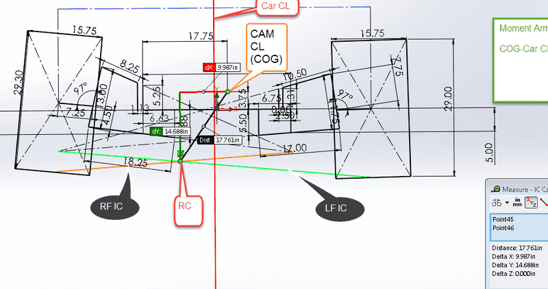

I have access to RC software so I when back an played around with some numbers based on the existing adjustments available on the car. The attached picture is what I came up with. I think it might be more in line with your recommendations. I use stock Mustang II spindles with tubular upper and lower controls arms. It also has a mustang R&P.
I did run it through 1.75 inches of dive and 1.5 degrees of roll and the Rc moved to .9 high and 4.5 to the right.
As for the tracks we run, I race in a touring series so it is anywhere from a small medium banked 1/4 mile to 5/8 high bank with long straights. There are also a couple of 1/3 mile sweeping turn tracks.
Let me know what you think.
-DR

Sounds like you have a pretty good start to a wining season. The software you have is great. You can dial in the front RC with it. You can always swap in a Chevelle spindle that is an inch taller if you have to, Ford pinto spindle may be same as you are running, not sure.
One thing to note- you have a whole range of different tracks from flat sweeping to serious high bank. I would put major effort into charting the correct camber curve for each track. Then set up car for each event with correct camber shim package. A completely flat rack would need negative 1.75 degree camber per inch camber build on the right front and positive camber on the left front 0.5 to 3/4 degree per inch gain . A 10 degree banked track needs neg. 1.5 degree per inch rt. side and left front 0.5 to 3/4 degree pos. camber per inch gain. A high bank track would take 1 to 1.25 degree per inch of bump rt. side and left front 3/4 to 1 degree per inch gain pos. But..use the pyrometer to dial these in. These are ball park settings. I am sure you know the correct springs for 1/2 mile and longer fast tracks. The time you spend in that cold garage this winter, mapping the camber build for each track will pay off big time. Serious race teams do this. Weekend warriors just swap in the bigger springs and change stagger and go race the high banks ( never taking the time to change the camber build). So their contact patch is off pretty much of the time. You will have the advantage of maximum contact patch matched to the track or darn close too it.
One final note- I would concentrate on smoothing things out aero wise on the tracks over 1/3 mile. Granted you can’t do anything about those ugly tires but you can get benefit with small changes to smooth out flow. I have spent days in the garage taping tuffs of yarn on the car and looking at the air flow. That hog barn fan really flows the air but its cooolllddd.

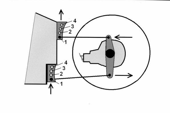

This "active rear suspension" does not have any actuators/hydraulics or anything like that.
Feel free to correct me but this is how i see it:
The way port city has done it will allow the rear end to twist more under accel, which does a couple of things. First, it will shorten the wheelbase of the car under acceleration.
It will do that because the trailing arms are positioned poorly to react to the torque component of the rear end for this style. the trailing arm pivot(s) will move up as the car undergoes accel, until the forces balance out - not sure how long that will take but i would guess that the transient application of force to the rear tire patches would last longer than in a conventional 3-link. Depending on the tire and where you are at in terms of overloading it, this may help bite off the corner.
The fact that the wheelbase shortens also means that more FORCE is being transferred to the rear tire patches. just like a narrower track width causes more loading on the outside tires in a turn, shorter wheelbase will cause higher load on the rear tires under accel. There may be all kinds of other things affected by this "active" suspension but the transient part of the load applied to the rear tires as well as a dynamic change in wheelbase are the two that stand out to me the most.
  • #818
Sounds like induced rear under steer or rear over steer depending on what side you want shorten. Without seeing it in person, sounds like it is doing the same thing as the spring loaded radius arm without the liability of the spring breaking. This is good. I used a spring loaded radius arm old late model and liked the fact that the spring could be tuned as track required. The 3rd link that is a torque link also can be adjusted. Are these gimmicks or genuine engineered better solutions? What ever floats your boat. I personally like a 3 Link with top torque link and i like adjusting the angles of the trail arms and 3rd Link and damper to tune it in. IF you have enough room to adjust it.
Anyway, thanks for taking the time to point out emerging technology. I am on way to Florida so will be out for a while.

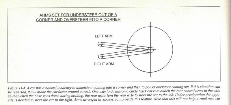

I recommend measuring bump steer and rear steer at ride height. With the race car topped off with fuel, sand bags or substitute weight in the drivers seat for the driver, all tires at race setting tire pressure wise, measure the length from the floor to center of wheel hub on all four wheels. This is your ride height wheel center setting. Next you have to remove the springs, set the chassis so that the wheel hubs meet the ride height spec. go thru the bump steer process on the front. You should have pretty good idea of the process on the front by now. You need to correct any bump steer caused by the steering linkage.
On the rear we need to find out what is happening to the wheel base length during cornering. You need to attach the dumb end of a tape measure to the front hub so wheel base may be measured at the rear hub. On the right rear at ride height measure the wheel base. See what happens when the right rear goes in bump one inch ,2 inch , three inches of bump. On left rear go through the same process but measure droop at one inch, 2 , 3 inch etc.. 4 inch if you think you have this.
This will tell you if you have induced rear steer ( either under steer or over steer). I personally do not like to run either and want it as neutral as possible but your being limited to what GM did in 1986 on the Monte Carlo..it is what it is.
While it is winter, pull out the rear end and check to make sure it is not BENT. Another thing is to make heavy duty brackets that will measure shock travel on the left side. The rubber grommets are ok for bump travel but you need to know droop travel as well. Ideally you want the left side drooping 3 inch and right side 3 inch bump..Ifin everything else is working like it should.

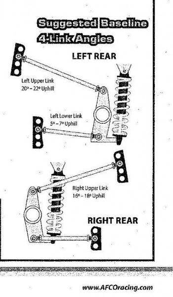

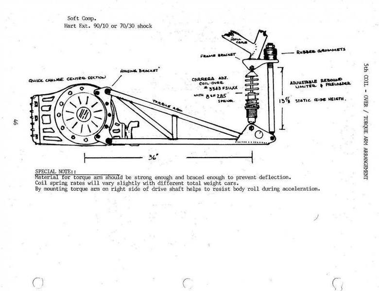

Ranger Mike need some help. We bought a car last year it's a street stock 75 Chevelle cut down to 108" we had a buddy check front and rear RC. Here is what we came up with front RC went from 1" right static and 7" left dynamic. And rear was 20" and 21 " in travel. The rear package tray has been raised 2" and the car runs at 5" ride height. What can we do to get the rear RC down. Thanks
  • #830
Welcome Jared, always nice to see new talent arriving in the new year. I recommend you spend the $$ and buy Street Stock Chassis Technology by Steve Smith. It is the one thing you can do to develop a plan to win. The rear roll centers are what they are as rules will not permit any changes in t he mounting of the trailing arms.
Look at the attached photo. You could change the top angle of the trail arms to lower the intersection point at risk of tech inspection catching you...yeah right...You can do major handling improvement by correcting the front roll centers. This book also tells about different spindle heights and ball joints. You need to get the front RC to the right side by 3 inch and stay there. This will load the rt ft tire enough to make the car turn in without pushing.
Buy the software for chassis analysis as mentioned and benchmark the car. Then you can have some advantage with those hard tires you have to run.
Its a lot of work but its what it takes to win...

We can move the points in the rear. We won many raves with this car but it's always been on the lose side and not much side and forward bite because the RC is so high on the back. I've been trying to find am article where it can tell me what happens when you move your points up or down which way the RC goes.
  • #832

1 1/4 degree total by 3rd inch of droop. LF gains positive camber.
You are referring to roll center migration as phase one? I will need to research that more to get in my head what I need to do.
Phase 2 ackerman?
I see that you prefer minimum bump, and toe with required amount of ackerman. By my calculations, 1/16" toe out doesn't do much for ackerman, and please correct me if I am wrong, to induce just 3 degees of ackerman, you would need, @ 20 3/4" diameter, 9/16" of bump steer, (or combinatin of bump, droop, and toe) so I get that Is it safe to bend the spindle arms, if so can you give me advice, are they cast iron or cast steel?

I am not concerned about rear steer simply because you have a good grasp of it and can change it as you require. We can not change the rear RC much if any so the next best is to use ballast or rear steer in phase three. I do not like static toe over 1/8 inch because it cuts down the straightaway speed. Thats why i like ackermann.
I do not have street stock specs on 1/2 mile track so let me ask a few racers.
mean time find out what the front RC is doing in dive and roll please. Its just snowed hugely here and getting into the race car hauler for my notes aint going to happen soon..
