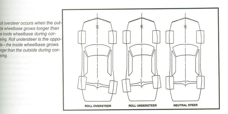

  • #116
now we are getting some where
have you measured the rear track under compression/rebound?
I am trying to determine if there is rear roll steer in play?
is the wheel base on one side growing or shrinking when in bump?
what is angle of third link? what is angles of both trail arms?
i am not too worried about panhard bar mount as much as angle

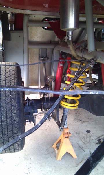

  • #117
Attached is one of my sons pictures to give you a better idea of what the heck we are talking about here.
The rear suspension on these cars would technically be considered a two link with panhard. The torque arm consists of two plates bolted to the quick change using the side bell through bolts either side of the drive-shaft. The plates go forward about 28 inches and attach to a large heim which attached to a slider plate mounted on two shafts attached to the chassis. The heim is mounted to the plate with a rubber biscuit to cushion rear end wrap up on throttle.
The two lower links are mounted on clamp on brackets at the outer end of the axle tubes below axle centerline. The forward end of the lower links have three mounting holes on the chassis to adjust link angle and therefore anti-squat, which also effects the amount of roll steer. This is kind of hard to picture if you have never seen the design, but it follows all the principles of a torque arm two link with panhard. When I say torque arm do not automatically envision a typical late model torque arm with fifth coil. These cars are laid out like an over grown sprint car with the driver centrally located with the driveline and torque arm between his legs and under the seat.
This rear linkage design has inherent roll oversteer in all lower link mounting positions. This is crutched (in my opinion) by using a spring rod for the right rear link to induce power on axle steer to the left to counter the roll induced oversteer.
The panhard angle is cockpit adjustable for angle, which to me just adds or subtracts a jacking force more than moving the roll center height. If I want to move the roll center I move the bar up or down equally at both ends while maintaining the angle.
Hope this all makes some sense.
Thanks, Ralph

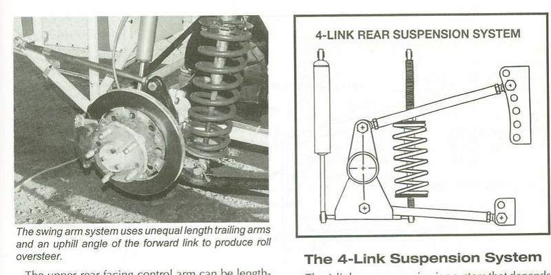

  • #132
4 link rear suspension is designed to use dynamic roll oversteer to turn the car. see post 116 above . Usually the 4 link has 2 forward facing radius rods on each side running from the "birdcage" on the axle housing to mount points on the chassis. The Panhard bad is used to keep it all in place . Usually the spring s are mounted on sliders IN front of the rear end and shocks are mounted on the rear side of the rear end. the big points of the 4 link are that it creates huge forward bite because the top link angles are running up hill. any time a link going forward is mounted on the frame higher than the mount point of the axle, the rear end will try to go up under the car during acceleration and this really loads the tires as the car is being pushed forward. Newton again..the upward angled arms are reacting against the weight of the chassis thus providing more tire load..its called axle thrust.there is usually a torque link added to cushion acceleration. Typical set up numbers are top left arm angle 13 degrees , length 17 inch minimum.. top rt. 17 degrees, bottom radius arms are both 2 inch shorter and both running down hill at 5 degrees. running equal length lower arms would create too much roll over steer.
l
As the car enters a left hand turn, the body rolls and the right upper link levels out. this lengthens the right side wheel base by 1/8 inch. the left top arm gains a lot more angle and the left side wheel base shortens by 7/16 inch and we have roll oversteer.
Regarding you set up..do you a have a bird cage? is the left rear spring on the birdcage or on separate clamp on bracket?
  • #133
My car is a setup to the manufacturers specs with the left rear consisting of a shock in front of the axle on the birdcage & a spring on a slider/coilover behind the axle on the same birdcage. The right rear has the shock and spring together on the front of the birdcage. When the car enters the turn the left side bars increase like you said in your post and the bar angles increase. Where would be the point to which forward traction is overtaken by loose roll steer?
I run a 16 in top bar on both sides and a 12.5 in bottom bar on both sides. These are the manufacturers settings for this year of car. Normally throughout the race night I will shorten the right side bars 1/4 inch. How far can I shorten these bars in the slick and benefit before I begin to hurt my setup?
  • #134

The chain is part of the chassis builders recommendations. Without the chain the left rear would continue to drop to the point of the shock topping out. We have ran without a chain before and pulled the shaft out of the shock body.
both of our cars are GRT chassis and run the same setup. Chevelle front end with 600 lb springs on both sides as suggested by GRT. we run a stock lower a-arm with a tubular uppers that have been moved from the orignal stock location by GRT. they are adjustable for caster & camber.
I think the general idea of the LR chain is to allow the left rear bars to gain angle and rear steer but stop it from going to far. I was told once before to think of the chassis as a seesaw. If the right front goes down then the left rear comes up and opposite. So i would think instead of going to a lower right front spring we would want a heavier spring to add weight to the left rear?
  • #140
Then you either need a shock with more travel or you need to limit the travel via spring rate changes. Using a chain won't cure the problem, just keeps the shock in one piece.
As soon as any part of the suspension binds or locks or hits the end of a stop, the spring rate on the wheel effectively goes sky-high and that tire loses traction. If it is a solid axle like yours, it also changes the spring rate on the other wheel the same way, again causing a loss of traction.
By using a chain or a short shock on the left rear, you're making the right rear act like it has a soft spring when that car is flat and a hard spring when it hits the stop as it roll. This can change the handling rather abruptly with only a small change in roll angle and make the car a handful.
Get the chassis movement/roll under control like Mike is suggesting.

I wish I could attach a photo of the suspension on here for you to see.
The shock on the left rear does not currently top out. When the left rear drops it will continue to drop until something binds, whether that be the shock or the driveline(driveshaft into transmission). The chain is mounted from the top frame rail to the top of the axle tubing. When the rearend drops to 18 inches below the top frame rail the chain grabs.
I agree that this going solid effect would mess with wheel weights. What some people have done is make a rubber bushing limiter that when the chain is about to go tight it begin pulling on the rubber bushing. I guess this is sort of a cushion.
Again I understand the logic behind removing the chain but we have done this before and have ruined several shocks & bent drive shafts.
You talk about limiting travel with spring rate changes...how would I do that? Heavier RR springs?

Here is an example of the chain and suspension I am talking about. This is not my car but one very similar. The chain is red and you can see it between the spring and front shock.
