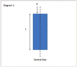

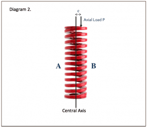

Now the real inside baseball stuff begins to make sense. ALL Coil springs will have side loading.
From http://www.pawangroup.co.in/archives/10531
Definition of Eccentric Load: When the load applied to a portion of the column (spring) is not symmetric with the central axis of the column (spring), the load applied is called eccentric load
see spring 1 pic belowExplanation: In above figure (Diagram 1) P is applied load, L is length of the object under load. Here load P is not symmetric with the central axis of the object.
Effect of Eccentric Load on Spring: Spring is an elastic body which when subjected under any type of load starts to deform. If the applied load is in allowable physical tolerances the spring gets back to the initial position due to its elasticity.
It is very important that the applied load is not just in the given physical tolerances but, is also applied properly. If a spring is applied be load P of which the axis is not symmetric with the central axis there is a chance of spring buckling, which can lead to spring breakage.
see spring # 2 pic belowWhen eccentric load acts on the spring the stresses on spring coil increases and load parameter also varies. Due to eccentric loading the stresses on the farthest side (ref. Diagram 2) increases i.e. side A. The stresses on the nearest side of eccentric load decreases due to extra compression. The effect of eccentricity on spring varies considerably with the shape of end coil and also the number of coils in the spring. Stress increase due to eccentric loading varies directly with the distance between central axis and load axis (e).
In plain hillbilly tech – when you compress any coil spring you will have side loading. This side force loading is caused by the springs ends not being able to distribute the compression forces equally to the spring perches. This is magnified if you got the spring ending in a non parallel ground seat. You have at best about one half a coil displacing the load. For the typical grocery getter you would never care about spring eccentric loading.
see coil spring # 3 pic belowParallel ground coil springs used on coil overs are a lot better but inherent characteristic of a coil spring when mounted co-axially around the damper of a vehicle with fixed position spring perches is that it will generate a lateral load due to its not being able to distribute load forces evenly around the face of its end coils. This lateral loading manifests itself as a bending load in such coil over applications, and results in greatly increased frictional forces within the damper. The answer is the hydraulic device supplied by Hyperco. Their ultra high quality spring rate and load test scale, which charts axial load as well as longitudinal load found with some configurations, 98% of the lateral forces were eliminated. You can run softer spring set up since a portion of the old spring rate was going to side loading and not compression. You get better shock life and better tire grip than the other guy running coil overs. You add ½ pound to sprung rate with these coil perches.

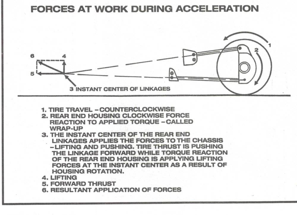

Please bear with me as i try to explain my question reverse rotation of the drive shaft and using reverse rotation crown wheel and pinion to correct it so the car drives forward normally.
Now this is a purpose built race car to run a dirt oval with double A arm suspension and 3 link rear coil over suspension and i have researched this and read about Smokey reverse torque special https://macsmotorcitygarage.com/another-look-at-smokey-yunicks-reverse-torque-special/
What are your thoughts on the rear diff torque loading the right rear and unloading the left rear can this be over come by moving the 3rd link further to the left to load the left tire?
Have i just lifted the lid on the can of worms?

i love smokey yunick! he was the best! I am all for the rev rotation. Yes 3rd link offset can assist. I would have gone rev rotation if it were not so expensive. doomed by production design from get go i guess. i am for anything that adds down force to the lazy left side tires.

Thanks for the quick reply Ranger Mike could you please give a quick list of the advantages
  • #1,480
Engine - driveline torque produces an equal and opposite reaction upon the chassis, lifting the left side of the body, pushing down on the right side, and redistributing the load to the outside of the corner in a left-hand turn. This is exactly what we want thru body roll. So if we reduce the body roll and can put the same amount of down force on the right front tire, we can keep the nose down and seal up the aero just like the big bar soft spring set up. But on the rear end, Torque reaction lifts the right end of the rear live axle and pushes down on the left, with the axle housing forming a sort of lever. On a typical car developing oh, 300 lb-ft of crankshaft torque, there might be 75-120 lbs. of force loading one end of the axle and unloading the other. For oval racing at least, this redistribution is in a nominally helpful direction—from the outside to the inside tire. And note that reversing the engine’s rotation does not cancel the reaction forces in any event. It simply reverses them. And in the case of the forces acting on the axle housing, it’s in the wrong direction for oval racing. So reverse rotation is a help to the front but bad for the rear end set up. Drivers who have raced the rev rotation set up also state it works great but you had to stay on the gas pedal in the turns or it wants to make right turns if you lift.
Engine specific changes are - is the fact that the coolant flow is reversed. The engine doesn't cool as efficiently with flow entering the top and exiting the bottom.
Some engines have the cranks knurled for that rotation only. Running them backwards they will leak oil at the front & rear seals. The wrist pin was slightly offset in the piston ( they do that to make sure there is no piston slap...), so you had to turn the pistons 180 deg in the bores.The engine needs a different cam, and the little driveshaft that goes between the oil pump and the distributor. ( the gear on it meshed with a gear on the cam ). Water pump & alt or generator need reverse rotation models from marine application that ran the right way ( alt might work either way, but the cooling fins next to the pulley will be pointed the wrong way.) Need starter that runs backwards too. Clutch and transmission should be ok but pinion gear has to go on right side in differential.
I don’t think it is worth the hassle and I look at track side repairs. You cannot win ifin you don’t finish and you are super screwed at the track when you have many special order items. You are at the track and suddenly a starter, water pump goes out on you. Reverse flow – neat trick but not worth it.

Ok what would be the suspension advantage of it?

  • #1,499
Couple of quick observations. This Center pull suspension with J bar links combines the best of 4 link and 3 link suspensions. The 4 link is the best set up for dirt as you need maximum traction tuning. This center pull set up eliminates the lower links of the 3 and 4 link suspension. Less weight hanging below the axel and less garbage to get snagged up on a bad track. Everything is above the rear axel tube out of harms way.
Look at the Instant center angle. I do not have the hard numbers but it sure looks like the intersection of the two J bars and the pull bar is way out in front of the axle. Like 10 foot in front of the car! We want the angles of the rear suspension linkage to form an Instant Center (IC) as far forward as possible. This longer lever cushions the acceleration when the tires hook up. This set up does not have a shock damper on the top link. Too short an IC distance means we have a lot of angle change on both sides and the car will be real darty when you nail it. Longer is better and gives the driver more control because you don't have a lot of angle change as the shorter IC has. The top link angle can be zero to 5 degrees down hill for traction.See attached forces on rear axle -
It is easier to pull a chain than push it. Race cars love forces that directly pull versus forcers that push and this set up is strictly a PULL. All links are pulling on the chassis. We have more initial static angle on the driver side of 6 ° and the right side angle of 12 ° . This means the car in chassis roll will grow more angle in chassis ROLL as the right side angle reduces as the right side springs compress. This is a feature that 3 link has but to a much lesser degree due to the limitations of the lower links. About the only thing you could to bias the rear wheel loading was to off set the top link mount. With the J bar design you can dial in rear wheel load directly to each wheel.
This is HUGE!
Question for you to ponder- What happens when the rear end is in Roll? What happens to wheel base on left and right side?
