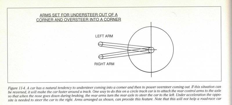

I do have one more question for you Ranger Mike: Looking at a Supermodified with solid axles front and rear
" Whats the difference between adding rear steer to a race car (vs) Front Axel Lead?"
It seems to me that regardless if you push the RR back (or) Push the RF forward you are achieving the same results - Right? So what am I missing?

Big difference.
Some Racers lead the RF while others trail the RR. Usually the amount is between 3/8" and 1/2".
Let’s look at the front end and leave the trail arm lead to later.
The advantage to leading the RF is that it will create more of a "caster stagger effect" without having to run as much actual caster stagger.
Typically on a manual steer car you run 1° left side caster and 3° right side (power steering ups this to 1° left side caster and 4° right side.
Putting lead in means you won't have to run as much caster in the RF, and that means you won't have as much LR weight jacking when wheel is counter-steered.
See post 319 page 16
For caster. You see the caster split or stagger is not to steer into the corner easier, it's to assist you when you exit the turn with your counter steer.
I am a big fan of square cars. Everything parallel and square. I like this set up as it is a lot easier to replicate after a crash. Adding lead in means fabrication and extra work.Look at rear roll steer on post 81 page 5, post 116 page 8, post 858 page 43 and post 1200 page 60. Real roll steer is great for dirt cars and can help on paved track cars.Trailing the RR means more static rear steer and means more dynamic roll steer. Now for certain very restricted car classes, let us suppose you were to move the LF geometry back 2 inches. To avoid the wheel base check you would have to make sure you could crank in 2 inch to the left rear trail arm before tech inspection. Let us suppose the rules said no engine set back as measured at the spark plug. Let us assume some sneaky crew chief made access to the right side spark plug a very easy measurement to the top ball joint. The left side required some gymnastics to get a good measurement due to alternator, power steering and oil cooler placement.
Some low life cheating sob could set the whole engine back 2 inch and the car would have more rear weight bias and had a 2 inch shorter left side wheel base. Car would turn left like a bandit and had 52% rear weight bias when everyone else had 49 to 50%. But this would be considered “cheating” in some corners of the {all things are equal} universe.

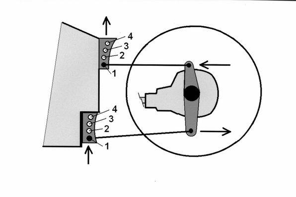

Josh ,
Good catch on evolving technology. There are a few definite advantages for this J-Bar rear mount linkage on the asphalt rear suspension. I think 1962 Citroen 2cv pioneered this rear suspension with the rear mount concept to the point of actually mass producing it successfully. Note attached diagram for the Paved Track Stock Car Technology by Steve Smith. Every racer should have a copy of this.
  1. It is easier to pull a chain then push it. This means pulling forces are easier to manage then trying to control the same forces pushing the same load. Looking at the typical 3 link suspension we have a single top link being puller as the car accelerates. The two trailing arms are pushing up on the cars suspension. The trailing arms must be beefier much the very nature of the forces they are dealing with. The mount location of the top link is critical as it must be mounted at the proper location proportional to the percent left side weight for maximum traction.
  2. The J-Bar mounting handle force vectors twice as effective as you have two links transmitting the pulling force instead of just one top link. These two links offer a lot more adjustment and chassis tuning.
  3. Braking may suffer but in round track racing, braking seldom wins races, acceleration and traction does. Road course racing usually means you have one maybe two places on a 12 turn track to PASS but many opportunity’s to out brake the other driver. I doubt braking will suffer with this J-Bar suspension.
  4. It is indeed quite curious that the aluminum J-bar style mount has metal housing surrounding the J-bar. Speculation and rumors will abound I suspect. Could there be a compression spring device hidden? Could the wheel base actually be changed under acceleration because of this? The verbiage in the catalog says “This Style Allows You to Run The Trailing Arm Behind The Axle Tube For Less Roll Steer” and some cynical crew chief may take that to mean you don’t need STATIC roll steer with this device. But you can take out all the rear steer in the traditional 3 link set up. Hhmmmmmm?

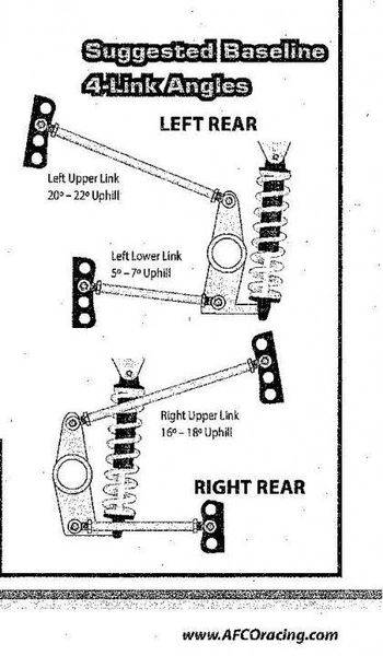

Hello Ranger Mike! You’re doing a great job on here. My question is about rear end set up. We run a 2800 lbs straight rail Pro Late Model on asphalt. A couple of years ago our rear end got slightly bent in a wreck. There’s a guy close that was the chassis specialist for Bobby Hamilton Sr when he won the truck series championship. He has shop now where he builds chassis’s and straightens rear ends.
We took ours to him and he suggested we let him put some toe in and camber in the rear end. He said under acceleration the toe would straighten out due to the force on the rear end. And upon deceleration the toe in would stabilize the car through the turn till you get back on the throttle. The toe was only a couple of degrees and it seemed to help. What are your thoughts on this.
  • #1,385
welcome BEI
This is considered Advanced Race Car suspension class topic! good job!
read Post # 1326 page 67.also Herb Adams book “Chassis Engineering” has a great read on adding negative camber on page 81.
Wrote excellent advice. On left turn tracks negative camber on right rear tire and positive camber on left rear tire is desired. You will have rear end flex on the Ford 9 inch axel because the front face of the housing is weak, just by accelerating and braking. Adding a 1/16 inch toe in will help stabilize this condition. Toe out under acceleration will make the car oversteer or go loose. Make sure you do not have toe out when checking static rear toe in.

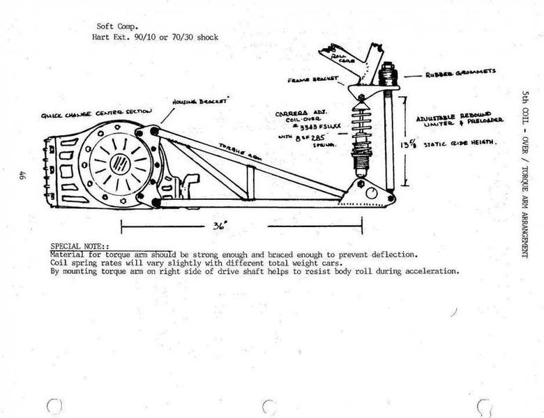

Ranger Mike and all other members of this very informative thread I would like to say thank you.
I just picked up a mini mod that I'm going to go threw from front to rear , top to bottom.
The car has gone threw 3 to 4 pit crews , so it will be interesting to see what has been done to the car.
It has a 3 link with j-bar located to the driver side.
