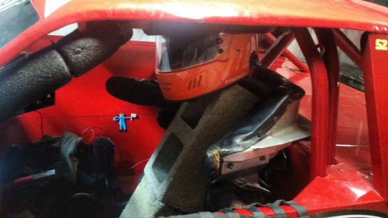

Great Post Ranger Mike, I can't tell you how many times I see teams make small mistakes on t consistency, especially with stagger tapes. Those things stretch easily, or even worse I see one guy with one tape measure on each tire and their yelling across at each other the numbers.
I like the tractor weight reference to IQ, for us it was the use of cinder and deck blocks because we could simulate the driver's position together (also having a 140 lbs driver means we didn't need many) See pic and yes there was a joke about who was better the driver or the concrete blocks.
Thanks for your continued words of wisdom.

good one droobie...plus dummy weights don't talk back, screw up or drink all your beer...lot of merit in um!
