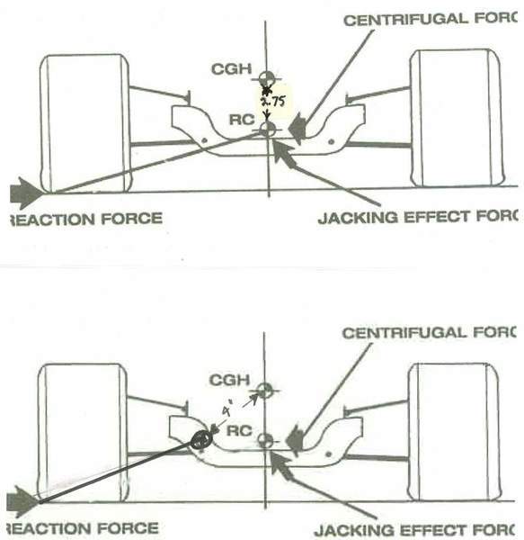

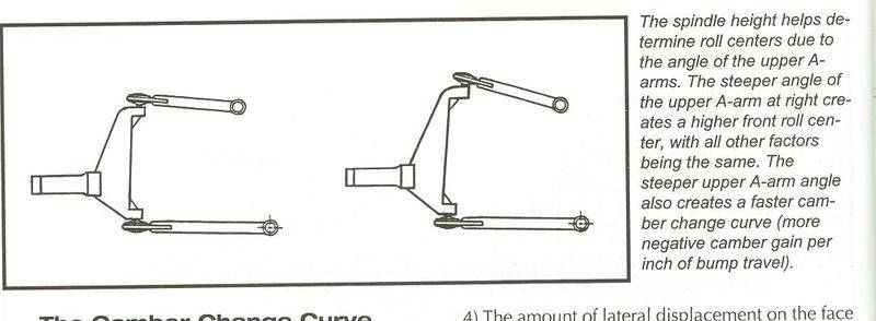

In an attempt to make more clear my description of front roll center location please note attached. Top roll center set up has Roll center 3.5 inch above ground and centered..good for sports car racing turning left and right..50 % of body weight will plant right front tire and is best balancing act you can do when racing left and right. Lever arm from RC to CG is 2.75 inch long
Bottom is for left hand turn racing. RC is 3.5 inch above ground but offset 3 inch to the right. Now slightly more than half the left side spring weight is rotating about the Roll Center and is used to plant Right Front in the turn and you have a 4 inch long lever between RC and CG. Note angle of vector between RC and tire edge. Jacking effect that tries to lift body in reaction to centrifugal force.
Note: if you have too much leverage you will lift the left front
as the body rolls. This will load the Right rear and over heat the tire and eventually you get no grip.
I value your input so let me know if this helps

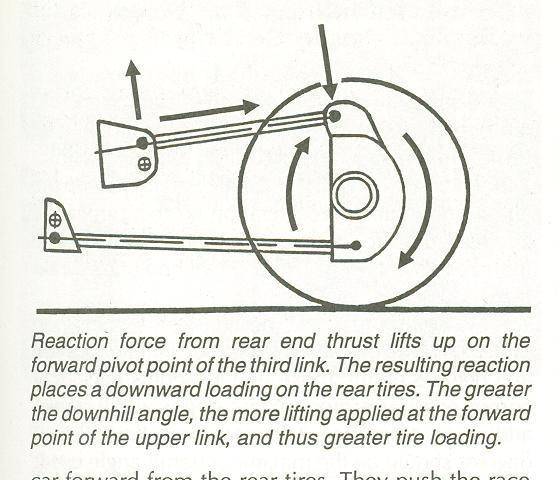

Hello Doctor..glad you are well..Note the attached diagram showing the top 3rd link is being pulled..all I found was the following suggestion on mount height.
3rd link and axle damper can be mounted side by side or over under and the 3rd link should be mounted 12 inches above center line of the axle housing tube. The lower trailing arms should be located with in 8 to 12 inches of the brake rotor face. If they are too far inboard to the center line of the car, leverage forces are going to really shorten rod end life. In an ideal race car world the mount height of top and bottom links would be equal , like the 4 link and swing arm bird cage mounts but we can not make the
3rd link mounts equal because the rear end center section will not permit 3rd link mounting other than on top of the center and if we made the bottom mounts 12 inch they would drag when cornering.
Note: the 3rd link should be mounted to the chassis at the center of the weight mass of the car. The center of weight mass is found by multiplying the rear track width by the cars left side weight %. If you have 60 inch rear track width and 58 % left side weight: 60 x .58= 34.8" so the 3rd link is mounted 34.8 inch to the left of the center of the right rear tire. If the 3rd link is not mounted at the center of width mass the car will not load the rear tires equally under acceleration.

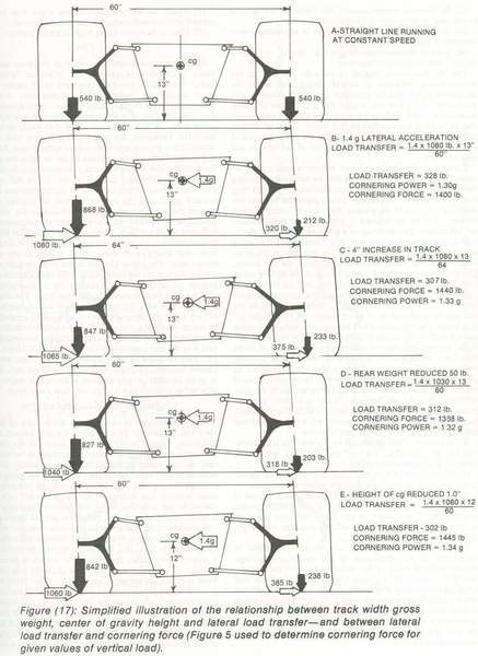

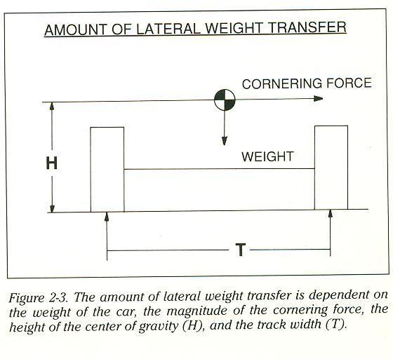

track and wheel base
The advantage of a relatively long wheel base are increased straight line stability, reduced longitudinal load transfer and pitching moments, some what easier reduction in polar moment of inertia and more room for mounting components.
Short wheel base advantages are reduced weight and increased maneuverability.
Wide tracks will reduce lateral load transfer for a given amount of centrifugal acceleration and you can run longer suspension links. The major disadvantage is more frontal area. On open wheel cars this is a mute point as you have Tires that are about 40% of the drag and not much you can do about this.
In general, race cars with long wheel base and narrow track are ideal for the straight and narrow but give up handling in corners. Short wheel base wide track cars are less stable but will corner better.
Now things really get cloudy. Front track should be considerably wider than the rear track. The wider the front track, the more resistance to diagonal and lateral load transfer. Thus the car will be less likely to push when you nail the throttle on corner exit as the inside rear wheel won't be driving as much. Because the lateral weight transfer formula is - W x gs x H / G x T
where T = track width, H = height of Cg, G= cornering force we can simplify the formula by factoring in 1 G of cornering force to reduce the equation to WH/T so if we got a stock car with CG 20 inch tall, 3000 lbs. weight and 60 inch track width, we have 1000 lbs. lateral weight transfer. If we have the same car and widen the track by 4 inches, 3000 x 20 / 64 = 937 pounds transferred and
Wider track will reduce the roll angle, weight transfer, and reduce all the ill effects .

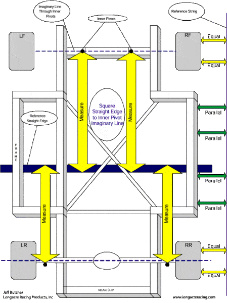

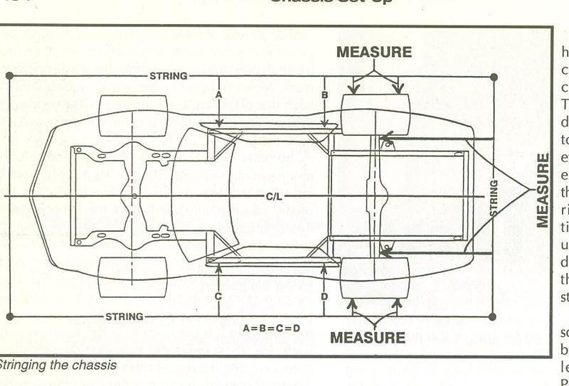

Squaring my car !
Whats the best sure fire way to square all 4 wheels of my car
too many times i find chassiss tabs to be out resulting in a poor reading
i guess there only as good as the guy putting them on!
Thanks smokin
  • #269
String it..old as the pyramids but it works.. Set 4 jack stands on the floor and run string to each leaving the front open. You will be rolling the car into the U and running the front string after the car is in place. It is much easier to check the diagonal measurement to confirm square when car is not in the string U.
Disconnect panhard bar before you check for square. Another check would be to make sure the rear end is not bent. Scribe a line on each rear tire, all tires in fact as it will make things easier. Measure the rear track width every 90 degrees and if you have deviation, the wheel or rear end is bent.
I use plumb bobs to assist in this. I put masking tape on the garage floor and use a felt tip marker to id. the plumb bob touch point. You get the idea. cheap , an pain in the A to set up but it works pretty good. sometimes simple is best.

Squaring a race car is key to proper race car set up. Pointing all 4 wheels in the same direction allows for all of your adjustments to perform in a consistent and predictable fashion.
Let's spend a minute getting on the same page in reference to squaring a race car. For the sake of clarity this article targets Late Model style cars, but the recommendations apply to many race car types. For the purposes of this article we are assuming that the housing is perfectly straight and your frame is in factory condition.
If you identify your goal before starting it helps in the end result. Common knowledge states that the rear end must be square. However, the question at hand is square to what? Referring to the drawing below will help keep things clear as you read the recommendations.
To have a rear end installed correctly we must square the housing to something. But square to what? The common answer is that we need to be square to the frame rails. If your frame rails are perfectly straight then a good result can be gained from utilizing the frame rails as a reference point.
The reality is that frame rails are not straight. Race car frame rails are made from mild steel that is simply pulled from a rack. The steel is not that straight to begin with and welding helps to distort it further. My opinion is that the frame rails are hard to rely on consistently.
Really our goal is to "square" the rear end housing to the front end versus the frame rails. The steel is along for the ride. The front suspension pivot points are the true reference points. By embracing this concept the frame can have some normal bends and bows and you can still be assured a square rear end. My recommendations involve squaring to the front pivot points as this will provide the most consistency.
In addition, we want the rear end housing to be located correctly from side to side in the car. For best performance lining up the right side tire seems to be best. To set the rear end location correctly the front end adjustments must be set up correctly and be in race ready condition.
The right side tires carry the highest forces so keeping the right side tires in line with each other creates the most stability and maximizes left side weight. Lining up the right side tires is my recommendation.
However, your car builder may support a different left to right location so you need to insure that you follow car builder's recommendations so that the needs of the rear suspension links are met. For this article we will assume that the car builder laid out the suspension with the right side tires lined up. You will want to pay special attention to this detail as it is a higher priority to have the trailing arm brackets and top link hardware to be located in the proper location. For example, you want the top link to be perpendicular to the rear end housing and parallel to the car. Trailing arms must also be running forward at the correct car builder design angle.
These design elements must be considered so be sure to consult your car builder about his design parameters for the Left / Right location for the rear end housing. Ok, now that we are on the same page, let's review: The front end is set and is race ready. The car is set at ride height by using solid links in place of the shocks or it is sitting up on stands at race ready ride height with air pressure and stagger set properly. Your rear end housing has been checked and it is not bent and it is ready for installation. We also need to insure that the panhard bar is set to the correct height and that the trailing arm and top link angles have been set properly.
Step 1: Setting Up The Reference String
Set up a string on the right side of the car and extend the string well past the front and rear tires. Attach the string between two simple jack stands. Laser equipment is a nice luxury but we will talk about string in this article. I have found that it is best to set the string up at a height off the ground equal to the bottom of the frame rail.
Now that your string is set parallel to the car turn the right front wheel until it is parallel to the string. Record the distance from the string to the right front tire. Take notice that you are taking in the effects of camber by setting the string at frame height versus spindle height helping you to align the rear contact patch with the front contact patch.
Negative camber at the right front moves the contact patch to the right. We set our string even with the frame rail so the effects of negative camber are considered as compared to setting the string at spindle height. Setting the string at ride height allows the rear contact patch to more closely line up with the front contact patch which is offset to the right due to the effects of negative camber.
Step 2: Aligning The Right Side Tires
Now we want to begin lining up the right side tires. Match the distance from the right rear tire to the string so that the distance is equal to the distance from the right front tire to our reference string. Quickly check at the right rear tire that your rear end square is at least in the neighborhood. If the string is parallel to the frame then the front and rear sidewalls of the right rear tire should be parallel to the string as well.
If the rear end measures differently from the sidewalls of the right rear tire to the string then average the difference to locate the rear end. For example, your measurement to the string at the right front tire is 6". We want the same at the rear but when checking we end up with 5-15/16" and 6-1/16". As the average of 5-15/16" and 6-1/16" equals our 6" dimension at the right front tire we can be content with the lateral location and we are now ready to set the housing square to the front pivot points. Leave your string in place as you will want to verify the lateral location setting the square. Adjusting the trailing arms can have an effect on the lateral location. You will need to double check the lateral location after completing the squaring step.
Step 3: Setting Up The Reference Straight Edge
Many people use masking tape, plumb bobs, and chalk lines to square the housing in the car. Experience has shown that the amount of transfer error reading thick chalk lines as well as trying to make a mark exactly at the point of the plumb bob creates too much error. These transfer errors lead to inconsistency and the work is tedious. Further, each time you adjust the rear end you have to repeat the plumb bob transfer down to the floor. I believe this method just takes too long, is frustrating, and is less accurate.
I prefer to go about it a little differently. Remember we have determined that we want to square to the front pivot points. Ok, now here is where you need to spend some initial time to insure repeatability and accuracy. Find a perfect straight edge that spans the length of the rear end housing.
Next clamp the straight edge to the bottom of the frame about half way between the front and rear axles. The forward / aft location of your reference straight edge is not critical. Somewhere around center is good, but again it is not critical. When clamping the reference straight edge use a carpenters square and clamp it exactly 90 degrees to the straightest frame rail. Even though we are going to insure that we are square to the front pivot points the frame rail does need to be considered. We want the rear end to be square to the frame rails and we will fine tune to the front pivot points to eliminate any irregularities in the frame rail. In general the goal is to have the frame rails, front pivot points and rear end housing in perfect square.
Now that our reference straight edge is clamped in place and is 90 degrees to the straightest frame rail, we are ready to fine tune the location of the reference frame rail. Remember we want to eliminate variance in the frame rails and square to the front pivot points. Hook your tape measure on the straight edge and measure forward to the front inner pivots. Be sure that your tape is running straight forward for accuracy. Fine tune your straight edge until is is exactly parallel to the front inner pivots. Take you time and locate the straight edge until it is dead square.
Before continuing it is a good idea to mark the location of the straight edge with a scribe or a peen mark on the bottom of the frame. These marks will allow you to clamp your straight edge in place in the future in a minimum amount of time. Should you need to verify that your rear end is square at the track, you will find the straight edge and indelible marks is a very time saving luxury.
Step 4: Squaring The Rear End
Hang two strings off the rear end at the outer most points. You can use two plumb bobs but a heavy nut tied to a string will work just as well. For optimum accuracy remove the rear hubs and hang the string off the machined bearing surface of the rear hubs. However, on a quick change rear end the machined axle tubes are quite accurate.
Now that your strings are hanging down you can quickly hook a tape on the reference straight edge and measure back to the strings. Be sure that your tape measure runs straight back. Adjust the housing as needed. After an adjustment you can quickly check the square. With the plumb bob and tape method you would need to transfer all the marks back down to the ground which takes a long time. The reference straight edge concept allows you to make the adjustment and measure directly to the hanging string. You can read the exact measurement very easily.
Because it is so easy to check the square be sure to keep adjusting until the housing is right on. Spend the time and get it right. With the plumb and tape method many racers would call it "close enough" due to the hassle factor of transferring all of the points down onto the tape on the floor. Spend ample time and get it right.
You will find that the reference straight edge method is much faster and more accurate. Further, you can carry the straight edge with you to the track. The plumb and tape method requires a level and flat floor. You would have a hard time at the track with plumb bobs and tape on asphalt. The reference straight edge is an easy deal if you have done a good job of marking and recording the reference points.
Step 5: Verify The Lateral Location
Now that you have the rear end square you need to verify that the left to right location still lines up with the right front. If it is still ok left to right then you are ready to go. If the housing no longer lines up with the right front you will need to readjust the lateral location. If you move the housing laterally you will need to repeat the squaring process. It is common to have to go back and forth between the left/right adjustment and the square adjustment as they both have an effect on each other.
Step 6: Record Your Reference Marks
You have spent plenty of time and you have verified that your rear end is dead square. You have already marked the location of the reference straight edge and can rely on those points for quick reference. Next, it is wise to record a reference point for the left right location. On an under slung style late model you can utilize a good adjustable carpenter square. Place the movable piece of the square on the right rear brake rotor and slide the rule over until it touches the under slung frame rail. Write down the reference number in a safe place. If you have something other than an under slung style frame, simply use a tape measure from the right rear brake rotor to a reliable reference point on the frame. Recording this quick reference dimension will prove invaluable when at the track and really saves time when you need it most.
You will find that having the ability to square to these reference points will save you a lot of time. Obviously if your frame gets hit you will need to verify and adjust your reference points. But, if you damage your rear end housing at the track, you can utilize these reference points very quickly. You will find that the reference points come in handy when making panhard adjustments as well.

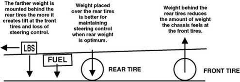

fuel cell location in asphalt racing
in road racing in the center of car if the fuel cell is mounted to the right
in oval racing fuel load becomes left side weight . =which deminishes as the race goes on < therefore left side weight goes away
  • #272
Good question, Smokin...
Check the rule book and do not fudge when it comes to safety. When it comes to mounting, up, down, left, right, or center? The one you choose depends on the type of racing, how long your races are, and even what fuel you use.
If you run on pavement, you want the lowest possible center of gravity. Therefore, the fuel cell should be low and should not be the lowest thing on the car, but it can be as low as the frame rails. There must be substantial bracing around the cell..do not cut corners here. The cell should be mounted to the right. This is more important if you run long races in which you burn so much fuel that the cross weight changes. If you use alcohol, you will burn fuel at a much faster rate. This weight change tends to tighten the car as fuel (weight) is burned, and at the end of a race, it is better to have the car tighten up than have it get loose.
On a dirt track car, up is better because you need weight transfer. Mounting the cell high, not extremely high, but let's say on the trunk floor, aids weight transfer. This is a protected spot in the car as well. If you are using gasoline and running 20-25-lap races on a 1/4-mile bullring, the side on which you mount the fuel cell won't really matter. You probably won't use more than a couple of gallons. In this case, the loss of 15 pounds from a 3,200-pound stock car is not going to be noticed. On the other hand, if you were using alcohol, you would lose maybe 30 pounds. That might begin to be noticed, so mount the cell to the right.
For left weight, such as when using a 16-plus-gallon fuel cell filled for ballast, mount the cell to the left. Keep in mind that this corner usually takes a lot of abuse.
n some situations racers find themselves moving weight behind the rear axle to compensate for hard tires or very low traction conditions. While this can work, it is a double-edged sword. As weight is placed farther behind the rear axle, front-wheel weight decreases and steering control is reduced. Think of it as a seesaw, (see Diagram) as weight is increased or moved farther behind the fulcrum, the amount of weight felt at the front of the chassis decreases--especially when the forces of acceleration and the car bouncing through rough parts of the track are factored in. Locating the weight directly over the rear axle will produce forward bite while helping to maintain steering control through the corner. Extra bracing here adds left and rear weight as well as protection.SAFETY FIRST.

Why change spindles? it' s all about tires. You want to maintain the most tire contact and controlling camber change is the solution. Shorter Spindles ( all else being the same) will lower the Roll Center and reduce camber change. See post 4 to 7 above and look at post 13 diagram. Please read the posts on why roll center height and location are so important in round track racing. The Impala spindles are the " hot set up " on a metric chassis. Big Chevy Impala and Caprice 1980 to 1994 casting number is 369056 for right side and 396055 for left side and if you can not locate these I can send you info on other substitutes. They are 6 pound lighter got 1 inch wide x 12 inch rotor and 5 x 5 bolt circle.

One of the most frustrating things I found in racing was shear ignorance of some people who ought to know better. The monkey see monkey do phenomena is alive and well at the short tracks and its every where. for the young racer coming up the quicker you learn this and the faster you grasp the basics , the better off you will be..to include dealing with life's frustrations..Enough of this philosophy b.s.
We bench mark a race car to establish a measurable base line. Racing is a constant adjustment process. on any given day the track will change and you have to adjust for this condition. Add in competitive changes to improve performance and you are constantly working on the set up. Races are won buy the driver and crew that can negotiate the course the fastest and FINISH ahead of the rest. When you are adjusting many things ( only one adjustment at a time is the rule...right.. like that's going to happen) you have changes things from the base line. What happens if you get punted and hit the wall and have to swap out suspension parts? Back to base line and add in adjustments you made to the point you got wrecked.
We are going to bench mark the car to measure all settings and make are record so we can make logical adjustments that will give us better performance than the other guy.
Get some white poster boards from the drug store or Wal-Mart. You will have to tape a few sheets together so you have enough area cover both front tires and frame mount points when you drop a plumb bob from the upper and lower frame mount points in the front. We are not going too deep into the suspension and will not worry about the upper and lower A-arm rear mount points.
Start with the car fueled up, tires inflated, in full race trim and it helps if you can get the neighbor hood fat kid to sit in the drivers seat while you are measuring things. In my case I got some Massey Ferguson tractor weights that equaled the drivers weight..(and some said IQ but I digress). We need to establish a vehicle center line. I use the mid point of the track width ( mid point of the tread ) and mark this on the paper.
What we are going to do is measure and record the vehicle center line. We are going to measure the length of all A-Arms from the frame mount point to the center of ball joint AS VIEWED FROM THE FRONT OF THE CAR. This length may not necessarily be the length of the A-arm. In other words the distance between these two points as intersected by a plane parallel with the floor.
We are going to measure and record the height from the floor and distance from vehicle centerline of each ball joint center, spring pad center or coil over mount point center and A-arm frame mount center point. On strut cars we have to do the same for upper and lower strut height and location , lower BJ and upper and lower spring pads if applicable. When complete we will use the Circle Track Analyzer from Performance Trends to see where the Roll Center is and go from there..More later. out of beer..
Rebel and WN9 ...i am counting on you guys to send me the data once I finish this post so we can see where things are on both your cars..send me private message if you prefer not to post..

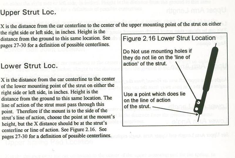

some tips to help you bench mark the car

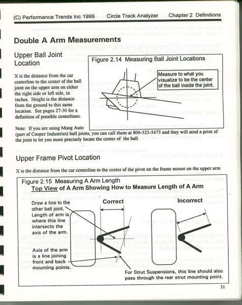

Mr. Mike, can you expand on the construction and use of your fabricated traverse bar? I. like many others, am looking to ease the whole set up procedure to effectively reduce the amount of time and effort spent on the mundane work so as to get to the "meat of the matter." Time spent messing with jackstands and strings, the neighbor's dog who came to visit adjusting your strings, back and forth on the caster/camber/turn plate deal, etc. is time that could better spent on the tiny details that make for lower lap times. More time to spend on the shock dyno, more efforts at the "what ifs" in software geometry analysis and so on.
In my mind and at my age, I am leaning toward a take down fixture with enough accuracy that it can easily be set up in the hotel parking lot, adjusted to accommodate pavement irregularities and will allow you to get the bulk of your critical squaring, caster camber, toe, bump, etc done with the suspension basically locked ( blocking, fixed links, add on fixtures. etc.) and the obstacles (tires) out of the way. Following this, the balance of scaling operations with the car reassembled. The specific details of procedure can be finalized when the details and use of traverse bar is refined.
On another note as to why this sort of thing is important; anyone here notice the drop off in interest in part time crew help? Seriously, I have noticed a strong trend in the last six years where race car help is becoming more difficult to obtain. The poor economy further fuels this problem as people who are likely to help, think twice about their out of pocket expenses in doing so. Also, the sheer number of diversions and intrusions on a person's time makes getting the appropriate amount of time spent on the race car harder to accomplish. That is why time spent here is so important. A good understanding of what to achieve coupled with refined and expedient ways to achieve them with less people power saves time for other activities needed to make things go fast...including beer, pork rhines...and the occasional romantic endeavor. The later done to maintain clear thinking and refine one's personal style!
  • #292

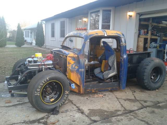

First post to the site. I have been going through this thread for about two weeks now, but I have a few questions. I'm building a little street rod and am having some trouble deciding on what to do for rear suspension. I am using a ton of circle track parts on this and wouldn't mind sticking with that style of rear suspension. The thing weighs around 1950lbs wet + 200 for me, SBC, TKO600 manual trans, Winters Quick-Change, front suspension is based off of a "Rayburn" car.
What would some of you guys be looking at and considering for this? I'm kinda leaning towards a torque-link setup right now or maybe a triangulated four-link? Thoughts? What else do you need from me?
Here's a quick pic for S&G's:
  • #293
rce4csh ..the whole point of the traverse gage was to provide a quick easy to use set up to measure any changes ( via sudden impact with the 3rd turn wall, other cars etc..)
problem is it was bulky, and only measured one side at a time. I sold industrial lasers at one time in my seedy and questionable career and played with the idea of using a couple of rifle bore scope lasers to replicate the string procedure. Note attached sketch..
we need to fabricate a reference datum made 1" x 1" mild steel tubing. We have to mount this inside the cockpit as mounting it underneath the car can be a problem due to headers and the like. the mount locations could be roll bar gussets drilled to mount the stand off bars that connect to the reference bar. The reference bar would have a plate welded on each end to accept the bore scope laser block.
Bore scope Laser block - This block can be rotated and locked into position through out 360 degrees rotation. It has 4 flat sides and a small spirit level can be placed on it to level to earth. Now we have a means of doing quick chassis checks anywhere.
The mounts and blocks should be as square as possible and marked for mounting.. i.e. once you mount this make sure each time the bar is mounted the same and that way the right side laser will be on the right side..etc.
How it works- You have to string the car as described in the previous post. Place the spirit level on the block and level it. This should spot the laser on the garage floor as perpendicular as possible. This is the right side bench mark. Place a piece of masking tape there and mark the dot with a felt tip marker. Now you can spot the laser dot at the ground in front of the right front wheel at the location you have marked after using the sting method to determine the proper location. You are simply recording the distance from the bench mark to this point so you ca repeat this in the future without having to string the car.
If you really want to save time you can fabricate a " square " for each wheel which is simply a 4" x 4" block of wood trued up to square that has a center line scribed on it and is the exact height of the spindle center line or axle center line. Instead of one laser dot at the wheel location you record two or three and scribe a line on the masking tape. Then you place the " square" on the masking tape and center the scribe line of the square to the spindle center line. Now you can record the distance from the bench mark and you have your set up for that wheel.
BUT.. you are at the mercy of an unknown garage floor surface and things get squirrley when you project " squareness " from a non true surface.don't forget the car should be in race trim and same ride height. It would help greatly if you used a set of wheels and tires ( we painted our red) that was used for this. That way we knew the stagger was the same and the wheels were not bent.
I am sure the active minds on this forum will skull this out and come up with other innovative solutions...

I assumed the relation fo the rear arms affected weight transfer and traction when on the throttle and brakes. What seems better for forward bite raises the rear roll center which would want to make the car loose in the corner (?). I can change these angles somewhat since I am using a 9" Ford rear and have to install mounts on it anyway...
On stock rear four links and all the 3 links at the track, the upper bar(s) are angled down toward the front of the car with lowers being close to level... Some with stock four links are running with the right rear wheel pulled ahead to combat loose conditions... seems like a bandaid...(?)
Just wondered if there were optimum angles to provide good traction and how it affect rear roll center, or would it change the rear roll center since it is high compared to the front anyway...
So the current thinking is that we want the rear of car to steer out when the body rolls in the turn?
