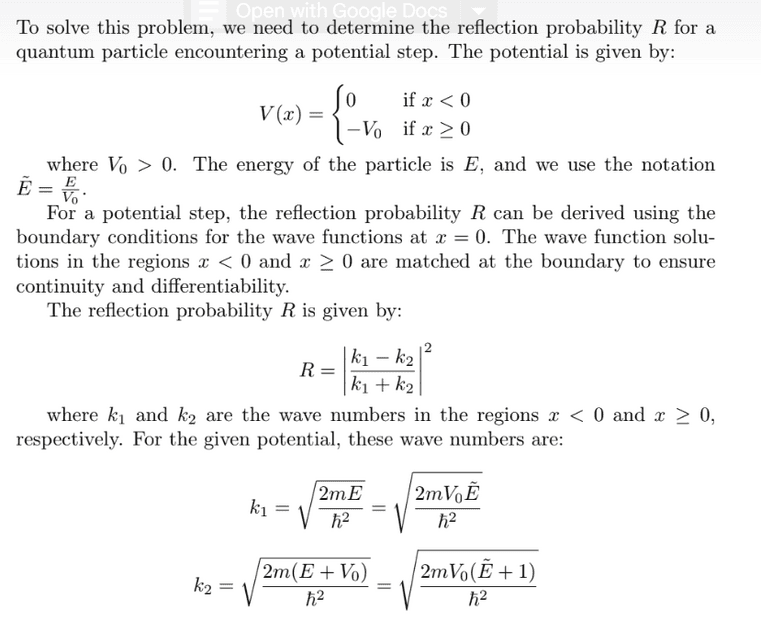

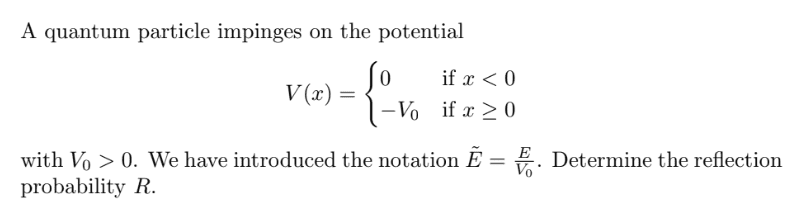

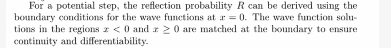

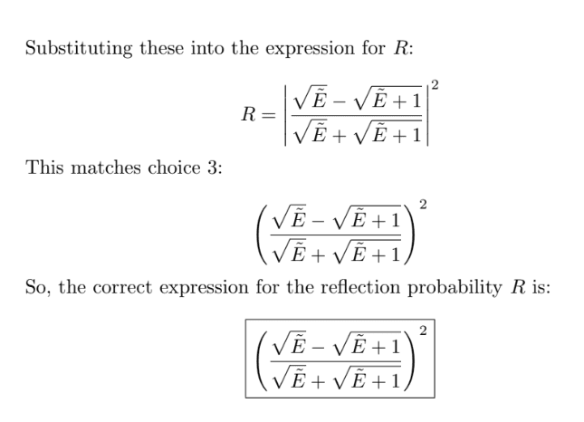

I have doubt where they got the reflection probability formula from. Someone may know how to find it. I think that ##R + T = 1##. But I'm not sure where the transmission probability formula comes from either.
Kind wishes
Did you try to do what they actually say in the text?
Sir, blessed.
I have a doubt where to start in the proof. Not sure what logic to use.
