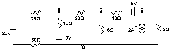

Replace the emf+series resistance(s) by the Norton equivalent
The discussion centers on understanding how to replace an emf and series resistances with their Norton equivalents in a circuit analysis problem. The original poster struggles with the concept of Norton equivalents, particularly when not given a specific load resistor. They suggest that the 8V and 5V supplies, along with their respective resistors, should be converted to Norton equivalents before proceeding with the node-voltage equations. The response emphasizes viewing the voltage supplies and resistances as Thevenin models to facilitate the conversion. Clarifying this concept is essential for solving the problem effectively.
andrewmac
Write down the node-voltage matrix equation for the following circuit. Hence find the total power dissipated. (Hint: replace the emf+series resistance(s) by the Norton equivalents.)
n/a
The problem I'm having is that I don't fully understand what is meant by replace the emf+series resistance with the norton equivalent. I have a very weak grasp on norton equivalents, and I'm more comfortable with them when I'm told "with respect to.." and a load resistor. The rest of the problem I'm sure I can do fine but this first part has stumped me. Thanks in advance for any assistance, I really appreciate it.
Presumably the idea is to replace the 8V supply and 10Ω resistor, and the 5V supply and its 10Ω resistor, and the 20V supply with its 25Ω and 30Ω resistors with their Norton equivalents, then proceed to write the node-voltage equations, etc.
Think of the voltage supplies with their series resistances as Thevenin models.
