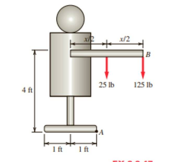

The robot has an extendable arm that weighs 25 lb and picks up a 125-lb load at point B. If the robot starts to overturn when the moment at point A is 100 ft*lb, how far out (x) can the are extend
M = Force * Arm
M robot = (125-25)lb* 1 ft = 25 lb*ft
M arm = 25 lb * (x/2 -1 )
M load = 125 lb * (x-1)
Mtotal =. 100 + 12.5 x -25 + 125 x -125 = 100
X = 1.09 ft
but the correct answer is 1.82 feet, why?
What is the "100" on the left?
What, exactly, do you think is intended by "the moment at point A" in the question?
