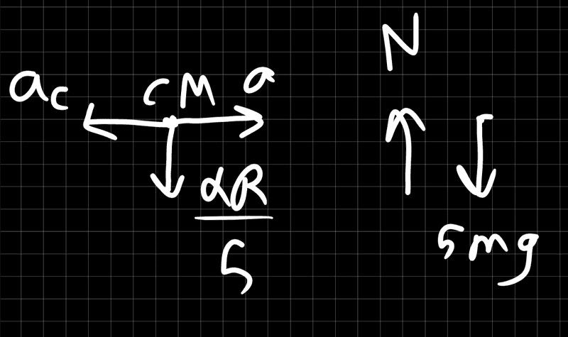

Here is my attempt for finding the frictional force. I have assumed that the center of mass is in circular motion with respect to the geometric center of the ring.

Also @kuruman I have confirmed with my teacher, who says that from the frame of the center of the ring, initially the center of mass would appear to trace a circular path, so it has an angular acceleration alpha (r/5) at that instant
Please don’t post working as images. It is contrary to forum rules for good reasons. Your writing is not completely clear, and it makes it hard for responders to refer to specific equations. If you must post working as images write very clearly and number the equations.
Also, you do not explain where your equations come from.
In your attachment to post #79, you seem to have an equation which has forces equal to ##\alpha R/5##. Is there an m missing?
In the attachment to post #101, what is ##\Sigma lp##? Or is it ##\Sigma \tau p##? Or ##\Sigma \tau_p##?
Wrt the answers, I do get something different.

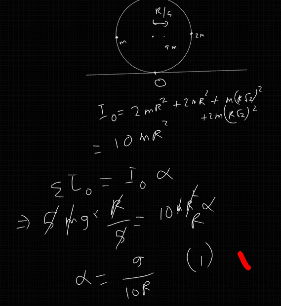

For force of friction I just took the torque about the center of the ring that's it
Also I SUDDENLY got another doubt...doesn't the bottom most point (here ICR) have an upward acceleration? Then why are we not considering the pseudo torque due to that..
If you are taking torques about an axis that lies on a vertical line through the centre then the vertical acceleration of the contact point is irrelevant.
In the attachment to post #79, the penultimate equation has a term at the end I had read as ##\frac R5\frac 9{10R}##. You said there was an m missing, but I now think you meant ##M=5m##. And what looked like a 9 is actually a g.
Fixing those gives ##5m\frac R5\frac g{10R}##, which reduces to ##m\frac g{10}##.
I assume this term came from an equation ##a=g/10##, but I can’t find where that comes from. Is the derivation of that in another attachment?

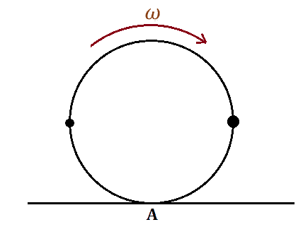

The equation ##\large \sum \tau_{A} = I_{A} \alpha## yields the correct answer for ##\alpha## for this particular problem. But, in general, this equation is not valid. For example, if the ring has angular velocity ##\omega## at the instant shown below, then ##\sum \tau_{A} = I_{A} \alpha## will not work for finding ##\alpha## at this instant.
However, taking torques about the center of mass of the system will work: ##\large \sum \tau_{cm} = I_{cm} \alpha##.
This is already a long thread and I hesitated to post this. But I want to caution students that ## \sum \tau_{A} = I_{A} \alpha## is not generally correct.
If you want to use point ##A## as the origin for torques, then the valid equation is ##\sum \tau_{A} = \dfrac {dL_A}{dt}##, where ##L_A## is the angular momentum of the system about ##A##. But, generally, ##\dfrac {dL_A}{dt} \neq I_A \alpha##.

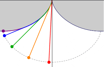

I'm not sure. The physical pendulum always rotates about a fixed axis in the lab frame. The rolling ring does not rotate about a fixed axis.
After additional consideration, I think that the model for the motion is the cycloidal pendulum. The simulation on the right is taken from the cited reference. In this current problem, the CM is a point on a circle of radius ##\frac{1}{5}R## that rolls without slipping on a line parallel to the surface at distance ##\frac{4}{5}R## above it. Therefore, it describes a cycloid.
Parameter ##a## in the reference model can be found by matching the overall horizontal displacement in the model ##\Delta x_{\text{mod}}=2\pi a## to the overall horizontal displacement of the CM here, ##\Delta x_{\text{cm}}=\frac{2}{5}R## to get $$a=\frac{R}{5\pi}.$$ Then, one can use equations 19.9.5 and 19.9.6 to find the coordinates of the CM as a function of ##\theta## which is the angle that the straight part of the "string" forms w.r.t. the vertical, $$\begin{align} & x= \frac{R}{5\pi}(2\theta+\sin2\theta) \nonumber \\ & y=-\frac{2R}{5\pi}\cos^2\!\theta. \nonumber \end{align}$$ Finally, one can take derivatives to find ##\ddot x## and ##\ddot y##, apply the initial condition ##\dot {\theta}(0)=0##, find ##\ddot{\theta}(0)## from the torque equation and apply Newton's second law at ##\theta=0## to find expressions for the initial Cartesian components of the net force.

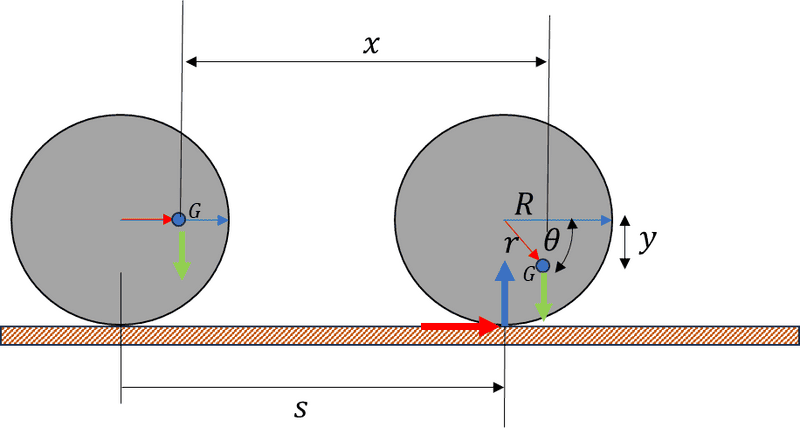

Well, I got a different answer for the initial angular acceleration... So what goes wrong here.
I find ## \alpha = \frac{25}{51}\frac{g}{R} ##
Here is what I did:
$$ x = R \theta + (\cos \theta - 1) r $$
$$ y = -r \sin \theta$$
The derivates follow as:
$$ \ddot x = R \ddot \theta - r \left( \dot \theta^2 \cos \theta+ \ddot \theta \sin \theta \right)$$
$$ \ddot y = r \left( \dot \theta^2 \sin \theta - \ddot \theta \cos \theta \right) $$
Where ##r = R/5##, but leaving it general for now.
I get three equations of motion
##\sum F_x##
$$ f = M \ddot x $$
##\sum F_y##
$$ N - Mg = M \ddot y $$
## \circlearrowright^{+} \sum \tau_G##
$$ N R \cos \theta - f R = I_G \ddot \theta $$
Where ## M = 5m ##
Now get all the equations into functions of ##\theta## and its derivatives.
$$ \implies N = M r \left( \dot \theta^2 \sin \theta - \ddot \theta \cos \theta \right) + Mg $$
$$ \implies f = M \left(R \ddot \theta - r \left( \dot \theta^2 \cos \theta+ \ddot \theta \sin \theta \right) \right) $$
At this point I just make the substitutions for the initial conditions ## \theta = 0 , \dot \theta = 0 \implies \cos \theta = 1, \sin \theta = 0 ##
$$ \implies N = Mg - Mr \ddot \theta $$
$$ \implies f = MR \ddot \theta $$
Rearrange the last:
$$ \ddot \theta = \frac{f}{MR} $$
And then sub into the sum of torques about ##G##:
$$ f R = MgR - \cancel{MR}r\frac{f}{\cancel{MR}} - I_G \frac{f}{MR}$$
$$ \implies f = \frac{M^2 R^2 g }{MR^2 + MRr + I_G } $$
I find the mass moment of inertia about ##g## to be:
$$ I_G = 2m \left( \frac{4}{5}R \right)^2+ m \left( \frac{6}{5}R \right)^2 + \frac{1}{2} 2m R^2 + 2m \left( \frac{1}{5}R \right)^2 = \frac{21}{25}MR^2 $$
Finally
$$ f = \frac{25}{51}Mg $$
$$ \alpha = \frac{25}{51}\frac{g}{R} $$
Can someone see where I've gone off the rails? Thanks.
EDIT: Errors found-
1) Used wrong moment arm for torque of normal force, should be ##r##.
2) Error in using the wrong model. I used a "disk" when the OP is a "ring"
Fixing the errors verifies solution for ##\alpha = \frac{1}{10} \frac{g}{R}## that has been previously shown.
  • #141
erobz said:
$$ I_G = 2m \left( \frac{4}{5}R \right)^2+ m \left( \frac{6}{5}R \right)^2 + \frac{1}{2} 2m R^2 + 2m \left( \frac{1}{5}R \right)^2 = \,\, ...$$
The third term on the right should not have the factor of ##\frac 1 2 ## for a ring. Otherwise, it looks good.
  • #142
I could have sworn it was a disk! Thanks for finding that and your time.
  • #143
Unfortunately, still no dice...
$$ I_G = 2m \left( \frac{4}{5}R \right)^2+ m \left( \frac{6}{5}R \right)^2 + 2m R^2 + 2m \left( \frac{1}{5}R \right)^2 = mR^2 \left( \frac{32}{25} + \frac{36}{25}+\frac{50}{25}+\frac{2}{25} \right)= \frac{24}{25}MR^2 $$
$$ \alpha = \frac{25}{54} \frac{g}{R} $$
  • #144
erobz said:
$$ mR^2 \left( \frac{32}{25} + \frac{36}{25}+\frac{50}{25}+\frac{2}{25} \right)= \frac{24}{25}MR^2 $$
Check the fraction on the right side.
  • #145
I get ## \frac{120}{25} = \frac{24}{5} ##
Then I sub in that ## m = \frac{1}{5}M ## I get ##I_G = \frac{24}{25}MR^2##
I'm not seeing it.
  • #146
I'm not seeing it.
Oops, my oversight. I didn't notice the switch from ##m## to ##M##. I agree with your result for ##I_G##.
  • #147
Is the lever arm correct for ##N##? Did you mean to use ##r## here instead of ##R##?
  • #148
It was supposed to be ##r##... Another blunder! I'll recalculate.
  • #149
Yep. It agrees now.
$$ \alpha = \frac{1}{10} \frac{g}{R} $$
Thanks again @TSny for verifying.
  • #150
The CM moves on a circle that slips on the ##\frac 4 5 R ## line as the ring rolls. The motion of the CM is a curtate cycloid. (I just learned this term! :oldsmile: ).
