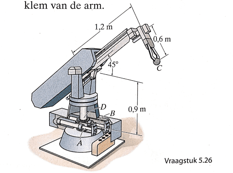

The robot arm is driven by two hydraulic cilinders A and B which brings point D rotates CW. The gear in point D has a angular velocity of 5 rad/s. Calculate the velocity and acceleration of the part in point C.
Velocity = angular velocity * radius
Acceleration = angular velocity^2 * radius

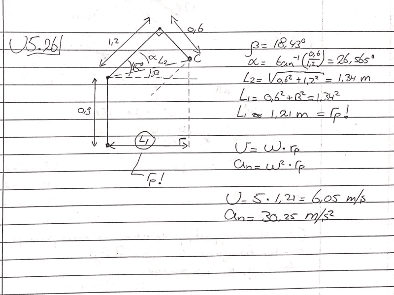

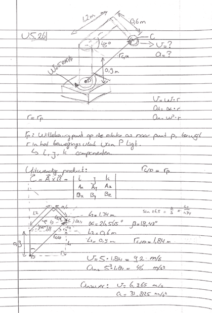

Hello,
Given the figure below, and the following statement:
"The robot arm is driven by two hydraulic cilinders A and B which brings point D rotates CW. The gear in point D has a angular velocity of 5 rad/s. Calculate the velocity and acceleration of the part in point C."
First I determined the distance from point D to C as rc/d, this distance is used for the formula's. The answer doesn't correspond, what am I missing here??
Like to here! :)
Likes Mech_LS24
Thanks @Lnewqban . Found the solution :)
Likes Lnewqban

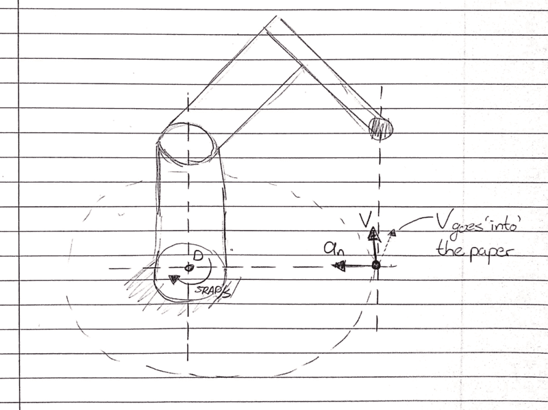

@Lnewqban , just to be sure, could you verify the sketch below? I draw the velocity and acceleration vectors acting on point C, where V actually goes 'into' the paper.
If I understand it correctly, I believe that vector V should be pointing out of the paper, as the rotation of the gear has been said to be clockwise.
The rest of the diagram seems to be correct.
Likes Mech_LS24
You are right, thanks! :biggrin:
Likes Lnewqban
