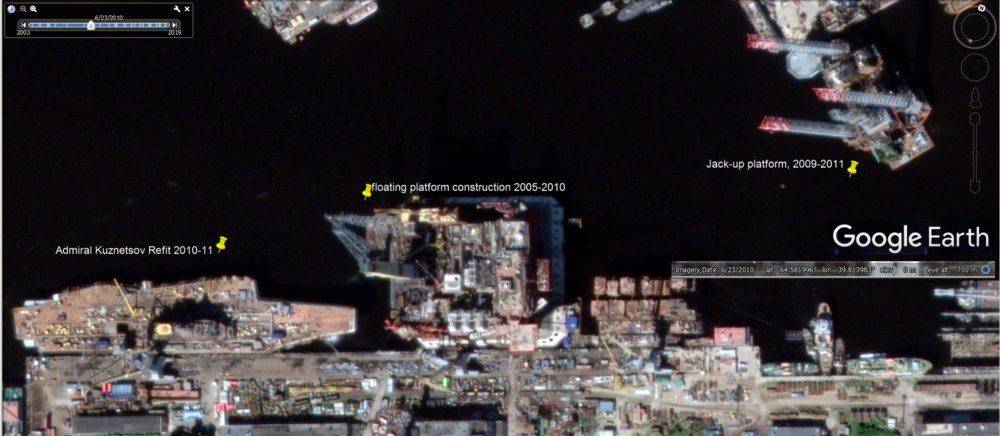

Put yourself in the position of having to test a nuclear powered jet cruise missile and a nuclear powered torpedo. The submarine needed to launch the torpedo is not available yet so you need test facilities. I expect a nuclear powered missile would initially be tested on a static stand with a modified turbojet engine to provide the ram airflow. The combined thrust would require the test rig be fixed.
We can see with Google Earth (6/23/2010 attached), increased activity in the Severodvinsk shipyards during 2010 and 2011. A jack up platform is being modified. Wind the clock back to see (in front of the unrelated refit of the aircraft carrier Admiral Kuznetsov), a wide floating platform being progressively assembled from modular units. The floating platform outer edge has a white glacis plate, with cut corners. Judging by the length of the shadows you can see the superstructure on the floating platform is higher than the deck of the aircraft carrier. The middle section was assembled first, covered with a central structure.
I think the jack up platform was being modified for testing the 9M730 Burevestnik cruise missile, and became the site of the recent explosion. I think the floating platform is the accommodation and facilities for testing the sister project, the Poseidon nuclear powered torpedo and the launch system.
Where are those platforms now? My best guess is based on marine navigation charts that show three special purpose buoys located at 65.225135°, 38.814129°. That is out in the middle of the Dvinskiy Gulf, White Sea, an area not imaged by Google Earth. That area is ideal for testing both of those weapons systems.
