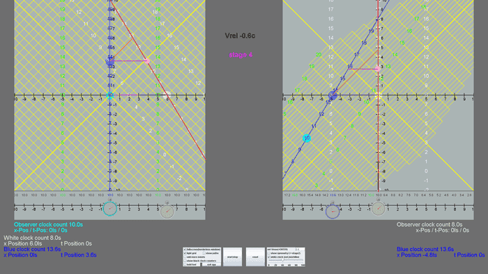

It would help if you would start with a less complicated scenario first.
Imagine a 3rd observer C.
He observes both A and B moving towards each other with a relative speed of 0.6c. Their clocks are synced and will remain synced from in his frame of reference. When they are at a distance of 10 lightseconds, their clocks both display 0s and they release a lightbeam at the same time from C's perspective.
C draws a spacetime diagram where he places himself at x=0, t=0. A at x= -5ls, t=0 and B at x= 5ls, t=0
Observer C will measure the lightbeams to take 7.69...s to reach A and B respectively.
Since the situation is completely symmetric. A will measure the same time for his lightbeam to reach B as B will measure for his beam to reach A. They will also both measure the same distance between each other.
That is, the _instance_ of A with a clock count of 0s and the _instance_ of B with a clock count of 0s.
However, space separated events which are simultaneous in a given inertial reference frame, are NEVER simultaneous in another inertial reference frame. Observer A at x= -5ls, t=0 and a clock count of 0s is an event within C's reference frame.
Observer B at x= 5ls, t=0 is another event.
Those events are simultaneous for C.
For A, those events cannot be simultaneous, nor can they for B.
So when A checks his clock and registers 0 seconds, the instance of B he measures at a distance will not be an instance with a clock count of 0 seconds, but a higher value. Otherwise said: From A's perspective, when he registers 0 seconds on his clock, B's clock will not be a 0s but higher.
The same is true the other way around. When B registers 0s on his clock, A's clock will not be at 0s but higher for exactly the same value.You can always find an observer C which observes both A and B to be moving at the same speed relative to him. He can send a lightsignal to both A&B such that their clocks are in sync from his perspective and will remain in sync since he calculated the same time dilation for both.
Doing this, A and B will get the same results for their measurements for same clock counts on their respective clocks.
Syncing the clocks from any other inertial frame of reference in which A and B are observed to move at different speeds, would lead to different results for both. And of course, the clocks would not remain in sync either.
This is why above posters insisted on you defining the reference frame the clocks would be synced from.
If for example, A observes his clock count to be at 0s and at the same time he observes/measures B's clock count to be at 0s, B will never observe his clock count to be at 0s and A's at 0s as well, because of the difference of reference frames.
So it makes no sense for you to just say that they are in sync at 0s. They can only be in sync from A's perspective OR from B's, but not both.
