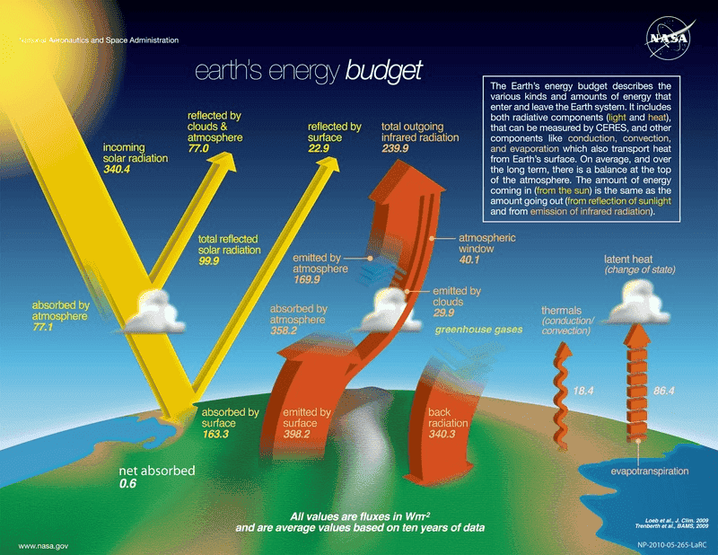

Is my simple explanation of the greenhouse effect correct?
This is a very simple question. I've read a fair bit about the greenhouse effect and how GHGs affect the Earth's surface temperature and I know it can get very complex. But if I boil it down, it seems to be a very simple thing. Am I right to think of it this way?
Radiation from the sun reaches the Earth where some is reflected back by various surfaces, some is absorbed by the atmosphere, and some is absorbed by the Earth's surface. The Earth's surface is warmed by the absorbed incoming radiation. Because the Earth's atmosphere consists of matter, the atmosphere is subsequently warmed by the Earth's warmed surface. The matter that responds in this way is known as greenhouse gasses (GHGs). At the top of the atmosphere, the warmed atmosphere radiates back to space sufficently energetically (along with that radiation that has been reflected by various surfaces) to reach equilibrium with incoming radiation. The temperature of the warmed GHGs corresponds with the density of GHG molecules in the atmosphere; roughly speaking the atmosphere is warmer closer to the Earth's surface and cooler at altitude. Generally speaking (and ignoring various dynamic atmospheric processes) the more molecules of absorbing GHGs in the atmosphere, the warmer the atmosphere at any given altitude.

The back radiation has about the power of the influx from the Sun. That means that the energy absorbed by the surface is doubled compared to an Earth without greenhouse effect. That results in an increased steady state temperature. That's the natural greenhouse effect. When we say that the surface temperature increases due to the green hosue effect we are referring to an even higher steady state temperature resulting from even more back radiation emitted from additional green house gases.

Yes it is, because it is the only link from increasing green house gas concentrations to increasing surface temperatures.

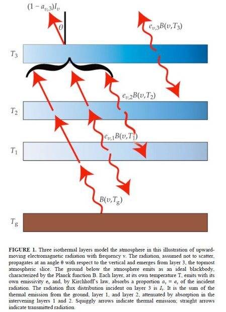

That's not sufficient. Lok at Figure 2 (d) on page 6835 in https://pubs.giss.nasa.gov/docs/1997/1997_Hansen_ha01900k.pdf. The radiative forcing increases the temperature somewhere in the middle of the troposphere. In the result the temperature gradient below this altitude is indeed decreased. But above it gets increased. If it was at the adiabatic lapse rate before, it should now exceed that limit and make the atmospheric layering instable. The resulting convection would decrease the temperature gradient and that would finally increase the gradient at altitudes below.
As the paper includes convective feedback this doesn't seem to happen. But why? Is the original temperature gradient in the upper troposphere below the adiabatic lapse rate? That would imply it is not convection dominated. Is that correct? I was under the impression that convections stop at the tropopause.

Finally the backradiation is not a process from the air to the surface but also a process occurring in the air, in the atmosphere itself. It explains why each layer of air cannot dissipate in the direction of space all the energy in excess. If I can quote Raymond T. Pierrehumbert:
At planetary energy densities, photons do not significantly interact with each other; their distribution evolves only through interaction with matter. The momentum of atmospheric photons is too small to allow any significant portion of their energy to go directly into translational kinetic energy of the molecules that absorb them. Instead, it goes into changing the internal quantum states of the molecules. A photon with frequency ν has energy hν, so for a photon to be absorbed or emitted, the molecule involved must have a transition between energy levels differing by that amount. Coupled vibrational and rotational states are the key players in IR absorption. An IR photon absorbed by a molecule knocks the molecule into a higher-energy quantum state. Those states have very long lifetimes, characterized by the spectroscopically measurable Einstein A coefficient. For example, for the CO2 transitions that are most significant in the thermal IR, the lifetimes tend to range from a few milli-seconds to a few tenths of a second. In contrast, the typical time between collisions for, say, a nitrogen-dominated atmosphere at a pressure of 104 Pa and temperature of 250 K is well under 10−7 s. Therefore, the energy of the photon will almost always be assimilated by collisions into the general energy pool of the matter and establish a new Maxwell–Boltzmann distribution at a slightly higher temperature. That is how radiation heats matter in the LTE limit [local thermodynamic equilibrium].
According to the equipartition principle, molecular collisions maintain an equilibrium distribution of molecules in higher vibrational and rotational states. Many molecules occupy those higher-energy states, so even though the lifetime of the excited states is long, over a moderately small stretch of time a large number of molecules will decay by emitting photons. If that radiation escapes without being reabsorbed, the higher-energy states are depopulated and the system is thrown out of thermodynamic equilibrium. Molecular collisions repopulate the states and establish a new thermodynamic equilibrium at a slightly cooler temperature. That is how thermal emission of radiation cools matter in the LTE limit. Now consider a column of atmosphere sliced into thin horizontal slabs, each of which has matter in LTE. Thermal IR does not significantly scatter off atmospheric molecules or the strongly absorbing materials such as those that make up Earth’s water and ice clouds. In the absence of scattering, each direction is decoupled from the others, and the linearity of the electromagnetic interactions means that each frequency can also be considered in isolation. If a radiation flux distribution Iν in a given propagation direction θ impinges on a slab from below, a fraction aν will be absorbed, with aν << 1 by assumption. The slab may be too thin to emit like a black-body. Without loss of generality, though, one can write the emission in the form eνB(ν,T); here eν << 1 is the emissivity of the slab (see figure 1). Both aν and eν are proportional to the number of absorber–emitter molecules in the slab. The most fundamental relation underpinning radiative transfer in the LTE limit is Kirchhoff’s law, which states that aν = eν. Gustav Kirchhoff first formulated the law as an empirical description of his pioneering experiments on the interaction of radiation with matter, which led directly to the concept of blackbody radiation. It can be derived as a consequence of the second law of thermodynamics by requiring, as Kirchhoff did, that radiative transfer act to relax matter in a closed system toward an isothermal state. If Kirchhoff’s law were violated, isolated isothermal matter could spontaneously generate temperature inhomogeneities through interaction with the internal radiation field.
Given Kirchhoff’s law, the change in the flux distribution across a slab is ΔIν = eν [−Iν + B(ν,T)], assuming eν ≪ 1. The radiation decays exponentially with rate eν, but it is resupplied by a source eνB. The stable equilibrium solution to the flux-change iteration is Iν = B(ν,T), which implies that within a sufficiently extensive isothermal region the solution is the Planck function appropriate to a blackbody. The recovery of blackbody radiation in that limit is one of the chief implications of Kirchhoff’s law, and it applies separately for each frequency. In the limit of infinitesimal slabs, the iteration reduces to a linear first-order ordinary differential equation for Iν. Or, as illustrated in figure 1, one can sum the contributions from each layer, suitably attenuated by absorption in the intervening layers. The resulting radiative transfer equations entered 20th-century science through the work of Karl Schwarzschild (of black hole fame) and Edward Milne, who were interested in astrophysical applications; Siméon Poisson published a nearly identical formulation of radiative transfer[3] in 1835, but his equations languished for nearly 100 years without application.
It comes from his conference paper titled "Infrared Radiation and Planetary Temperature"

Your guess is wrong. With 2/3 of the total influx at the surface the back radiation is the major contributor:

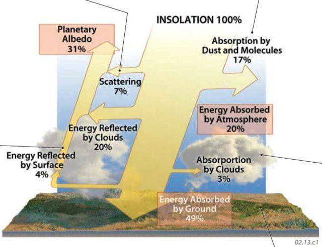

Interestingly, the site linked to by Hmmm27 above provides an explanation more along the lines of how I've always thought about it. In that explanation, the author writes that about 31% of all incoming insolation is reflected back to space, 20% is absorbed by the atmosphere and 49% is absorbed by the surface. 12% of total incoming insolation is radiated directly to space from the surface via the "atmospheric window". 30% of total insolation is then transported from the surface via transfer of sensible and latent heat. The back-and-forth exchange of radiant energy between the atmosphere and surface (back radiation) results in 7% of total incoming insolation being transferred into the atmosphere.
These 49% are just 1/3 of the total influx for the surface. The other 2/3 come from back radiation.
I think it is 7% of the total emission from the ground (and not of the total incoming insolation) that is being transferred into the atmosphere by back and forth radiation. Anyway, this is about the energy balace of the atmosphere. I am talking about the energy balance of the surface. The steady state temperature of the surface is important because it is the upper limit for the temperature of the troposphere. You can't explain the warming of the atmosphere without an explanation for the warming of the surface.
