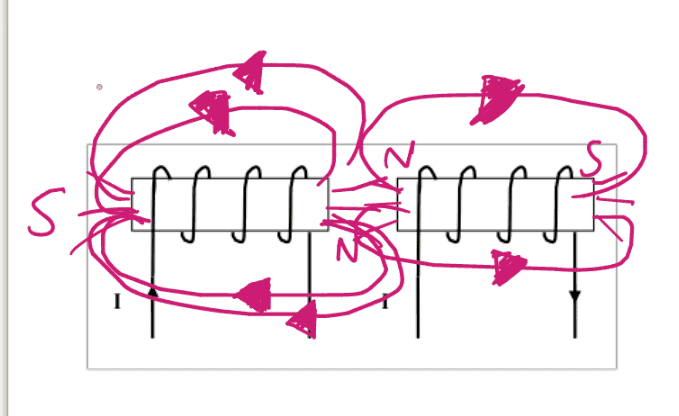

A current is passed through two solenoids placed in close proximity to each other as shown in the figure attached. Reproduce the figure showing the polarity of the two solenoids and the magnetic field pattern for the arrangement shown.
There isn't really an equation to calculate the answer.
I always try and attempt questions but literally if I tried to attempt this I would be guessing!
I made an attempt as a guess, better than nothing!
Look up the solenoid right-hand-rule. Are the currents in the two solenoids traveling in the same or different directions?
