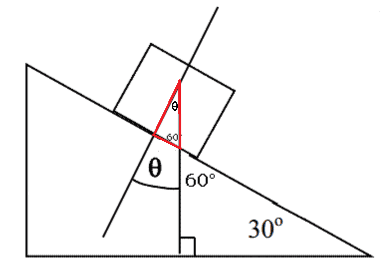

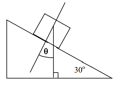

Solve for \theta
Unknown
I know, but I have forgotten my basic geometry.
Hello.
You have a good start with the 60 degree angle that you identified. Try working with the red right triangle in the attachment.
I wasn't sure if that was a right angle.
If so, then the entire problem was a piece of cake. If not, then it's more complicated than I thought.

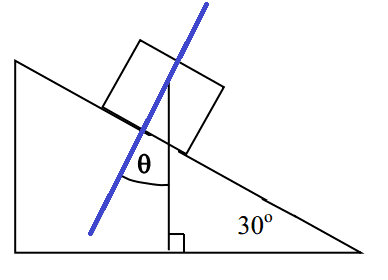

I did make the assumption that the blue line shown is constructed to be a "normal line" (i.e., perpendicular to the slope). That's the usual case when working inclined plane problems.
However, if it is not given to be a normal line, then you can't find θ without additional information.
