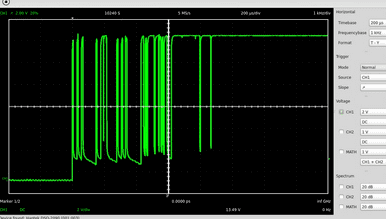

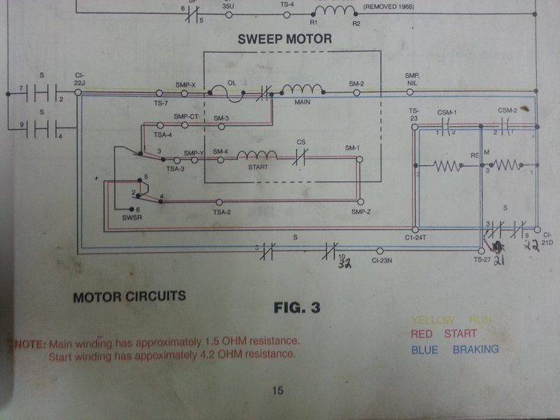

OK. Double-Break contacts with NO wired in parallel. Mis-read the schematic. No need for a marked up one.
With just one relay in the pinsetter, relative timing between relays isn't an issue.
The remaining possibilities are:
1) There is a large charge retained on the Start capacitors.
2) The relay being used has overlapped contact timimg.
3) The motor is still coasting.
[5) Ghosts or Gremlinso_O]
There just aren't any other power sources.
Can you hang a DC voltmeter on the capacitors to check for a retained charge during operation?
When a relay starts degrading, is there arcing on every operating cycle or just occassionally?

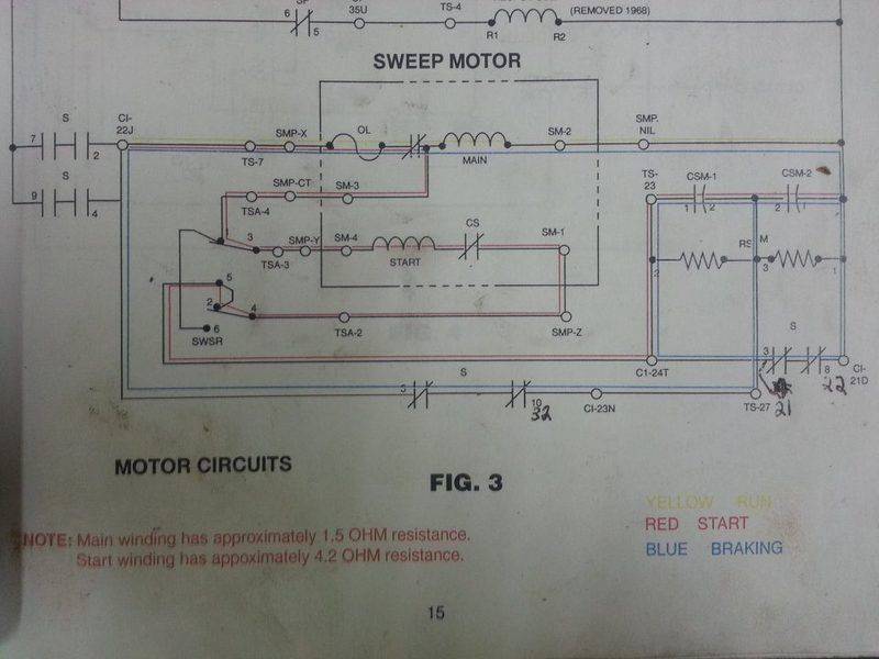

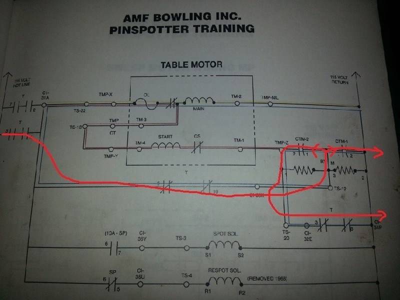

Hey Tom, There are two 4PST relays. One for each assembly of the pinsetter. Table is one assembly and the sweep is the other assembly.
The circuitry for each assembly is the same. Breaks down like this: The Table has two caps, one 625 ohm resistor and a 4PST relay.
The sweep has it's own two caps., one 625 ohm resistor and a 4PST relay. The arcing is every cycle. I will check the with a DC meter tomorrow when I go to work at 3 PM Thanks for the feed back.

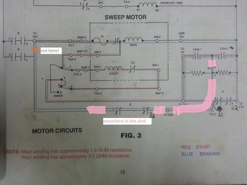

Here's another low-tech test
make yourself a coil about 4" diamter, 100 turns of #18 or so, whatever you have, just remember it has to carry braking current
Connect it here so braking current has to flow through it
now you have done two things
connected a tiny inductance in series
and given yourself a "poor man's surge detector"
six amps won't affect your coil
but if you are getting hundred+ amp surges from that motor, you'll feel your coil 'jump' as the wires push against one another from the sudden current rise
and that'll be a clue
maybe we can figure out how to put a better number on it.

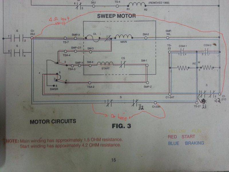

Thanks Jim yea sounds easy enough. You still want me to lift the wire at TS20 first before I try the inductor? It sounds as if all you guys are
on the same page in a round about way. Can I ask a stupid question? How come put my DC meter on the caps

Yea, counter-intuitive isn't it? With the motor and relay in the Stopped condition, the only place to store energy is in the caps, and they can't store AC. Ergo, if they are storing energy it must be DC.
The resistors across the caps are there to bleed off any stored charge. If there is a sustained voltage across the caps then the resistors are not doing their job. With the conditions you described, this would show up only after the relay contacts are damaged.
Another useful test is measure both the AC and DC voltage across the caps while the motor is running. Both AC & DC should be zero. If there is a sustained DC voltage, then the resistors are not doing their job. If there is an AC voltage then either the motor Start winding is not disconnecting, or the NC contacts at C1-33K to C1-31A are not opening.

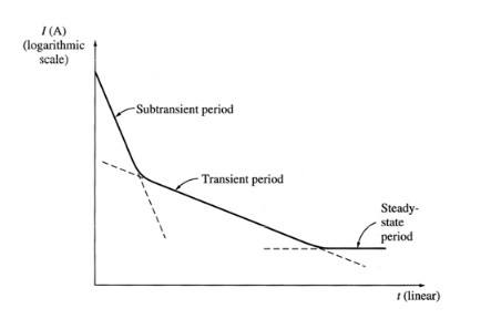

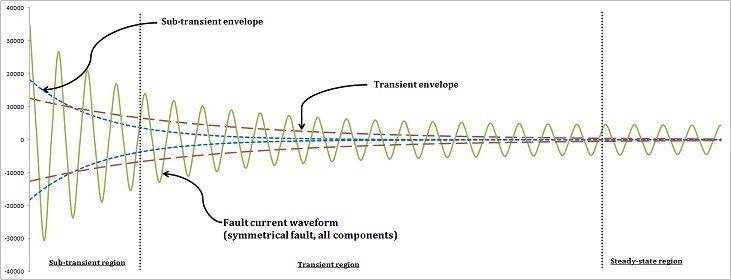

The initial braking current might be quite high .
The motor becomes an induction generator that gets very nearly shorted out by those 500 uf capacitors in parallel.
We think of those capacitors as 2.65 ohms of Xc, but that's at 60 hz steady state.
At the instant of NC contact closure the capacitor (if it's discharged) is very nearly a short circuit
so change your thinking from steady state 60 hz to millisecond by millisecond
Instantaneous AC is a lot like DC
if the voltage at motor terminals if high on the sinewave at instant T's NC contact closes, we have maybe 150 volts applied instantaneously to a discharged capacitor
and the only thing limiting current is the internal impedances of the motor and the capacitor (well, plus the wires)
We'd like to think current would only be as much as LRA , probably thirty amps or less
but the motor is likely capable of a lot more
i'm no expert at fault current calculations
so have searched for general info on induction motor fault current
http://ee.lamar.edu/gleb/power/Lecture%2012%20-%20Symmetrical%20faults.pdf
4/29/2010
Fault current transients in machines
It is possible to observe the three periods of fault current if the rms magnitude of the AC component current is plotted as a function of time on a semilogarithmic scale.
It is possible to determine the time constants for the three periods...
The AC current flowing in the generator during the subtransient period is called the subtransient current and is denoted by I”. This current is caused by the damper windings of synchronous machines. The time constant of the subtransient current is denoted by T” and it can be determined from the slope. This current may be 10 times the steady-state fault current
Fault transients in induction motors
An induction motor is an AC machine that has only damper windings on its rotor. Since damper windings are major source of current during the subtransient period, the induction motors in a power system should be considered during calculations of subtransient currents flowing in faults.
Since currents in a damper winding are of little importance during the transient and steady-state periods of faults, induction motors may be ignored in fault current analysis after the subtransient period
I believe your motor is capable of 100 amps of fault current for a fraction of a line cycle and that "subtransient current" may be what is wrecking your contacts..That much current will make an impressive arc like you report seeing .
Your clamp on ammeter will not report that transient, instead it'll average a few cycles and report that smaller number.
That transient is significant to the poor little relay contact though, because relay contacts don't just close and stay closed, they bounce for a millisecond or two.
Every bounce interrupts that subtransient current and makes sparks
after a few milliseconds the current settles down and the contact quits bouncing and the motor slows to a stop as intended.
Svein and TomG you guys pointed the way to this one
if it turns out this is the trouble the fix should be easy Limit subtransient current.
That 4 inch 100 turn coil i think should oppose instantaneous current rise , it's around 1.8 millihenries i think which is not quite 1/5th of the 10mh TomG measured on a similar size motor
TomG measured the motor's steady state reactance . Subtransient reactance will be several times smaller. So that coil might roughly halve subtransient current? It's hard to judge an arc, but maybe we'll be lucky and the difference will be noticeable. Again there'll be some randomness to it depending where in the line cycle the contact closes so watch several sweep cycles.
Hopefully we can play with combination of inductance and resistance to reduce contact arcing and still give desired coastdown.<<<<<<<<<<<<<<end hypotheses>>>>>>>>>>>>>>
If testing proves me 100% wrong, well, won't be first time !

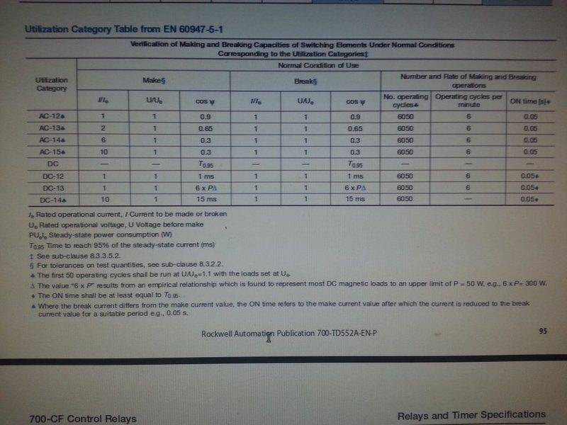

Rockwell sent me this. Must admit symbols are you guys expertise.
  • #60
Forgot to add that AC-15 is the line on the photo for my relay.
  • #61

II measured voltage at caps.Idle is zero running is 35 vac and 6.57 vdc

<<<<<<<<<<<<<start hypothesis>>>>>>>>>>>>>>
sanity check :
TomG measured 10mh
which at 60 hz is 3.77 ohms, 120 volts / 3.77 ohms is 31.8 amps and HO12 reported 29
If X'' is 1/10 of Xsteady state, then X'' is ~0.3 ohms
and our 1.8mh coil is 0.69 ohms ..
What will be rate of current rise through our 1.8 mh coil and (guess at motor's subtransient reactance of ) 1 mh X'' ?
E = L X rate of change of current
so rate of change of current = E / L
without coil 150V / 1mh =150 amps per millisecond
with coil 150V / 2.8mh = 54 amps per millisecond
we might need a core...
maybe a ferrite toroid from an old CPU power supply?
What do you guys think ?old jim
ps make sure all the turns go same way on that coil - don't use lampcord with the two wires twisted together at far end, that cancels the inductance
old jim
Hey Jim all I have enough of is 18 ga. stranded

I wondered why I was a little confused. I have misled you guy,not on purpose though. the schematic I gave in photo is for the table we need the sweep. only difference is a toogle switch circuit for reversing the sweep. If you still want me to continue with the test I will.

  • #66
Sure, continue on
do i see terminal numbers are a little different on sweep than table ?
if you want to use sweeps chematic that's fine, i'll save that drawing
i do note different terminal numbers?
I will use them hereafter unless you say otherwise.
Idle should be zero, everything is de-energized and shorted by the motor windings
running reading is curious though
35VAC across a 500 uf capacitor suggests by ohm's law 5 amps through it which had to flow through open contacts to get there
and 6.57 volts DC suggests the resistor is open
this always happens when first start troubleshooting, you get readings that don't make sense
usually their meaning comes clear later on after you've double checked enough stuff to figure out what's different between the way you imagine the circuit and the way it really is.HO12 - do you see why I'm confused by those meter readings?
Which motor were we reading - Sweep or the other one?
Are the terminals marked on the chassis ? Or do you have to find them from a drawing ?
On what terminal was the meter's + lead ?
On what terminal was the meter's - lead ?
All terminal blocks look pretty much alike.. Is that resistor unmistakeable?
Voltage between resistor ends, 1 to 2 on drawing, running __________ VAC ____________ VDC
Voltage centertap to end , 3 to 1 running ____________ VAC __________VDC
Voltage centertap to end , 2 to 1 running ____________VAC ___________VDC
@Tom.G & @Svein Any thoughts?
old jim
  • #67
If the hardware matches the schematic AND you are using an Analog meter:
Two definite (and maybe a third) concurrent defects:
1) Centrifugal switch in motor is not disconnecting the Start winding
2) At least one of the caps is defective
3) Maybe a bad resistor
A current measurement, while running, on the wire between C1-24T and SWSR-5 would be a big help in clarification.[/color]
Likes jim hardy

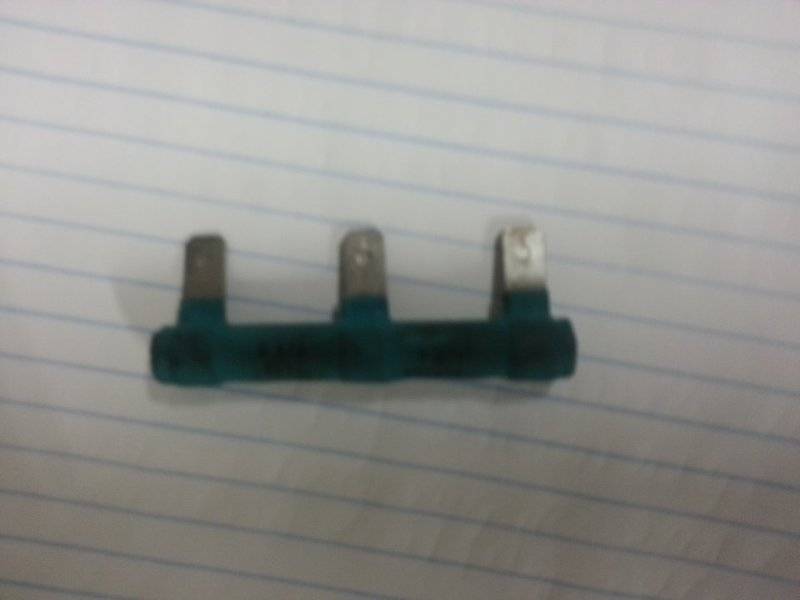

This is the resistor. There are two of these One is for the table and one is for the sweep

  • #72
H012 said:
It takes me a while to do readings I'm solo working 26 machines.
I'm sorry to be such a pest
just English is so imprecise and i can only imagine how you made the measurement.
Thanks for the expansion , i'll quote it
H012 said:
this with motor running. this reading only occurred milliseconds when motor started to run
AHA That's what it SHOULD do , appear until CS opens then disappear. Caps are in series with start winding until motor gets up to speed
at which time CS disconnects them
so voltage during motor acceleration is proper
and voltage should drop to zero as soon as motor reaches speed and remain there while motor runs
Voltage should return when relay T connects capacitors to motor run winding to decelerate itthen as it's running quickly drops off till the motor stops.
That sounds right.
A reading across capacitorsduring deceleration would cross check your 29 amp reading of a few days ago
29 amps through 1000 uf should make 76 volts
Thanks !
Looking forward to your coil thump test.
Got any neon indicator lamps around ?
Tom - you copy ? Red parts Sound right ?
old jim

Arcing is on motor stop
NO contacts open on motor stop
NC contacts close on motor stop
it's NC contacts that burn up
so if the arcing is on the contacts that open on stop, it's not on the contacts that are burning up
you're right, I'm focused on the NC contacts
the NO contacts might make a more impressive arc but if so it doesn't appear to be hurting them.
Thanks ! That was one more presumption on my part, that the visible arc was wrecking the contacts,, and "it ain't necessarily so..."

jim hardy said:
Just to make sure we're hearing each other
When motor starts you get 22AC and 41 DC but only very briefly ?
then as motor reaches speed , voltage quickly drops off, i presume to near zero but would you confirm or correct me on that ?
Most troubleshooting mistakes arise from presuming what somebody meant to say.
If that's what you saw , brief voltage during start return to near zero, it gives me confidence the circuit is as i imagined it.
Voltage should return while motor coasts down in braking cycle
because capacitors get switched back in by NC contacts on S relay
Aha now relay names Table and Sweep make sense ...
Precision in communication sure is tedious, isn't it ?
But it feels so good to arrive !
Thanks for your work i think we are progressing nicelyold jim

Can you see how sparking at the NO contacts compares to sparking at the NC contacts?
On motor start
there shouldn't be much sparking, just contact bounce on the NO's as they conduct motor starting current, maybe thirty amps
the NC's open then but they aren't carrying current so no sparks on them
but on motor stop
there'll be a spark at NO's as they open interrupting motor running current of probably six amps
AND some spark at the NC's as they close and bounce with whatever transient current the motor is pushing through the capacitors...
... if your coil 'jumps' it means that transient current is substantial
dont know yet how to measure it
but maybe we'll just try to suppress it...

I still think our trouble stems from closing a switch(NC contacts) between a power source(motor) and discharged capacitors(those 500uf's)
the surge current is less than i thought else it would have shaken your coil
but it flows through contacts that are in the process of closing and aren't fully made

Switch Bounce
As a switch changes state, its contacts travel through several open-close cycles called "contact bounce"
before coming to rest in the final state. In some cases, this rapid contact bounce produces a changing
resistance as the moving contact wipes across the stationary contact.
here's a 'scope trace(from a different source) of contact bounce on closure - each bounce makes an arc
typical bouncing time is about a millisecond
contact separation on opening is much cleaner

think of your motor as a generator and those capacitors as its load. Capacitive inrush is i think our trouble.
What's the "make" current rating of that relay contact?
http://www.aeroelectric.com/Reference_Docs/Tyco/Tyco-Relay_Contact_Life.pdf
Material loss is due primarily to splattering of the molten and boiling
metal as contacts bounce on make. Such loss can be significant over
the course of tens of thousands of operations, and the only practical
way to minimize it is by arc suppression. Arc suppression quickly
quenches the arc, thereby holding contact temperatures lower.
so i'd like to limit the inrush to those capacitors
do you think we could experiment with some impedance where we showed it, and see if it slows the coastdown too much ?
Inductance has the appeal of elegance, but i do suffer from idealism
two or three ohms of resistance might do the trick
as Svein and Tom.G have suggested
@Tom.G thoughts?

If you look at post #59 JPG go down to line AC-15 This gives the Make/Break of contacts. I will go down to the local to local electronics store
and pick up some resistors. I think Svein suggested 8 ohm 50 watt I will see what lower resistance ones they have. I loved Radio shack back
in the day. I could get anything for electronics. Thanks guys!

Paralleling two 8's makes a 4, three a 2&2/3, etc
There's some number of ohms that'll slow the coastdown enough to upset the mechanical timing
when you try one measure the voltage across it , initial when NC contacts close.While you're there, pick up a motor run capacitor, maybe maybe 10 uf, not critical should be cheap i bought a 10 yesterday for $3.
We never established unambiguously at which contacts you see the arcing on motor stop - middle NC's or outside NO's ?
If you can see arcing on NC's when they close , we at least have a visible indication of any improvement we make.
Might be worth trying to limit rate of voltage rise across motor in interval between NC's open and NC's close, also during contact bounce time
that'd be your motor run cap in red... resistor sees 1/4 amp continuous so should be a couple watts to stay cool

just noticed
Aha 1.5 ohms main winding ? We should be able to add at least that much which could halve your surge current
question is what's max we can add before motor coasts too far? We have to stay well below that.
Figuring Inductance is a little tougher, we'll have to estimate how many volts it has to hold back for how many microseconds.
If we say it only has to hold off 150 volts for a millisecond while contacts stop bouncing
and limit current rise to 30 amps while that millisecond elapses
then we have di/dt = 30 amps per millisecond = 30ka/second
at 150 volts
e = L X di/dt
so
L = 150 / 30,000 = 5 millihenries
we were perhaps ⅓ of the way there with your 100 turn coil
and 30 amps wouldn't have shook the coil very hard
did you notice any change in sparks ?
Thanks - they tested it at 10X rated current for 6050 cycles, ten cycles per minute is how i read that.
How long does it take you to accumulate six thousand cycles? Do they have counters?

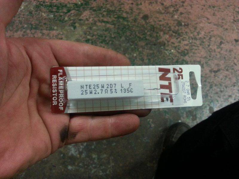

Jim I have 3 of these. 2.7, 3.0 and 8.2 25% The 50 watt were outragous in price not to mention their size.
  • #93
I will check I have some run caps not sure of their capacitance
  • #94
Since they only carry current during coastdown they can be less wattage than 6 amps continuous would require .

That's how my wife JoAnn and I feel too. Had enough raising kids and yes the rat race
Too. Anyway got a full house here at work. I will try later to get the resistor in. Got to solder 12 inch wire on each end off resistor
To reach into wire duct.
Likes jim hardy
  • #98
What's the "make" current rating of that relay contact?so i'd like to limit the inrush to those capacitors
@Tom.G thoughts?
Hey Jim can you help with the resistor location. The C1 33 to TS 12 is the table. Could you show where using the sweep schematic?. Thanks
  • #99
somewhere in the pink line
in place of that wire from C1-23N to TS-27
or C1-23N to whichever terminal that is on the S relay, 10 or 32
Schematic shows a wire between relay S terminals 2, 4 and 5
that could be a convenient place if you can see clearly how they accomplished their wiring,
just be careful , you don't want it on the wrong side of terminal 4 !
if there's a single wire on 5 find its other end, hopefully it's a short jumper to 4&2. ( with a single wire from one of those to C1-22J , that's how i woulda done it. )
even between junction of capacitors and centertap of resistor would be okay
schematics don't look a lot like the physical machine, do they ... Got a cellphone picture of it you could upload ?
old jim
