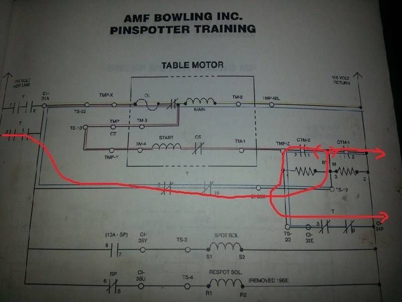

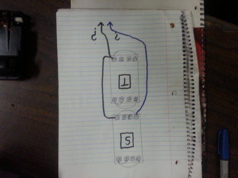

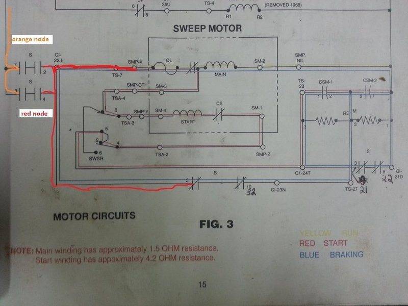

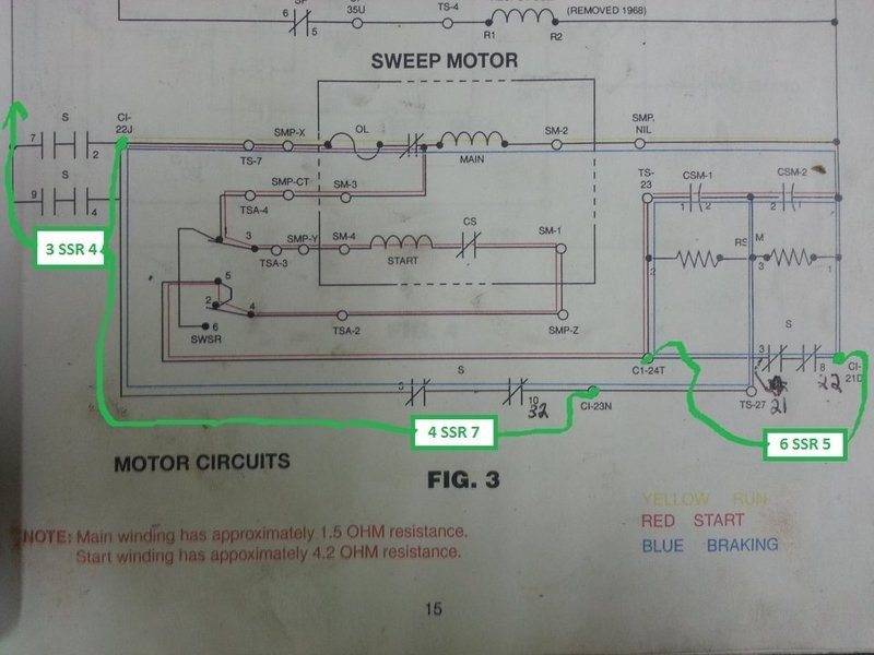

jim hardy said:
somewhere in the pink line
in place of that wire from C1-23N to TS-27
or C1-23N to whichever terminal that is on the S relay, 10 or 32
Schematic shows a wire between relay S terminals 2, 4 and 5
that could be a convenient place if you can see clearly how they accomplished their wiring,
just be careful , you don't want it on the wrong side of terminal 4 !
if there's a single wire on 5 find its other end, hopefully it's a short jumper to 4&2. ( with a single wire from one of those to C1-22J ) that's how i woulda done it.
even between junction of capacitors and centertap of resistor would be okay
schematics don't look a lot like the physical machine, do they ... Got a cellphone picture of it you could upload ?
old jim
Hell no! It doesn't look close HaHa. Never does. Bet you've seen your share of wiring
Nightmares. Yes I will get a picture not sure if I can fit it all in one picture.

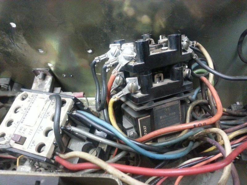

@H012 When you get a chance, would you tell us the make & model of the old style, open frame, relay that was originally in the circuit? We are still trying to track down some ambiguities/inconsistencies into the root cause(s) of your problem. Thanks.
  • #103
I have no idea what the model number they are. I can look on one when I go to work today at 3 pm. These relays are obsolete and I'm phasing them out as OSHA won't allow any open frame design be used unless it's a totally enclosed, which in the case of the chassis on the machine that has the relays is not enclosed. I will send a photo also. I know they are Allen Bradley. Thanks
  • #104
I am concentrating on the sweep because the sweep starts and stops 3 times unlike the table which starts and stops once. If you would be interested you can go on you tube and search AMF 8270 or 8290 pinspotter I'm sure you can see how it functions.This would be just FYI
  • #105
They are Allen Bradley 700-C220X10

  • #106
if there's a single wire on 5 find its other end, hopefully it's a short jumper to 4&2. ( with a single wire from one of those to C1-22J , that's how i woulda done it. )
old jim

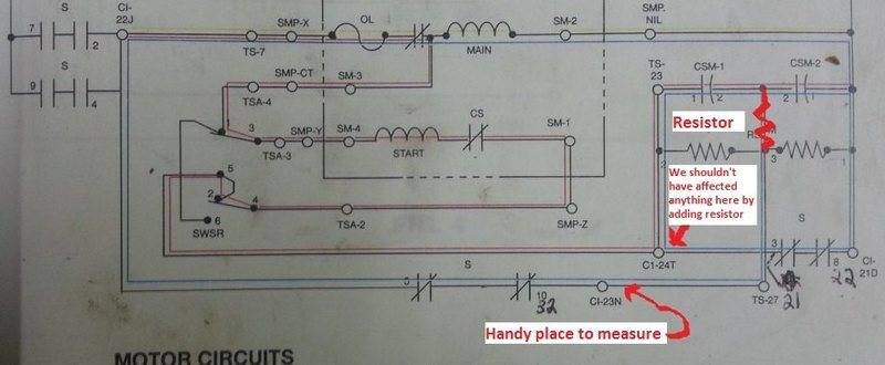

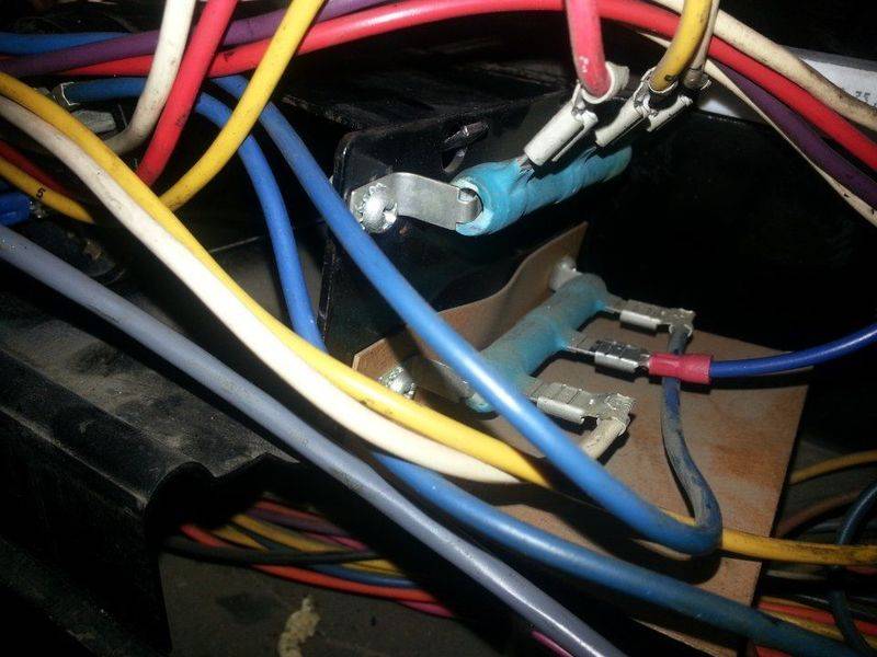

OK Jim put 8 ohm resistor in place between cap and resistor. Braking unchanged it's OK
Voltage at C1 24 and return unchanged voltage drop off is still quick when running

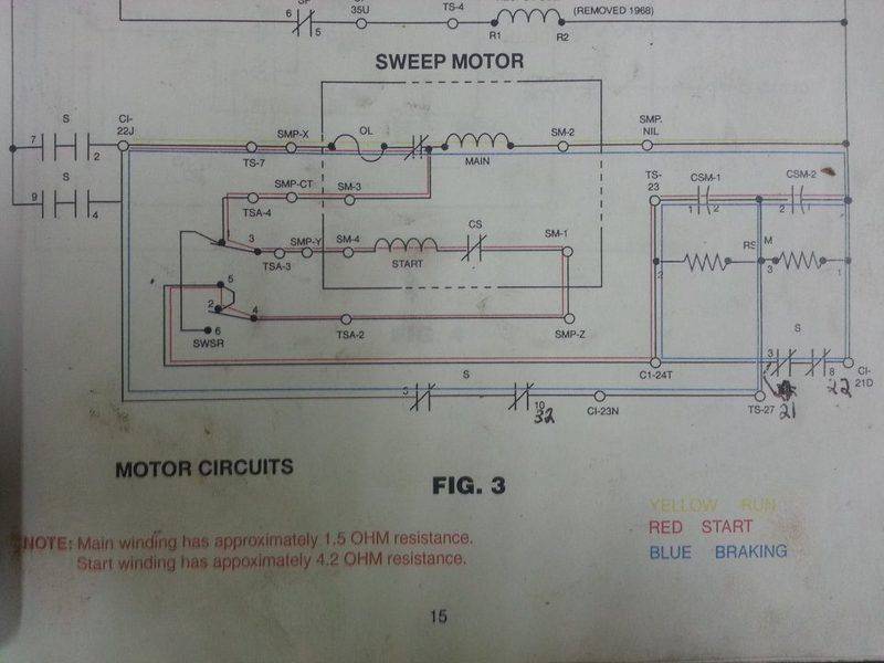

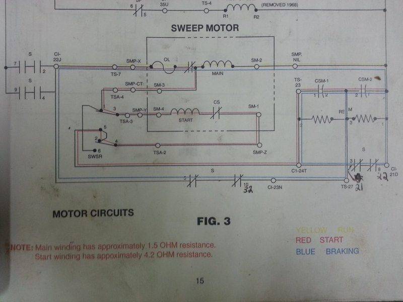

  • #107
Did i draw it in the right place ?Braking unchanged it's OK
That bodes very well , and i must admit to mild surprise bur tremendous relief
Okay, take a look we'd expect no change there

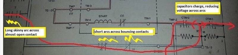

During braking, motor's main winding current flows along blue line into new resistor then splits. half going through each capacitor to 115 return.
The half that turns right into CSM2 has a straight shot out other side to 115 return
the half that turns left into CSM1 meanders back through C1-24T then contacts 3-8 of S relay to 115 return.
If i understand the circuit,
Voltage at C1-23N should behave like this
At motor start it will jump up to the 22 VAC/(41DC?) you measured in post #70
(question mark on DC reading is because i think it should be random how much DC you see there, if it's always 41DC i don't understand why (but that's not unusual ) )
then it will drop to zero as soon as motor reaches speed causing CS to open
when STOP signal de-energizes relay S
allowing its NC contacts to close
voltage will return to C1-23N , and the amount will be whatever the motor makes as an induction generator. That voltage will fade as energy id drained from the motor's inertia.
The resistor should affect rate of energy drain from motor, but how much ? I don't know(the 3 words men fear most).
That resistor HAD to lower the instantaneous current flow into the capacitors, making life easier for your NC contacts.
Since we don't have a 'scope with transient current capture, and my coil didn't tell us anything, we're flying kinda bindIf you can get a reading at C1-23N during a motor braking cycle, we'll divide that by (8 - j 2.65) and figure the amps during braking. (8 is the new resistor you inserted in the circuit...? )
I'm dying of curiosity how much current flows and for how long
That won't tell us the initial current spike but it gives a clue about the motor's behavior, i never did any such experiments and find this interesting
I would suggest
Write this experiment down and put a note inside the machine for the next guy so he'll know what you did
put in a new relay
Surely you know what is average life of these relay contacts?
After say 2/3 of that life, take that relay out and see if we've slowed contact erosion ?
Svein? Tom.G ? Thoughts ?
Kudos to both of you guys , this just might work ! I thought for sure we'd extend coastdown time and de-synchronize the machine.
Keep our fingers crossed this machine runs okay with the extra braking resistor.

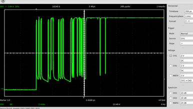

Do you guys have access to a storage oscilloscope ? A photo of voltage trace at C1-23N during braking would show rate of current rise. You'd want two, one showing the whole coastdown and another showing first half cycle.

I did see the picture of the two relays - one is a siemens-allis ?

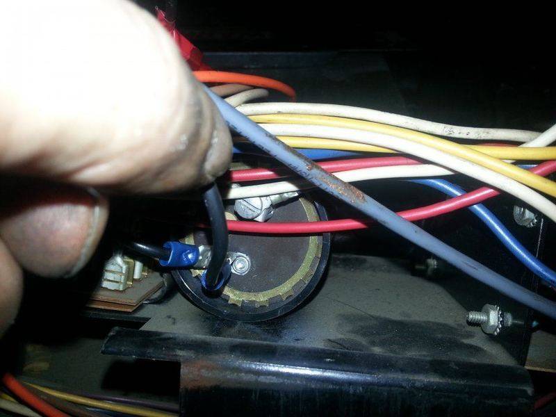

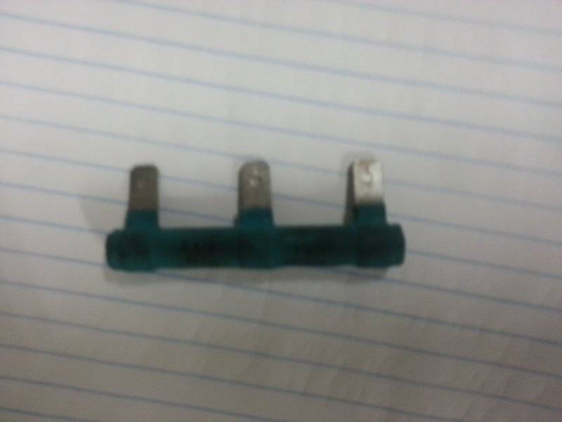

One pic is resistor and the other pic is wire to cap. Got to stuff everything into duct.
  • #112
Did installing the resistor have any effect on the contact arcing?

  • #119
hmm top resistor is table and bottom one sweep ?
  • #120
Yes bottom is sweep

I am positive the reason the SSR fail so soon on these machine is the repetitive cycling of the machines when we are busy average is about 15 seconds and the lack of adequate heat sinking on the MOSFETs is the problem.
  • #122
Tom.G said:
If you zoom in on this photo from Post #7, you will note at the left contact that the substrate metal is discolored from overheating. That would indicate either low contact pressure (faulty relay), contanimints (oil or particulate matter) or significant overcurrent. For arcing to cause that, there would have to be sustained arcing or highly repetitive arcing.
Side comment:
Many years ago I was on a project for electric trains, not the toys, the big ones like subways and rapid transit. At one point we had a batch of relays that would quite literally explode on contact closure. Close them into an 1200A load and there was a fireball and shrapnel everywhere. These were typical open frame construction with a return spring to open the contacts upon removing coil power and the movable contacts spring loaded on the armature. I finally tracked down the difference between the 'good ' and 'bad' batches to the spring that mounted the movable contacts on the armature. The bad batch had a weaker spring, hence lower contact pressure. Of course the relay mfg. was "informed." After a few days the mfg. reported back to us that it was an inventory problem on their part. Somebody and put the the wrong springs in the parts bin for that assembly line. I always wondered how many pieces were in that batch!
I have on many occasions taken one of these enclosed relays apart to see the nature of the NO failure. The spring on any brand relay contact of the class that are used in these machines are very light. The contact just pivots on the one spring. Would definitely be better if there was a spring on each end of contact, but that's my opinion
I'm electrical engineer. I can understand more how contact bounce can occur. Or just not able to be firmly mated to the other contact.

guys some speculation here, followed by a question...
i've been obsessed by the thought the contacts are being eroded by current from the motor
and have tried to operate the braking sequence millisecond by millisecond in my head..
loooking for a relay race between the NO contacts opening and the NC contacts closing
it is necessary for the NO's in upper left to clear before the NC's below close , else we have a near dead short across the supply as shown in post #43
what if... entertain this thought experiment for a moment ... HO12 answered this long ago when he said
H012 said:
The only fact I know is that the NC arcing occurs when they open, only because I can see it.
when what opens ? The NC's or the NO's ? We established by test that there's no current through the NC's when they open by measuring voltage at junction of the two capacitors if i understood. It drops to zero after motor starts and remains so until braking.
So if the arcing is observed at braking time when the NO's in upper left open, that's not surprising because they are interrupting motor current and it's an induction motor.
Anybody who's arc-welded knows an arc can persist surprisingly long
so in the thought experiment, think millisecond by millisecont from the instant the S relay plunger starts to travel to de-enegrgized position
1. NO contact opens a ten-thousandth of an inch establishing an arc
2. NO contact continues its travel, arc gets longer
3. NC contact makes initial contact , connecting motor to capacitors which are nearly a dead short
4. Current through NC contact consists of current from motor plus any leftovers from the arc - at this instant NC does not yet have full contact pressure so some melting might occur
5. NC that's NO contact continues widening its airgap, quenching the arc (sorry for the mistake :mad::mad:):frown:
6. NC contact establishes full contact pressure and commences to cool whatever metal was melted in 4.
Now here's the speculation
Which comes first ? 4 or 5 ? If NC makes before NO has extinguished its arc, we have a short across supply through a not quite extinguished arc and a not well seated NC contact that's still bouncing... see post #87
Is that scenario plausible?
so the relay race i was looking for isn't contact vs contact mechanical travel overlap but contact travel vs arc quenching time overlap.
How does energy deposition between two arcs in series divide?
Is this plausible, guys?
If so, a snubber across motor as in post #89 might help NC NO quench the arc before NC makes.('nother durn mistake :mad:)
That old saying, before you figure out what it is you'll figure out a lot of things it ain't.
If the SSR is SCR based and can't turn off the NO contact until a current zero crossing happens,
then there's an interval where it connects 1000 uf right across the line which could be a bodacious surge.
Looking for holes in that line of thinking
and any thoughts on how to test for it.
old jim
  • #124
okay i apologize if i seemed to be talking down, that was not my intent
i think in simple steps and it's the only way i know to communicatedo you guys have an oscilloscope?
If you get a chance , see how much current we get on coastdown (volts at resistor or capacitor centertap?)
and a sanity check on my previous post ? we crossed in the mail.
old jim
5. NC contact continues widening its airgap, quenching the arc
If so, snubber across motor as in post #89 might help NC quench the arc.
old jim

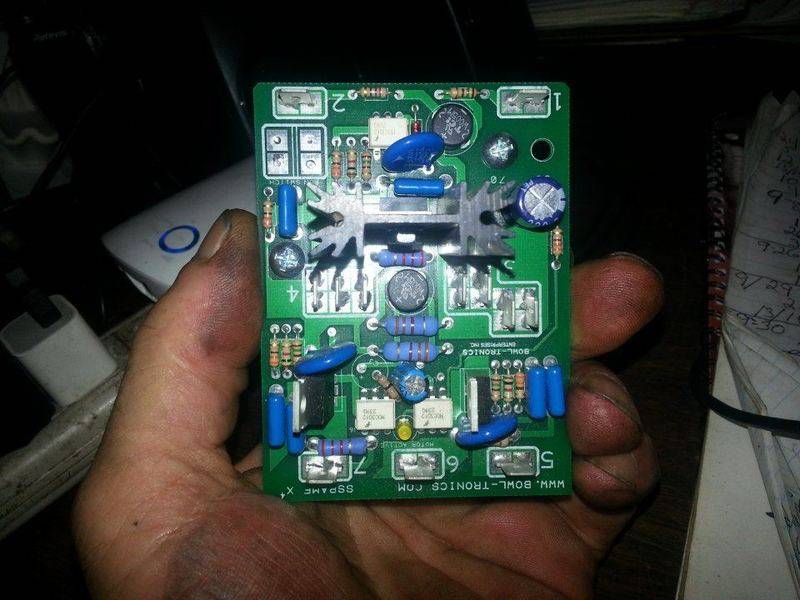

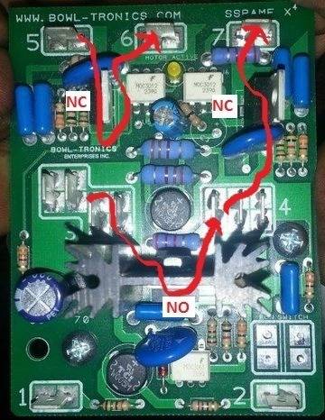

Here is a pic. of a SS relay (bad)

then look at ss relay picture thanks !

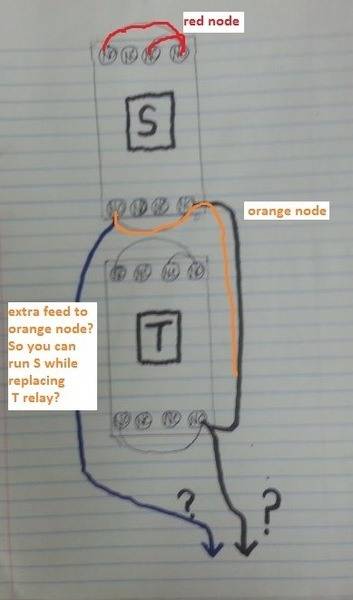

Jim I found this doesn't match schematic.Iook at pic. I tried to upload pic site won't let me Do you have Gmail?
  • #128
I got it to upload. Jim the black and blue wire are both coming from same hot at all times terminal strip in wire duct? Am I dumb!
  • #129
still trying to figure out that SSR
Mosfets. Hmmm
the little white MOC3012's are optocouplers ,
http://www.ti.com/lit/ds/symlink/moc3009.pdf
probably they make gate drive for whatever are those big power semiconductors ?
Do those have a part number ?
I'm a little behind you HO12...

  • #130
Mosfets. Hmmm
check your "Inbox" button at top...
I will look at PN# at home can't see it without magnification. Thanks
  • #131
gotcha. Can you tell any difference in arcing ?
not at all, just learning the details of your machine.
Machieavelli says a good prince knows not just every hill of his princedom , he knows every rock and every shrub on every hill of it. See my avatar...
  • #132

I lost track of something here. If the removed Black wire refers to the sketch showing Black and Blue duplicate feed to the S and T relays, that shouldn't make any difference if the schematic matches the real world.[/color]
HEY GUYS, THAT REDUCED THE ARC TEMPERATURE BY 1000 TO 2000 DEGREES C. On the right track!

ref Post #132I lost track of something here. If the removed Black wire refers to the sketch showing Black and Blue duplicate feed to the S and T relays, that shouldn't make any difference if the schematic matches the real world.
ref post #129
@jim hardy
TRIACs.
Exactly my thoughts. That's why I took it out.
Because it didn't match. When I leave here I want whomever not to have guess. To what it's supposed to be.
  • #137
At least we agree that as a wire just in parallel with another wire, it shouldn't make any difference. Sounds like it wasn't just in parallel. Tracking down where things are really connected may find other anomalies or the root cause of the relay arcing problem.
Unfortunately in the real world, we sometimes have to go with what works and move on.

Did the arc get less intense? White and small vs blue and big? Resistor ought to do that.
I never did get it real clear whether you can see arc on NC's or NO's or both...
If you have that motor run capacitor, tack it across motor main winding and see if arc changes. Dont leave it there without some resistance in series,
but if it makes arc smaller take a look at this product
http://www.digikey.com/product-sear...t=0&page=1&quantity=0&ptm=0&fid=0&pageSize=25
http://www.cde.com/resources/catalogs/Q-QRL.pdf

I like to understand a machine before i tinker with its design , that's all...

As I stated the arcing at NC was a blueish white now it,s just white as far as intense
I can't really tell the arc happens so fast. There is a few relays that the NO do arc but these relays have some age one them. Jim I had looked into the QuechArc but the formulas are over my head. I,m still going to get the run cap and try it. Thanks I will let you know.
  • #142
Ahhh it's at the NC - Thanks !
Since we don't have a peak capture ammeter or o'scope your observed intensity is our measure. Those Quencharc equations do look scary
Had you needed instead to protect the NO contacts from arcing when they open, the approach i use is this simpler one
...objective is to give the load current a path into a capacitor ( instead of through the contacts) for those first few microseconds while the contacts separate those first few thousandths of an inch
that way the inductive kick charges the capacitor instead raising the voltage enough to strike an arc
just like points in a car ignition are protected by the condenser
the car ignition uses around 0.22 uf for coil current of maybe two amps, ~ 0.1 uf per amp
what rate of voltage rise does that give ?
i = c X ΔV/ΔT
2 = .22 X10-6 X ΔV/ΔT
ΔV/ΔT = 2/.22 X10-6 = around 9 volts per microsecond
.1uf per amp would be 10 volts per microsecond
and that seems to protect the contacts in automobile points, which cycle a few hundred times per second
your six amp motor by that criteria, 0.1uf per amp, would get about 0.6 uf
so i just picked a Quencharc with a little more capacitance than that
and lowest resistance they offer
because the voltage across that resistor appears across the contacts and 6 amps X 22 ohms is 132 volts at instant of contact opening,
a lot less than the full inductive kick would make.
Hope that helps in your next relay adventure ...
old jim
