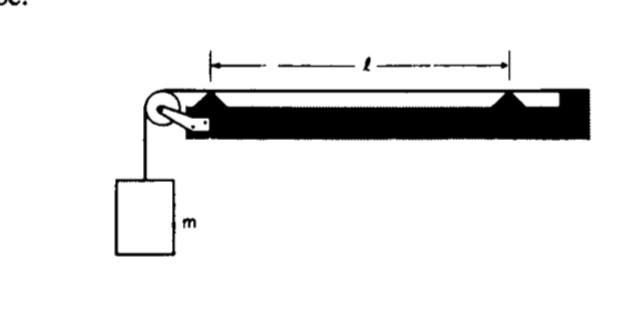

I'm just trying to solve this problem. Here m is the mass of the block, not the sonometer band. I'n supposed to get a number, but I keep getting an equation with 2 constants, one of which is linear mass density( which I want to find), while the other is wavelegnth. I made an assumption that the wave was periodic in soace and time, and that its frequency is the same as the frequency of the sound waves it produced. I'm not sure of any of those two assumption, and even when making them J still can't figure out the solution. Any insight?

I think you can assume that the sonometer wire vibrates as a standing wave in the fundamental mode. Do you see how to determine the wavelength of the standing wave in terms of the distance ##l##?
