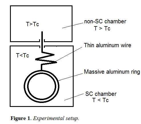

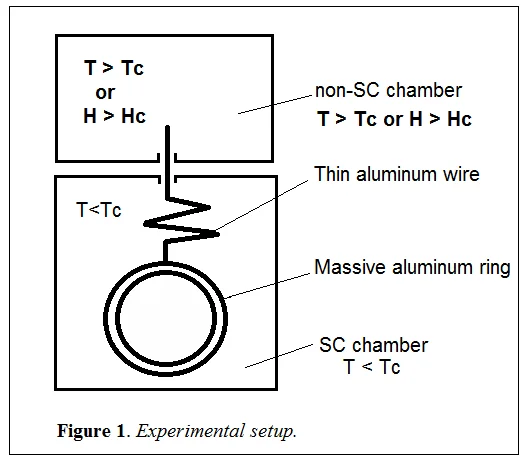

Thanks for clarifying! So the lifetime experiments are still proposals - that makes sense. It's indeed surprising how little work has been done on systematic decay measurements, given how fundamental they are.
Regarding your macroscopic rings (20 mm / 10 mm) - that's interesting because at those scales, you're firmly in the regime where my framework (TCTQ) predicts topology becomes negligible. The crossover scale d_c ~ 50-100 nm means topological effects only matter for nano-scale structures.
But here's where our perspectives might connect: you're asking about *pair permanency* (whether the same electrons stay paired), while I'm asking about *topological protection* (whether the pair wavefunction has conserved quantum numbers).
These might be related! If pairs have non-trivial Berry phase (topological winding number c₁ ≠ 0), then the phase coherence is protected by topology - not because the literal electrons are "permanent," but because the wavefunction can't continuously deform to the normal state without closing the gap.
**A concrete test to distinguish our frameworks:**
Your "permanent pairs" picture predicts that decay rate τ should be:
- Independent of ring size (if pairs are truly permanent)
- Sensitive only to defects/temperature
My TCTQ predicts:
- τ(d) ~ exp(E_top/kT) where E_top ∝ 1/d²
- Strong size dependence below d_c ~ 100 nm
- Negligible enhancement for macroscopic (mm-scale) rings
So if you measure τ for rings with wire diameter varying from 50 nm to 10 μm, we'd see:
- **Your prediction**: τ roughly constant (pair permanency is intrinsic)
- **TCTQ prediction**: τ enhancement only for d < 100 nm
This would definitively test whether topology matters for macroscopic currents!

  • #52
maxpi said:
have you considered doing time-resolved measurements?
Would be interesting to do that. When the DC transport experiments confirm the expected current decay, then the time-resolution can clarify more details about the matter

  • #54
The local states on BZ edges are large (~100 atoms), so nm-scales would disturb the large standing waves. Moreover, the interference of electron waves in the restrictions smaller than ~100 atoms will create fully new local states. My experiment proposal is rather about usual macroscopic effects in SC with local states not restricted by sample size, or restricted only in c axis as in experiments with 2D-Al .
