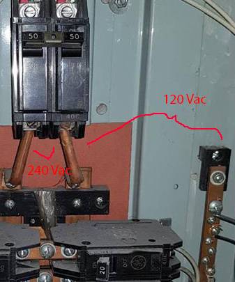

The installer returned asap to put the cable clamp (although I think the term is more like tube protector?).
I noticed the wires running from the top to the circuit breaker is about 1 foot. I think the requirement is it should be 6 inches or the VPR would increase? Need to check computation so can let installer make changes to the orientation and wire length.
Anyway. After some pondering... it seems the lower clamping voltage of 500 volts in the white strip surge protectors is equivalent to the higher clamping voltage of the SPDs of 1200 volts. This is because the former uses UL 1339 3rd edition test vector of 6000 volts but only 0.5 kA while the latter test uses UL 1339 4rd edition 6000 volts and 3 kA.. 6 times more... both test still use the 8/20 µs surge pulse.

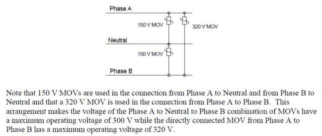

so the 1200 volts is a new standard.. but won't it damage 220 volts equipments.. let's compute... Rive.. more reference welcomed.. thanks..

Got a point. So I scheduled the installer to remove the extra metal box and put the SPD right inside the main panel with only 2 inches of lead wires... do you know the formula why impedance can increase the voltage?

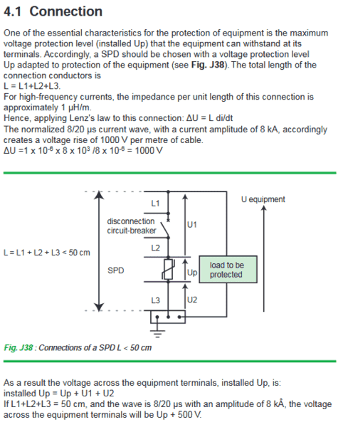

kiki_danc said:
If the leads from the SPD is short.. the Up (voltage protection level) is lower.
The linked picture is about the characteristics of the SPD: that Up is measured on the terminals of the SPD. But since you will use the SPD in an assembly, you have to care about the Up of the assembly (mentioned as 'installed Up'), what will consist of the Up of the SPD and the voltage drop on the wires. About the voltage drop on the wires there was a shortened calculation (with the laws mentioned) on the attachment of post #35

Also, the previously linked document has some wiring/placement suggestions too.The linked picture is about the characteristics of the SPD: that Up is measured on the terminals of the SPD. But since you will use the SPD in an assembly, you have to care about the Up of the assembly (mentioned as 'installed Up'), what will consist of the Up of the SPD and the voltage drop on the wires. About the voltage drop on the wires there was a shortened calculation (with the laws mentioned) on the attachment of post #35
The attachment is very clear that "As a result, the voltage across the equipment terminals, installed Up, is: installed Up = Up + U1 + U2... " and "... the voltaqe across the equipment terminals will be Up + 500". So longer wires can result in high Up in the installed terminals and UL recommends using very short lead wires. Why do you keep saying the Up will be lower if longer wires or voltage drop??

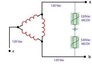

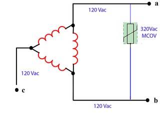

Let me clarify something:
The above was describing the fact that longer wires cause greater Up or VPR. Yet Tom.G and Rive spoke of voltage drop in a third SPD about 10 meters away from it. Can they or others confirm that they were describing separate fact not being described in the above image? This is important to me because I may do both: Shorten the wires between SPD and breaker and add a second SPD 10 meters away right at equipment (but it's more expensive than the one I bought so need more hard facts). The following graphics showed that shorten lead wires between SPD and breaker can lessen the VPR. And I think this was also being described above (and not about this fact about voltage drop 10 meters away from the SPD which Tom. G and Rive may be confusing the two in the image intended for the VPR increase for longer lead wires between SPD and breaker (?). Another good illustration in the Schneider Electric page.

Rive.. you omitted the left description in the attachment above.. the complete one is:
The left caption quoted: "Connections of a SPD to the loads should be as short as possible in order to reduce the value of the volage protection level (installed Up) on the terminals of the protected equipment."
This seems to be in conflict of your statement that the installed Up would be lower if longer wires (10 meters) are used. Even if you use an SPD type 3 beside the equipment that is 10 meters from the breaker.. won't the effect be like it's 10 meters distance between the SPD and breaker giving rise to huge increases in the Up?
I spent the last 1.5 hours googling all this but can't find the relevant information about this alleged decrease in the voltage with longer length instead of increase so please clarify more clearly. Thank you.
There is no conflict at all. You just repeatedly mistaking the wires used to install the type2 SPD into the switchbox with wires connecting the switchbox to the protected equipment (which hopefully has a type3 SPD).
By the way the letter type of 10m wire was the contribution of @Tom.G in post #37.

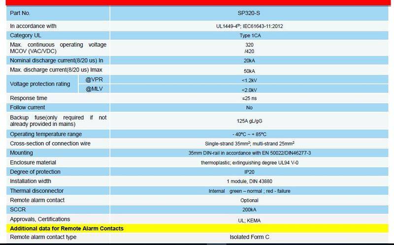

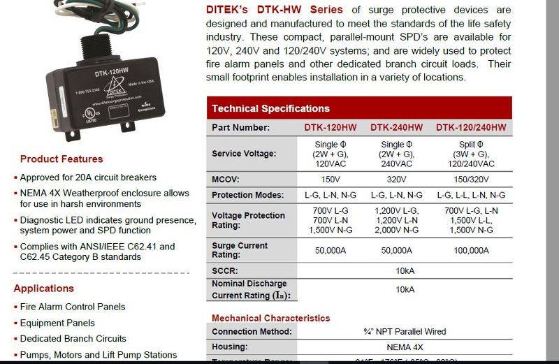

The following SPD type 3 is being offered to me:
If it can bring the 1200 Volts VPR in the Spd type 2 in the breaker to 220 volts in the equipment.. then I'd purchase it asap even if it's more expensive than the type 3. Also it's installed as series.. this is ok?
But do you know how UL computes the 10 meters length to be used as impedance to lower the voltage in the type 3? The supplier doesn't know. My existing length between breaker to equipment is just 5 meters. If you can show 10 meters is necessary. Then I'll add 5 meters by looping it in the side to satisfy the UL requirements. Thanks.

The datasheet you posted says VPR <1KV and it starts to clamp around 370V, probably as low as you can find for a 220/277V rated device. Notice that the maximum continuous power line voltage is 320V.
Series is OK for this one. As shown in the schematic, internally the SPD components are installed across the power line. Because it has exposed metal connected to the power line, this device is designed to be mounted in an electrical box or in the protected equipment itself. Just be sure it is installed close to the equipment you want to protect.

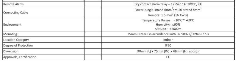

This is the continuation of the specs that is cut due to screen size limit:
As you can see, it's Approval and Certification is only CE.. Not UL.. my installed Prosurge model has UL, KEMA certification. Do you think surge protector with only CE approval and not UL is not fully tested? Because I only heard about UL 1449 4th Edition where they change the name of TVSS to SPD. The CE approval process or body doesn't seem to involve SPD. What do you make of this? And do you think UL tested every device that has UL approval?
Another thing. For main circuit breaker.. do you think 50kA Imax is enough? Can surge discharges from outside occur more than 50kA sometimes? If so, then I'll get a 100kA to be put in the main breaker and the 50kA transferred to my equipment as the above type is only 25kA and if I'm hit with surges above 50kA then both would get fried.

Last question (and to wrap up the tread).
I will look for one with UL approved so at least the specs were not just made up. But I'm concerned about the Live, Neutral and Ground thing. In my place. My single phase 220 volts uses Live and Neutral only (but since Live & Neutral alternate back and forth.. it can be either), then ground is separate. In SPD products sometimes there is this included protection mode like in:
You can see there is this line "Protection Mode: L-G, L-N, N-G". In the Prosurge product I bought (with specs listed again below), there is no mentioned protection mode.. do you think it protects L-G, L-N, N-G as well?
and last question: The 25kA and 100 kA Prosurge is not UL approved.. only the 50kA is UL approved. If I buy another 50kA as my type 3.. do you think it can also decrease the voltage to 220 volts.. Let's say you have 3 SPS with 25kA, 50kA, 100kA.. if the input voltage is 1200 volts (say you make all of them as type 3). would they all clamp it down to 220 volts? Or does this only work for lower surge current product like 15kA where it can successfully lower it down? Also you said the Prosurge product you commented yesterday can clamp above 370Vac. that is because of the Temporary Overvoltage TOV rating.. but for other specs (many products has nothing of it listed) that has none of the Temp Voltage TOV rating listed and just the MCOV spec of say 320 volts.. do you think the clamping voltage is 320 volts?
Many thanks!

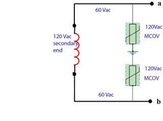

A while ago. I let electrician measure the voltage between one of the lines and ground (see pic illustration). It's 120 volts.. whereas if he measures the 2 wires at breaker.. It's 240 volts.. therefore my ac power is really line to line half phase. Would it really work by installing SPD type 2 that shunt it to ground? If there is a surge in either of the 120 volts wire, would it shunt it to ground or would it be line to line that needs to be engaged? Isn't it if there is surge at the line to line.. you need protection at line to line? My electrician doesn't have any idea and my suppliers are not telling me straight (maybe because they want to sell their overstock). So if anyone of you have a clue, please share so I can decide whether to replace the spd type 2 with full mode protection (I'd like to understand what additional would I gain from this when ultimately it shunts to ground). Thanks.
Per the photo in the same post, a surge on either 120 wire will be shunted to ground. If there is a common mode surge, meaning that if each 120V line has a surge, then each will be shunted to ground at the same time.
So far you have been stating that the power supply is connected to 220V (240V) supply, yet your photo of the breaker box clearly shows the availability of 120V. With your concern of exceeding the 300V maximum of the power supply, the obvious approach is to connect the power supply to 120V and use a 120V SPD. I suspect the voltage at your wall outlets actually has 120V available, can you or someone else measure this?

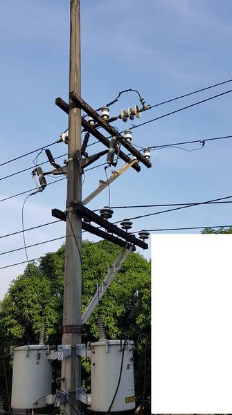

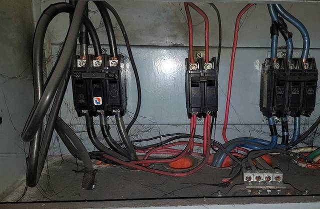

After discussing with the electrician.. here are the complete facts.
The building service entrance is 3 phase with delta transformer... per phase is 120 volts.. but we never have any 120 volts outlets because 100% of our equipments are all 220 volts.. therefore my 220 volts in the outlets came from the line 1 and line 2 (or line 2 and 3 or 1 and 3) of the 3 phase.. in another floor.. the breaker is 3 phase. The one in the picture is admin breaker supplying only lights, cctv and security, hence only single phase needed and the design just tapped the phase 1 and 2 of the 3 phase service entrance power. With all these information.. my Spd type 2 that is line to ground won't be engaged at all because I don't have any equipments in the outlets that is 110 volts, right? If you agree, then I'll remove the existing SPDs and return them to supplier and buy a line to line SPD or delta SPD instead. Thanks.
  • #61
kiki_danc said:
Here is the link I also shared in the same message https://zerosurge.com/normal-mode-v-common-mode/
Here's the breakers in my service entrance:
The front silver thing is the ground lugs. We don't have any neutral. If you will measure the voltage in any of the lines to the ground or even the enclosure, it's 120 volts.. but we never use 120 volts because all our equipments are 240 volts.. the one in the middle is the admin which connects to the panel you saw earlier. Therefore what I need are line to line SPD protecting 2 phases and not 1 phase to ground which is not utilized, right?? In the event there is surge in the line to line (phase 1 to phase 2), would it separately shunt to ground without any equipments actually connected to any phase and ground (or 110 volts we never used?)
  • #62
OK, your last post added much missing information and cleared up much confusion. (Whew!)
I see two relatively easy approaches:
  1. Use a Control Transformer to feed the power supply, 240V primary, 120V secondary
  2. If it is legal with your particular wiring where you are, tap 120V from one leg and use the common Ground as Neutral.
Either way, you can then use a 120V SPD at the power supply. This addresses your concern about the 300V input limit of the power supply.
With option 1., if you use an appropriately sized (small enough) Control Transformer you can use a type 3 SPD and you do not need the 10m wire length before the SPD, the transformer impedance will be more than adequate. You will still need a Ground connection wire for the SPD (or use the conduit if it's legal there). That's because high voltage spikes can get thru a transformer due to the capacitance between primary and secondary.
If you use option 2. above, you will need a type 2 SPD.
You could ask your power company or the city electrical inspector about the legality of option 2.
Cheers,
Tom
p.s. Please let us know how this all works out. Many people here have put time and effort into this and we are always curious.

In your post. You were assuming we have 120 volts equipments or power supplies. We never have this. If we order items from the US which uses 120 volts. We always use up-transformer to convert the 120 volts to 240 volts because all our gadgets and stuff uses 240 volts.. therefore what would be the use of 120 volts.
But I realized you were right that in my current installation, the 320 Vac SPD is too much for the 120 volts phase to ground that we never use or a mismatched.
Supposed I don't want to use any 120 volts which we don't use. And reviewing the delta configuration:
If I'll use the ac power configuration as originally given.. that is using phase A and B to power the computer producing 240 volts. And there is a surge, would the SPD installed in phase A to ground suppress the wires connecting phase A and B? I just want a definite yes or no. If no, then I'll look for a line to line MOV and SPD and either return the installed SPD or sell it since it doesn't do its intended function at all. Thanks so much.
No.
The power supply you specified in post #1
kiki_danc said:
I have a power supply model Mean Well RS-50-24
is universal input voltage capable over the input range of 88V to 264V so it will work with 120V input.
