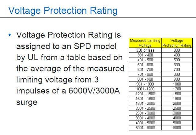

according to the site: https://www.labmanager.com/laboratory-technology/2014/05/surge-suppression#.W7ryhPZuIUC
"Plug in type suppressors will typically have a VPR of 330 volt (ideal) but will have a 127 volt MCOV (not ideal—too close to line voltage). Suppressors installed at the service panel will generally have a safer MCOV (175 volts) but a much higher VPR of 600 to 1,000 volts (also not ideal—damaging to sensitive electronics)."
Now here is Erico TSF6A120V spec sheet:
You see.. the Erico MCOV is 170V. earlier website said 330v belong to MCOV of 125V. So it's odd when other manufacturers can't do a 330v with MCOV of 150Vac.
Also I think it's possible many are confusing SVR and VPR value. The 330V seems to belong to SVR. With the 3000A (versus 500A test surge) of VPR, I wonder if it can really come up with 330V VPR similar to SVR. I'm still googling other genuine products with 330Vac VPR at MCOV of 150Vac.. even Leviton, Siemens, and Eaton can't do it.. so I wonder if the others can that these giants can't...

Note the term "clamping voltage" is ambiguous because it can refer to UL 1449 2nd edition or 3rd Edition. So Belden website could be sharing 2nd edition data of 330V (that uses 500A surge test signal). While in amazon and reality.. it's 500V per 3rd edition test surge of 3000A. Therefore it seems all type 3 SPD no matter how small average about 500Vac VPR.. and if electronic components can fail above 330V.. then perhaps we can say all SPDs in the planet doesn't really protect electronic that is sensitive down to 330v??
Anyway. I think the best thing to do is to write Underwriters Laboratory (UL) and request list of products that has 330V results under UL 1449 third/4th edition. I wonder if they would honor such request? Anyone has tried dealing with UL? I saw the following specs:
http://www.eaton.com/ecm/groups/public/@pub/@electrical/documents/content/td158002en.pdf
330V is a 2nd edition thing.. but if a product under 3rd edition is 360V.. it is better than nothing.
This is time consuming to search for specs. If UL won't give me list. Perhaps I could just get the very expensive $380 Erico.. but it hurts the pocket. I could have better spent it elsewhere.. or maybe will settle for the Leviton 5100-PS which has 600v VPR. It goes back to this important question. What part of electronic circuits really get damaged by quick 600v surge? If none and it won't heat up.. then I guess we all can settle for 600v VPR at fraction of cost of 330v VPR SPD type 3 that we are not even sure is such (for example the 175Vac MCOV Erico). Say aren't others interested in surge protectors? We all can benefit from this so please ask your nearest UL representative to get the listing.

I find something very useful. One can see all UL listed products here:
http://productspec.ul.com/document.php?id=VZCA.E109835
The above is example of all Eaton listed UL products.. you can see only their MCOV of 127Vac can make it to 330V VPR.. while for 150Vac MCOV.. the VPR average is 600 volts.
Now the following is for Erico:
http://productspec.ul.com/document.php?id=VZCA.E325047
Their average VPR for 150Vac MCOV is 800Vac! The TSF5A120V is not listed. Therefore the 330V rating for this may be from older SVR.
Now for Belkin product: http://productspec.ul.com/document.php?id=VZCA.E152555
Their power strips being sold at amazon all have MCOV of only 127Vac.. (too close to 120Vac!)…
Therefore conclusion. There is no product that is actually tested for MCOV of 150Vac and VPR of 330V. All VPR of 330V either are below 150Vac or the older SVR 2nd edition. Can anyone contest my statement?
If I'm right. Then a 150Vac MCOV and VPR of 500 to 600v is the optimum spec for SPD type 3 and there is no VPR of 330V for 150Vac or higher MCOV. All else is fake news.. (Hence Erico spec for the TSF5A120V was from 2nd edition data using much weaker surge current).
