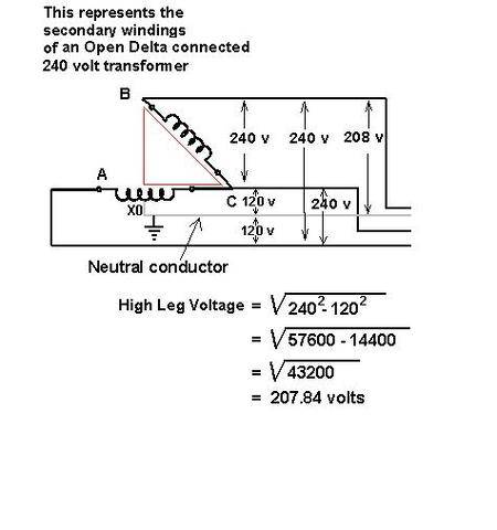

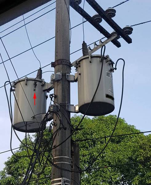

Tom.G said:

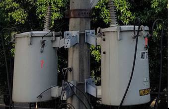

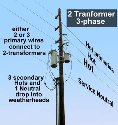

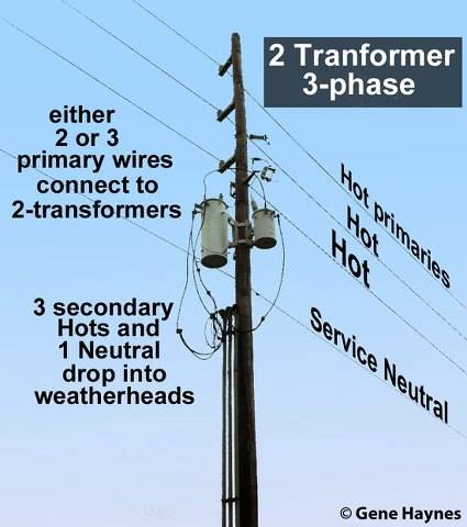

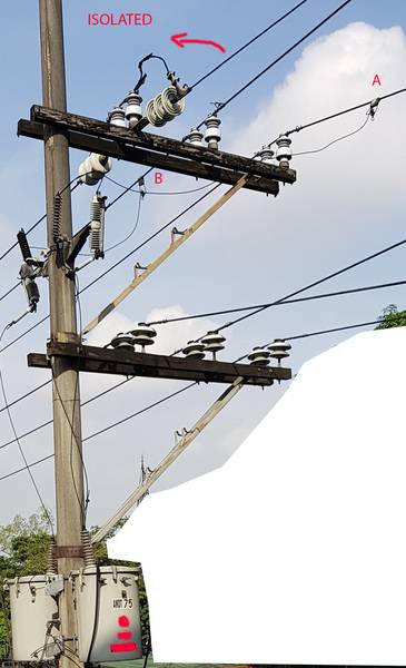

Yes, the Red looks to be the long-lost third wire. And the diagram in post #85 is similar to what I suspected when you said only 2 wires, I just wasn't familiar with the Open Delta configuration. (I learned something new. GREAT!)
I looked carefully a while ago. It's really only 2 lines coming from high tension, the 3rd line is not connected. See:
It's a unique open delta with only 2 wires coming from high tension, the third wire supposed use ground (perhaps this is why we got shock from touching nails embedded in concrete inside the building??) Here are the illustration, explanations and discussions:
https://www.practicalmachinist.com/...nd-vfd/three-phase-only-two-wires-wtf-103191/
"Around here, many farms and other low-demand users of three phase get an arrangement called "open delta".
The utility provides two of the three phases using two hot wires and a ground. Two transformers are used, usually one larger one (typically 25 or 50 KVA), and one smaller one (typically 5 or 10 KVA).
The larger transformer has the secondary center tapped, and this tap is grounded. Let's call the ends of the secondary phase "A" and Phase "C". One end of the secondary of the smaller transformer is then tied to phase "A", with the other end of the small transformer secondary being phase "B".
At the panel, the user gets two legs 120 volts neutral to ground (Phase A and Phase C), and one "wild leg" (Phase B) which is 208 volts neutral to ground. All the 120 volt single phase loads are tapped off phase A and Phase C (hence the use of a larger transformer for those two). Usually any 240 volt single phase loads will also go from phase A to phase C as well. You can use normal three phase panels, but you have to identify the "wild leg" wires with an orange stripe at each point.
All three legs are used to provide 240 volts three-phase to the three phase loads on the site.
Overhead high-voltage lines on farms are usually bare ACSR (aluminum conductor with steel reinforcement), not copper. It is usual to run a hot line and a ground for single phase, or two hot lines and a ground for open-delta three phase.
Underground high-voltage is typically supplied with a fancy coaxial cable, with the center conductor supplying the high volts and the shield grounded. Two of these, connected to two transformers, could definitely supply you with three phase. "
But I still don't comprehend why you won't supply 120V thru a transformer to the 24VDC supply. The 240V SPDs won't keep the spikes below the 300V input rating of the supply. That was a limitation you stated earlier in the thread. Can you explain?

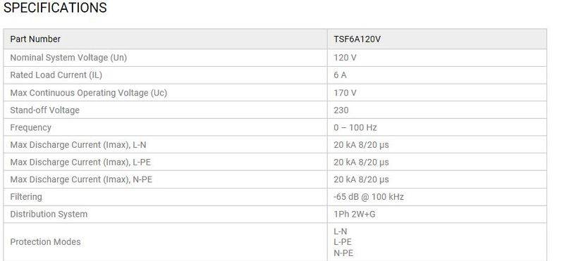

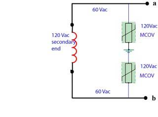

  • #107
Tom.G said:

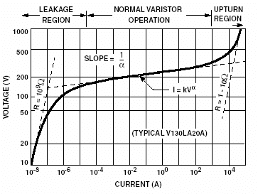

No it won't. It will be suppressed to between 420V and 1200V per the datasheet you supplied in post #52 (https://www.physicsforums.com/threads/surge-protector-specs.955697/page-3#post-6063218) or between 420V and 2000V per the datasheet you supplied in post #26 (https://www.physicsforums.com/threads/surge-protector-specs.955697/page-2#post-6060374)
Ideally, the most protection is to use 3 MOVs at the primary and 3 at the load. This will catch both common mode and line-to-line surges.
About your figure above where the MOV is put line to line. I think not all SPDs can do that. For example, the specs of Prosurge has the following table:
You see. There is no L-L (Line to Line). It's only L-N, L-G, N-G protection modes listed. I think Prosurge is made in china. I'm looking for one made in USA. So in your work hope you can see what brand is the best your engineering crew has encountered. Right now I saw this good model at amazon.https://www.amazon.com/gp/product/B013WINLIO/?tag=pfamazon01-20 It can handle line to line.
So I hope you or others can share some good models too. So we can be sure to get the best. Thanks.
Then do the same at the primary using 240Vac MOVs. Of course you can use pre-built SPDs.
By the way, decide what you want to happen when an SPD fails shorted.
  • Shut off power to the load when they fail, thereby protecting it from further surges.
  • Disconnect the MOVs from the circuit while keeping power to the load, but they no longer protect the load.
When most SPDs fail they fail shorted, and will trip the circuit breaker feeding them to remove power.
The one you showed in post #52 is the second option, it keeps power to the load and blows an internal fuse to disconnect a shorted MOV.
You need a fuse or circuit breaker in the power feed to the SPD for the first option.
But don't try to add an external fuse to get the effect of the second option. The fuse sizing and design is a science in itself. Let the manufacturer do it.

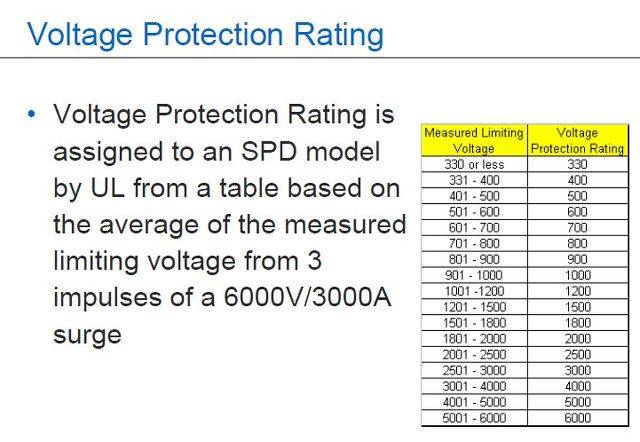

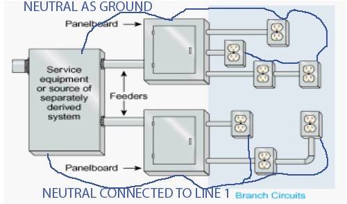

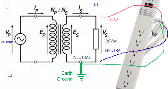

  • #108
Tom.G said:
Consider a nearby lightning strike that puts 6000V on the power line to ground. Much equipment is rated perhaps 600V or so from line to chassis, the the chassis is now at 6000V, and so is everything in it and connected to it. Is there anything near enough to the equipment that a 6000V spark can jump to? For instance the insulation in a transformer would likely break down if anything on its secondary is grounded or near a ground or a large conducting surface. If the transformer is mounted in an electrical box, the box would likely be grounded and the an arc would jump to the transformer core, to the box, to ground. If a person happens to be in contact with the equipment, he/she is now at 6000V; is the floor wet, person touching another piece of equipment at the same time?
Everything you mentioned yesterday finally sinked in. So let's wrap up by the following questions I need to know.
1. In the US, your equipment is connected Line to Neutral and since Neutral is connected to your Ground at service entrance, then all you need are common mode SPD and not really normal mode, isn't it? (but I seem to see specs that line to neutral is called normal mode.. does it mean in the US you need to put line to line SPDs in addition to line to ground SPDs too?? In other words, is Line to Neutral also considered as Line-to-Line, why? If yes, then how about if you are connecting 120v to 120v to get 240v, then it's called Normal Mode II or Line to Line II since you already have one Line to Line if you consider Line to Neutral as Line to Line? And you will get 3 sets of SPDs in equipment in your country?
In our country. Our power is bonafide line to line, so we need normal mode (or L-L) spd. About the common mode SPD, you are saying above that equipment connected to ground won't get damaged even by 6000V strike but the concern is only the person standing nearby. Hence, if my equipments are located in isolated place without people nearby.. then I can just put one 320V Line to Line at primary side of transformer and one 150Vac Line to Line at secondary side of transformers without needing to put any Line to Ground SPDs. Is this correct?
Or did you mean that if a chassis to ground is exposed to 6000V surge, the surge can still fly to the circuit? If it only concerns protection none-existing people then I'd save 4 pieces of SPDs connecting line to ground by just using 2 line to line SPDs at primary and secondary..
2. When you have a 6000V surge at the primary side of the transformer, would it become 3000V surge at the secondary side of the step down transformer (220V to 110V)? But because there is big impedance in the transformer, I guess the surge can become 8000V.. have you thought of this? So the benefit of using transformer is just so as to use lower voltage SPD to get lower clamping voltage right?
3. I think tapping just line to ground to get 120 volts is the fastest way. I'd only need to do it for one breaker at a minor panel (not the main panel). I may be able to convince city hall I won't buy appliance in the US because many local appliance now offers 120 volts. However, I'm now very concerned of my unique 2 transformer open delta which connects to 2 primary phases and not 3 with the third one something to do with ground (as detailed in 2 messages prior to this). Is my ground contaminated? Won't this affect my connecting line to ground to get 120 volts without needing transfomers?
4. Those are the important questions for now that I need to know to decide best course of actions (I have to decide by today so we don't have to continue discussing and wasting your previous time). Anyway In my country, the supplier earns 5 times the actual cost of the unit abroad. This is because of the scarcity of SPDs in my country and SPDs seem to be very good business opportunity. Maybe let's be business partners for this, Tom... Lol.. Thanks :)

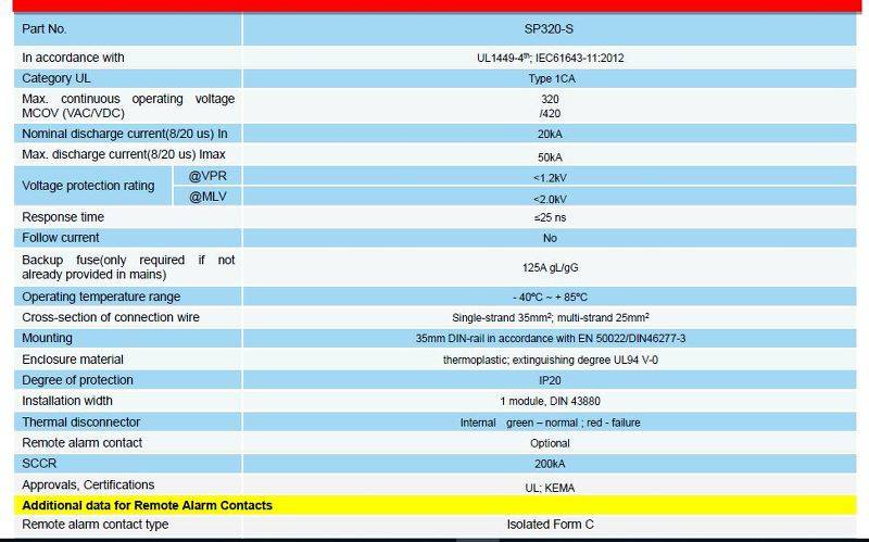

This one I will back off from a bit, I tend to think how the wiring HERE is done. The SPDs you had installed in the breaker box were a very good start, leave them in. Now add a line-to-line SPD at the transformer primary.In line 4 of the table see "MCOV (VAC/VDC)" it says (320/420). That is saying you can put 420VDC on the input continuously and the device will ignore it, that it will not conduct.
Now go to line 7, "Voltage protection rating" "VPR" this shows "<1.2kV" meaning that the maximum clamping voltage is not greater than 1200V.
That is an ASSUMPTION on your part. The manufacturer is only guaranteeing that the output is less than 1.2kV. How much equipment do you want to gamble that your assumption is more accurate than the manufacturers explicit statement?
Cheers,
Tom

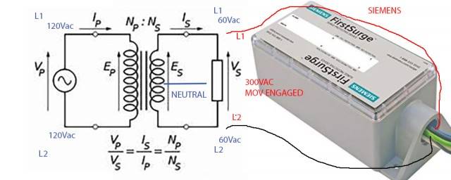

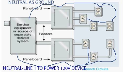

  • #109
I've been searching for almost half day for this important information opening and reading dozens of pages but can't seem to find the definite answer and it's literally giving me headaches so hope we can discuss the microphysics of MOVs. As you can see. Most information gives illustration of SPDs being connected with ground at one terminal. This is because in the US, line to line of 240 volts is seldom use. Hence you always see this illustration even in brochures and technical paper.
What would happen if you connect any SPD line to line? For example.. in the US, if per phase you had 60 volts giving line to line of 120 volts, if you connect any regular 150Vac SPD line to line.. would it still work or does SPD needs to have one terminal at ground? What I want to know is.. do line to line SPDs need to be specially constructed? What do you think?
In the two siemens products at amazon. Even though there is L-L. It's not directly connected.. only their more expensive product has discrete L-L but with dedicated panel so you can't buy these separately. Full details at https://w3.usa.siemens.com/powerdis...alog/Documents/2017/SF-17-Sect-10-ALL-web.pdf
The only available SPDs now that you can put Line to Line is the normal SPDs. So would the MOV element function the same if it has line on both terminal compared to only one? After googling for 5 hours. I gave up looking for answer in the net. Theoretically what do you think? (if Line to Ground can be omitted as I asked in my separate message (hope you can answer it there). Then I'd just focus on L-L connection using my existing 2 pieces 320Vac SPD and putting them at line to line at breaker and near equipment for temporary solution while awaiting the 150Vac (if the supplier still decided to give it to me free after I convinced them clamping voltage can increase as you verified).

  • #110
The philosophy seems to be to "cover all possibilities" as to how many and where the MOVs are connected. If all possible connections are made in the SPD then all the wires are at (nearly) the same voltage during a surge and the possibility of damage is reduced. As one example, if there are two or more SPDs that may be using a common Neutral (or a common Ground), then one of them may suppress a surge, causing the Neutral (or Ground) wire to momentarily rise by a few hundred volts. Another SPD on the circuit would sees this, and one or more of its MOVs will conduct to keep all the wires it is connected to at the appropriate relative voltages. Note that the supply wires at this second device may rise by a few hundred volts in this case, but the voltage difference between them will remain relatively constant, and will track the rise on the Neutral (or Ground) wire.

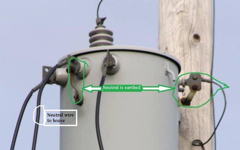

Well, not quite. Consider a Common Mode surge on the transformer primary. Because the primary and secondary winding are close to each other (often the primary will be wound right on top of the secondary) the is capacitive coupling between the two windings, just as if you put a small value capacitor from the primary to the secondary. The secondary, if it is not grounded, could then rise to the same voltage as the primary Common Mode surge. That's why power wiring, even from a transformer secondary on a power pole, has one wire grounded. (Sometimes, when a transformer fails, the primary shorts to the secondary. For instance you wouldn't want the 4kv to 16kV on the power pole transformer on your 240V service.)
Getting a shock when touching a Ground wire and a concrete wall means that one of them is connected to a hot wire somewhere! I would vote that your "Ground" is not really a Ground. Something is (dangerously) mis-wired somewhere. The "unbalanced 3 phase" and Neutral current is based on a 3-phase 4-wire configuration, 3-phase Wye connected source (120/208 or 240/416 as used in the USA).
See my comment above.
Considering that the rest of your wiring is 'unknown' (reference 'Its 3 wire', 'no, it's only 2 wire', 'maybe the 3rd wire is ground', 'I get a shock when touching the Ground wire and the concrete wall' ), your best bet is a 240/120 transformer. If you can find an actual, confirmed Ground, connect one of the transformer secondary leads to it. That takes care of the capacitive coupling between windings. Then you can then use a 120V L-L SPD at the load. A 3 SPD on the primary side would be the safest if you have an actual Ground available.
Yes. Just be sure that if it is in a metal case that the case is not connected to one of the lead wires. The MOVs in an SPD only care about the difference in voltage between their terminals, they dont' care if say one wire has 1,000,000 volts and the other side has 1,000,100 volts; it just knows there is 100 volts across it.
kiki_danc said:
The prosurge local supplier was afraid the 320Vac SPD may explode if put line to line 240 volts.. do you have reference it can be put line to line? I thought only line to ground.
Look at line 4 of the data sheet. It shows Maximum voltage. There is no minimum input voltage anywhere. And the physics of an MOV do not show any minimum either. (I think the 'local supplier' is in need of an education beyond how to take peoples money.)

The ground in my main breakers are really neutral wires connecting directly to the transformers. We don't have separate ground wires. Now I don't think the hot wire is connected to the concrete or neutral because it can spark immediately. It's not all the time.. sometimes only.. so I wonder if open delta unbalance loads can cause the neutral to have current too?

Also realize that the suppression voltage increases somewhat as the current thru the MOV increases.

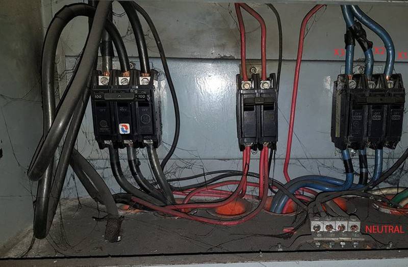

I let electrician connect the spd 320 line to line to the 220 volts line at breaker.. so far it didnt smoke hurray.. btw isn't it if an spd fails. It would short so can this trip the breaker and no adverse effect.on the equipment?
And. I forgot to ask two other things. If I'd put the 320Vac SPD near equipment line to line temporary (without transformer since I am still waiting for my 150Vac SPD and I know transformer can make up for the impedance), should the 10 meters wires from breaker be maintained for the impedance or does this only work for line to ground type 3?
And lastly what would happen if I put 2 pcs of 320Vac SPDS at breaker line to line, what would be the effect of this 2 pcs for the surge as these 2 interact with the surge? Would the surge current be divided among them or VPR would increase or decrease or any unexpected adverse effect?

  • #131
This thread is dragging on a bit. I'll try to help: let's move it to electrical engineering, which is really what 90% of the discussion is about. @jim hardy has discussed this before I think.
Likes Tom.G
  • #132
kiki_danc said:
Googling has led me to electrical engineering section in stack exchange.. I think the details of the above is because if the wires are not 10 meters.. there is not enough inductance to limit the current. Not only this. But the clamping won't work well without the impedance in the wires. So I guess it has double purpose. I guess this answers my own questions in the message prior to this. I'll grill the electrical engineers there if I have more detail questions about the technical aspects of it.
Good! It sounds like you learned a bunch there. I started an rudimentary explanation last night... then the Internet went down in the neighborhood! Something about the Internet provider having a power outage. But you probably got a lot more background information on your stack exchange journey.
kiki_danc said:
About the transformer. You may make sense about lowering down 220 volts to 110 volts to get lower clamping voltage. I wonder if all those countries with 220 volts also use 110 step down transformer to get lower clamping voltage? Well. I have difficulty finding plug in SPDs made in USA (I don't want made in china anymore). Most are integrated. So I wonder what would happen if I used transformer and get 110 volts line to line.. Would the dozens of intergrated SPDs made in US able to distinguish between whether the 110 volts came from line to neutral (in the US power system) or came from line to line (in my country)?
If you use a 240/120V transformer and an added physical Ground as in post #126 and repeated below, the US type 3 plug-in SPDs will see exactly what they need and will work fine. It will likely be difficult to find any that are actually made in the US though.
kiki_danc said:
Remember we have same power system only the usage is regulated (we can't use 120v to avoid inflating Trump pockets) so the answer to that applies exactly to my application.
I disagree. If you had the same or even equivalent system, this discussion would have concluded many pages ago.
The difference is:
  • The US has a Ground-referenced electrical system with an additional electrical Ground 'Safety Ground' at each outlet.
  • Yours is NOT Ground referenced (as indicated by you getting a shock from the Neutral wire) and has NO 'Safety Ground'. (Green wire)
These differences make it difficult/impossible to get both maximum surge protection AND maximum protection to Humans and nearby equipment.
The Siemens FS140 seems a very good choice for a Ground referenced system with a Safety Ground. You can approach that maximum protection for your system by using a 240/120V transformer, adding a physical Ground connection as described in post #126, connecting one transformer secondary lead to the physical Ground connection, and using a Siemens FS140 SPD at the load with its ground wire connected your physical Ground as described in post #126. Anything less is wishful thinking and hoping 'It's good enough'. Nothing is perfect, even with unlimited time and funds, I'm trying to come up with 'best practices' solutions that fit in your constraints.
Now that this thread is in the Elecrical Engineering section maybe others can come up with better solutions.
(But of course by biased opinion is 'it's pretty darn good so far.' :wink:)
I think many of us learned a whole bunch of stuff throughout this project. I sure did!
Cheers,
Tom

  • #133
If you use a 240/120V transformer and an added physical Ground as in post #126 and repeated below, the US type 3 plug-in SPDs will see exactly what they need and will work fine. It will likely be difficult to find any that are actually made in the US though.I disagree. If you had the same or even equivalent system, this discussion would have concluded many pages ago.
The difference is:
Ok. But what I was asking was the following. The line to neutral lead in the Siemens FS140 was supposed to be connected to your US based phase and neutral of 120 volts. But in my case. I will put a 220v-110v transformer in my phase to phase of 240 volts turning them 120 volts. So my 120 volts now would be line to line (or phase to phase in your US language). Now I'm asking if I can connect the Siemens FS140 line to neutral leads to these 120 volts line to line output from transformer? Remember the line to line leads in Seimens FS140 was supposed to be connected to each of your 120 volts phase to create 240 volts.. but my secondary transformer line to line is now 60 volts to 60 volts so I can't use the line to line leads in the Siemens but phase to line which was supposed to be connected to your US phase to line of 120 volts... Remember the MOV inside the Siemens is 150Vac phase to neutral.. and 300Vac if two in series.. their line to line leads automatically has 300Vac MOVs and you can't use this for 120v output because the clamping voltage would be too high or mismatched... hope you get this subtle difference..
If my description was vague since I'm not a native.. here's an illustration:
You are to connect the line 1 and line 2 leads of the Siemens to each of the 120 Vac power wire making up 240volts... but what if you put 220v-110v step down transformer in phase to phase ac supply wires turning it into 110 volts.. then you can't no longer use the same line 1 and line 2 leads in the transformer output of 120 volts because the MOV in series is rated at 300Vac.. you are supposed to connect now the Line 1 and neutral to the 120v output of the transformer (that has phase to phase input) right?
  • #136
Yes. Connect the Neutral lead of the FS140 to the wire that goes to the Grounded secondary terminal of the transformer. The Line leads of the FS140 get connected together then to the wire that goes to the other transformer terminal. And of course the FS140 Ground wire goes to your newly installed Safety Ground.

  • #138
The FS140 is a type 2 SPD, it doesn't clamp the voltages as low as a type 3 because it is rated at a higher current. Note the rated voltage L-N (MCOV) is 150V, for a 120V supply. Your 24VDC supply is rated for 300V for a 5 sec. surge.
I thought this was a temporary installation of the FS140 at the protected equipment while you were finding a type 3 you were happy with. It's still better than nothing until you get a type 3.
  • #139
No. Transformer setup is supposed to be a permanent solution because clamping voltage of type 3 is same as type 2.. the lower figure of strip surge protector you saw at amazon is because it uses UL 1449 second edition test vector which uses 6000 volts and 500 ampere only while UL 1449 third edition use 3000 ampere... but if all will use same third edition, result is the same... clamping voltage is dependent on MCOV only and not the surge current rating.. the following is example of a type 3 that uses third edition test vector and it still has 1100 volts clamping voltage.
http://www.tslpro.com/en/ka-type--surge-arrestor-58.html
I knew since 5 days ago that clamping voltage is dependent on MCOV only and not related to surge current rating. this was the reason why we discussed all these transformers options because it's supposed to be permanent.. the simplest would be to get the following 150Vac module and connect it to my transformer 110v output...
But I want to try other US brand (prosurge is made in china).. this was why I was asking how do you connect the Siemens to the transformer t to make use of the one 150Vac MOV only. if you will connect the line 1 and line 2 to the transformer output of 120 volts.. you will still have MCOV of 300Vac inside the Siemens.. any idea? Because if not possible then I have no choice but to get the above..
Of course if type 3 with lower surge current indeed have lower clamping voltage.. then of course i'll get a type 3...
