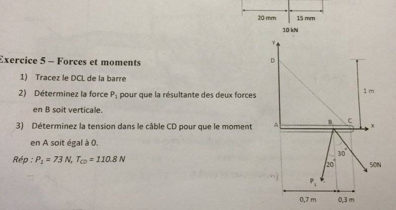

Tension on cable CD when moment on A is Zero.
The discussion centers on calculating the tension in cable Tcd when the moment at point A is zero, with a known force P1 of 73N. The user has made multiple attempts to solve the problem but consistently arrives at an incorrect answer, seeking assistance to reach the correct tension of 110.8 N. Other participants emphasize the importance of sharing previous attempts to identify errors in the approach. The conversation highlights the need for clarity in problem-solving to facilitate effective help. Ultimately, collaboration and detailed explanations are key to resolving the issue.
Yan_33
Looking for the tension in cable Tcd when the moment on A is equal to 0.
P1 = 73N.
I’ve had several attempts but I can’t seem to obtain the answer, which is 110,8 N.
Can anyone help me with this question?

Show us your attempts. It's hard to help if we don't know where you are going wrong.
