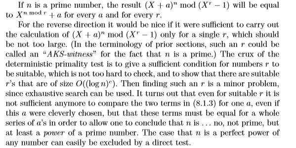

We want to find an efficient algorithm that checks whether an odd number is a prime or not.
In order to obtain such an algorithm, one tests the congruence $(X+a)^n \equiv X^n+a$ not "absolutely" in $\mathbb{Z}_n[X]$, but modulo a polynomial $X^r-1$, where $r$ have to be chosen in a clever way. That is, one compares, in $\mathbb{Z}_n[X]$, the polynomials
$$(X+a)^n \pmod{X^r-1} \text{ and } (X^n+a) \pmod{X^r-1}=X^{n \mod{r}}+a.$$
In the intermediate results that appear in the course of the computation of the power $(X+a)^n$
, all coefficients are reduced modulo $n$, hence they can never exceed $n$. Calculating modulo $X^r-1$ just means that one can replace $X^s$ by $X^{s \mod{r}}$, hence that the degrees of the polynomials that appear as intermediate results can be kept below $r$. This keeps the computational cost in the polynomial range as long as $r$ is $O((\log{n})^c)$ for some constant $c$.
How do we compute the computational cost for computing $(X+a)^n \pmod{X^r-1}$ ? (Thinking)

I like Serena said:
I don't know what that is supposed to mean. I was hoping you could clarify. (Worried)
It says the following:
(Thinking) But as they write it, they mean that the computational cost is polynomial only if $r$ is $O((\log{n})^c)$. I don't know why they say it like that. (Thinking)
It actually says 'if $r$ is of size $O((\log{n})^c)$'.
So I believe they're not talking about computational complexity but just about which constant value of $r$ to pick.
In particular that affects that number of different values of $a$ that we have to check.
Anyway, we're currently only talking about the computational complexity for a single value of $a$. (Thinking)

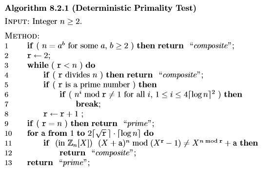

Using the idea described above, we get the following algorithm:
Could you explain to me what the following if-loop checks?
Code:
if (r is a prime number) then
    if (n^i mod r != 1 for all i, 1 <= i <= 4 ceil(logn)^2 ) then
       break;

From the context I deduce it's a heuristic criterion that indicates we have found a suitable $r$.
I can't say why it would be suitable though.
Still, we can say a little more about it.
Suppose $n^i \bmod r = 1$, what does that mean?
Isn't there a proposition that looks like that? (Wondering)
Ah, then we have that $r \mid n^i-1$ and so $r$ cannot divide $n$. Right?
So if $r$ is a prime number and $r \nmid n^i-1$ then it is possible that $r$ is a prime divisor of $n$, so in this case we make the further test if $(X+a)^n \mod{(X^r-1)} \neq X^{n \mod{r}}+a$ for some $a$, right?
Actually, we already had that $r$ does not divide $n$, which would have caused the algorithm to terminate (line 4).
But don't we have that $n^d \bmod r = 1$ if $d$ is the order of $n$ with respect to $r$?
And also that $n^{\phi(r)} \bmod r = 1$ if $n$ and $r$ are co-prime? (Wondering)
More specifically, $n^i\bmod r=1$ means that $(n,r)=1$ and $\#n \mid i$.
Oh yes, right...
Yes... (Nod)
With #n you mean the order of $n$, right ?
So according to the algorithm, if $n$ has an order between $1$ and $4 \lceil 4 \log{n}\rceil^2$ with respect to $r$, we can deduce that $n$ is a prime, otherwise we cannot see whether $n$ is prime or composite. Right? (Thinking)
If so, this fact isn't known in general, is it? (Thinking)
Not quite. (Shake)
So if $n^i \bmod r \ne 1$, that means that $(n,r)\ne 1$ or $\#n \not\mid i$ with respect to $r$.
And yes, $\#n$ is the order of $n$ with respect to $r$.
Since we have already checked all lower values of $r$, and since $r\not\mid n$, it follows that $(n,r)=1$.
Therefore $\#n \not\mid i$ with respect to $r$.
Since this is the case for all $i$ up to $4 \lceil 4 \log{n}\rceil^2$, the order of $n$ with respect to $r$ must be higher than than upper bound, and it also means that $r$ has to be greater than that upper bound.
Anyway, it doesn't tell us whether $n$ is prime or not.
It's just a property of $r$ that we can observe, which apparently makes it suitable. (Thinking)
Why does this hold? $A \Rightarrow B\wedge C $ doesn't imply that $A^c \Rightarrow B^c \lor C^c$, does it? (Thinking)
You mean when we get to the last possible iteration of the while-loop, right? (Thinking)
Why does $r$ have to be greater than the upper bound?
Ah the line 9 is executed only if the line 4 is never executed at the while-loop. It doesn't depend on the lines 5-7, right? (Thinking)
Indeed.
But $A \Leftrightarrow B\land C $ does imply $A^c \Leftrightarrow B^c \lor C^c$. (Nerd)
I mean when the condition is satisfied to break out of the loop.
If that condition is never satisfied, we have $r=n$ after the while-loop and the algorithm ends.
Let $N = 4 \lceil 4 \log{n}\rceil^2$.
Then we have $n>N$ with respect to $r$.
Since $r$ is prime, the greatest order $n$ can have, is $r-1$.
Therefore $r>n>N$. (Thinking)
More specifically, the algorithm returns in line 9 if the condition in line 4 was never satisfied, nor the conditions in line 5 and 6. (Nod)
I like Serena said:
Indeed.
A ok. And if $(n,r)=1$ and $\#n \mid i$ then we have that $i=k \cdot \#n$ for some $k \in \mathbb{Z}$ and so it follows that $n^{i} \mod{r}=1$.
I see...
You mean $N=4 \lceil \log{n}\rceil^2$, right?
Ah, so since the greatest order $n$ can have is $r-1$, and we have checked that the order isn't $\leq N$, it holds that $r-1>N \Rightarrow r>N+1$, right? And since we also have that $r<n$, we get the inequality $N+1<r<n$, right? (Thinking)
So, if we find a prime $r<n$ such that $\#n \nmid i, \forall i \in \{1, \dots, 4 \lceil \log{n}\rceil^2 \}$, then we will have found a suitable $r$ to check if $(X+a)^n \mod{(X^r-1)} \neq X^{n \mod{r}}+a$ for some value of $a$. With this value of $r$ and the values of $a$ that we check, we can deduce if $n$ is composite or not. Right?
If we don't find such a prime $r$, then we will have checked that no integer $<n$ divides $n$ and so we will deduce that $n$ is a prime, right?
Yes to all of that. (Nod)

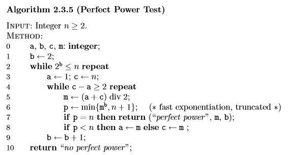

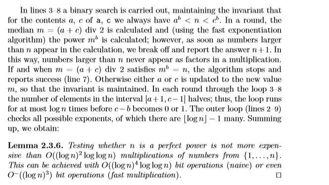

I also took a look at the algorithm mentioned in my notes. The algorithm is the following:
It says the following about it:View attachment 7609
At the lemma it says that the algorithm makes $O((\log{n})^2 \log{\log{n}})$ multiplications of numbers from $\{1, \dots,n\}$. How do we deduce this? (Thinking)
How many times does the outer loop run?
The inner loop?
And what is the complexity of fast exponentiation? (Wondering)
  • #39
The inner loop?
The outer loop runs $O(\log{n})$ times. Since with the inner loop we carry out a binary search, it is executed $O(\log{n})$ times, too. Right?
For the computation of $m^b$, it is required time $O(\log^3{b})$ using fast exponentiation, right? (Thinking)
  • #40
Yep. (Nod)
Isn't the fast exponentiation $O(\log{b})$?
And we have $b=O(\log n)$ don't we? (Wondering)
  • #41
How is it justified that the fast exponentiation is $O(\log{b})$?
Yes. (Smile)
  • #42
Isn't the computational complexity of calculating $a^n$ with fast exponentiation:
$$\begin{aligned}g(n)&=\begin{cases}
0, & n=1\\
g\left(\frac{n}{2}\right )+1, & n \text{ even } \\
g(n-1)+1, & n \text{ odd}>1
\end{cases} \\
&=\begin{cases}
0, & n=1\\
g\left(\frac{n}{2} \right )+1, & n \text{ even } \\
g(\frac{n-1}2)+1 + 1, & n \text{ odd}>1
\end{cases} \\
&=\begin{cases}
0, & n=1\\
g\left(\lfloor\frac{n}{2}\rfloor \right )+O(1), & n >1
\end{cases} \\
&= O(\log n)
\end{aligned}$$

Why is it plus $1$ at the last two cases?
$$g(n)=\begin{cases}
0, n=1\\
g\left(\frac{n}{2}\right )+1, n \text{ even } \\
g(n-1)+1, n \text{ odd}>1
\end{cases}$$
  • #44
0, n=1\\
\end{cases}$$
We have $a^{2k}=(a^k)^2$ respectively $a^{2k+1}=(a^{2k})\cdot a$, and each takes 1 multiplication. (Thinking)
  • #45
I see... So the computational complexity is the number of multiplications done?
It differs from the time complexity, right? (Thinking)
Furthermore, it says that the number $\lceil \log{n} \rceil$ may be calculated in $O(\log{n})$ arithmetic operations (by repeated halving).
How do we calculate $\lceil \log{n} \rceil$ by repeated halving? (Thinking)

Ok. But how can we find $\lceil \log{n}\rceil$ by repeated halving? (Thinking)
  • #50
evinda said:
So we could consider that one multiplication of some integers $a,b$ takes time $O(1)$ or that it takes time $O(\log^2{n})$, right?
Indeed. (Nod)
How about:
\textbf{Algorithm ILSe.1 (Count Bits)} \\
\textrm{INPUT: Integer }n \ge 0 \\
\begin{array}{rl}
1.& k \leftarrow 0\ ; \\
2.& \textbf{while }n \ne 0 \\
3.& \quad n \leftarrow \lfloor \frac n2 \rfloor\ ; \\
4.& \quad k \leftarrow k+1\ ; \\
5.& \textbf{return } k\ ; \\
\end{array}$$
(Wondering)
