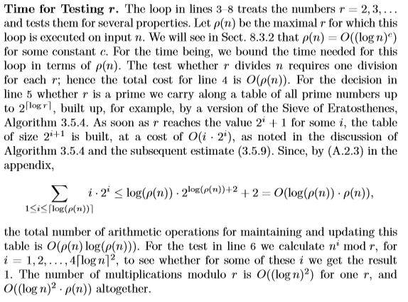

I have also a question for the time required for testing $r$. According to my notes:
First of all, how do we deduce that the total cost for line $4$ is $O(\rho(n))$ ?

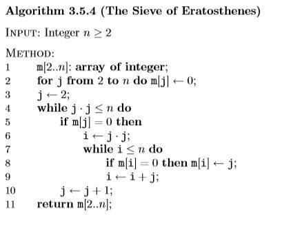

The Sieve of Eratosthenes algorithm is the following:View attachment 7612
Why do we check what happens when $r$ gets the value $2^i+1$ for some $i$ ? Could you explain it to me? (Thinking)

  • #54
Isn't line 4 executed $\rho(n)$ times, while the cost of one execution is $1\text{ division} = O(1)$? (Wondering)
I believe it's to reuse the same table for a number of iterations of $r$.
When $r$ runs out of the table, the table size is doubled and recalculated for the next series of iterations of $r$. (Thinking)
  • #55
Oh yes, right... (Nod)
But why do we check only what happens when $r$ is of the form $2^{i}+1$ although not every prime can be written in this form?
Also if $r=2^i+1$ for some $i$ don't we get a table of size $2^{\lceil \log{(2^{i}+1)}\rceil}-1$ ? Or am I wrong?
  • #56
The size of the table is not related to primes.
Since we double the table size each time, we have $2^i$ entries in there at all times.
And when $r$ becomes $2^i+1$ it refers to an entry in the table that is not there yet, which is when the table gets resized, after which it will have $2^{i+1}$ entries.
Now the main algorithm can continue running $r$ from $2^i+1$ up to $2^{i+1}$ before we run out of the table again. (Thinking)
  • #57
Why do we double the table size each time? I haven't understood it... (Worried)

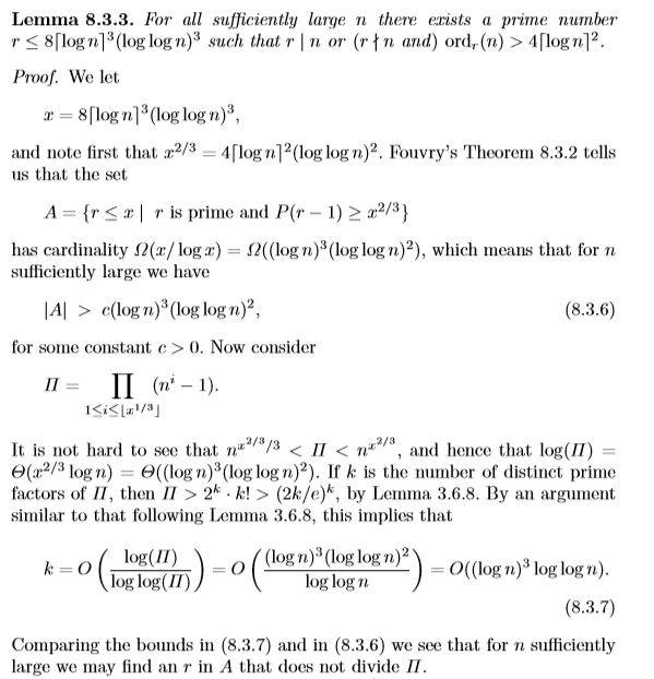

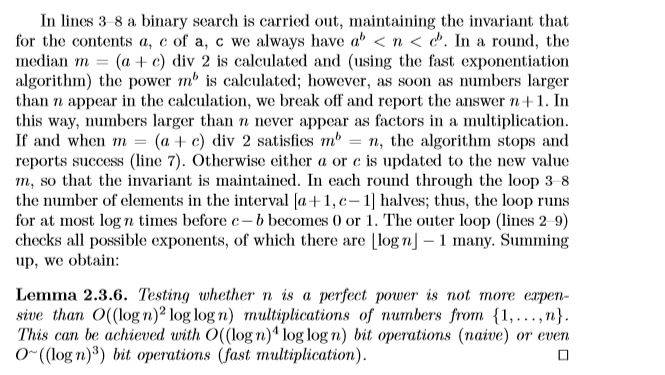

  • #71
Then we check how many times the while-loop is executed. There is the following lemma.
First of all, how do we get that $\Omega\left(\frac{x}{\log{x}}\right)=\Omega((\log{n})^3 (\log{\log{n}})^2)$ ?
I got that $\frac{x}{\log{x}}=\frac{8 \lceil \log{n}\rceil^3 (\log{\log{n}})^3}{\log{8}+3 \log{(\lceil \log{n}\rceil)+3 \log{(\log{\log{n}})}}}$... But is this in $\Omega((\log{n})^3 (\log{\log{n}})^2)$ ?
Also how do we get that $n^{\frac{x^{\frac{2}{3}}}{3}} <\Pi<n^{x^{\frac{2}{3}}}$ ? (Thinking)
  • #72
Don't we have $\frac{x}{\log{x}}=\frac{8 \lceil \log{n}\rceil^3 (\log{\log{n}})^3}{\log{8}+3 \log{(\lceil \log{n}\rceil)+3 \log{(\log{\log{n}})}}}
\ge \frac{8 \lceil \log{n}\rceil^3 (\log{\log{n}})^3}{4 \log{(\lceil \log{n}\rceil)}}$ for sufficiently large $n$? (Wondering)
Let $X=\lfloor x^{1/3}\rfloor$.
Then:
$$\mathit\Pi = \prod_{i=1}^X (n^i-1) < \prod_{i=1}^X n^X = n^{X^2}$$
and:
$$\mathit\Pi = \prod_{i=1}^X (n^i-1) > \prod_{i=1}^X n^{i-1} = n^{\sum (i-1)} = n^{\frac 12 X(X-1)} > n^{\frac 13 X^2}$$
Isn't it? (Wondering)
  • #73
This holds when $\lceil \log{n}\rceil \geq \frac{(\log{\log{n}})^3}{8}$, right? If so, how can we easily prove this? Do we use induction?
Then we have the following.
$$\frac{x}{\log{x}} \geq \frac{8 \lceil \log{n}\rceil^3 (\log{\log{n}})^3}{4 \log{(\lceil \log{n}\rceil)}}\geq \frac{8 \lceil \log{n}\rceil^3 (\log{\log{n}})^3}{4 \log{(\log{n}+1)}} (\star)$$
We have that $4 \log{(\log{n}+1)} \leq 4 \log{(2 \log{n})}=4(\log{2}+\log{(\log{n})})=4(1+\log{(\log{n})}) \leq 4(2 \log{(\log{n})})=8 \log{(\log{n})}$.
So we get that $(\star) \geq \frac{8 \lceil \log{n}\rceil^3 (\log{\log{n}})^3 }{8 \log{(\log{n})}}=\lceil \log{n}\rceil^3 (\log{\log{n}})^2$.
Right? Or have I done something wrong? (Thinking)
Then:
I see... (Nod)
Why does it hold that $\prod_{i=1}^X (n^i-1) > \prod_{i=1}^X n^{i-1}$ ?
The last inequality holds for $X>3$, right?
  • #74
Can't we use that $\log n > \log\log n > \log\log\log n > 8$ for sufficiently large $n$? (Wondering)
So is it as follows?
$$\log{8}+3 \log{(\lceil \log{n}\rceil)}+3 \log{(\log{\log{n}})} \leq \log{(\log{n})}+3 \log{(\log{n}+1)}+3 \log{(\log{n})} \leq 4 \log{(\log{n})}+3 \log{(2 \log{n})}=7\log{(\log{n})}+3 \log{2}\leq 7 \log{(\log{n})}+3 \log{(\log{n})}=10 \log{\log{n}}$$
Thus, we have $\frac{x}{\log{x}}\geq \frac{8 \lceil \log{n}\rceil^3 (\log{\log{n}})^3}{10 \log{\log{n}}}=\frac{8}{10} \lceil \log{n}\rceil^3 (\log{\log{n}})^2= \Omega(\lceil \log{n}\rceil^3 (\log{\log{n}})^2)$.
Right?
Right?
Yep. (Nod)

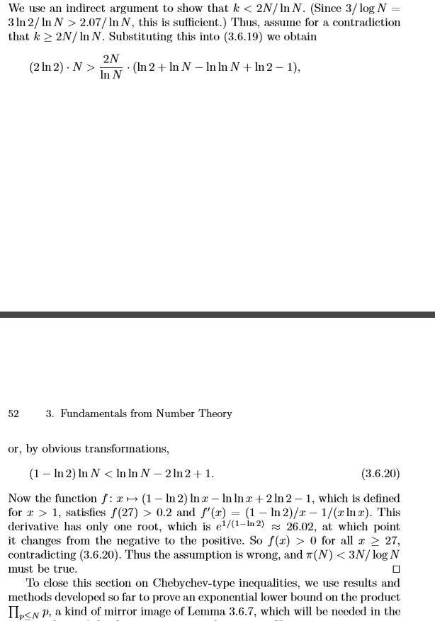

  • #81
I like Serena said:
Indeed. (Thinking)
How else could we get the lower bound? (Thinking)
I like Serena said:
That leads up to $\mathit\Pi > (2k/e)^k$.
Taking logs brings us basically to $k\log k <c\cdot N$, where $N=\log\mathit\Pi$ and $c$ is some constant.
From there we are supposed to get to $k<c\cdot \frac{N}{\log N}=c\cdot \frac{\log\mathit\Pi}{\log\log\mathit\Pi}$.
It seems that is explained right after your fragment with 'an indirect argument'.
What comes after? (Thinking)

Don't we have that $k \leq \pi(\mathit \Pi)$ and so $k=O{\left( \frac{\mathit \Pi}{\log{ \mathit \Pi}}\right)}$ ? Or am I wrong? (Thinking)
  • #86
(Thinking)
It seems that $O\left(\frac{\log{N}}{\log{\log{N}}}\right)$ is a known upper bound for the number of distince prime divisors of $N$, but I haven't understood how we can show this... (Thinking)
  • #87
evinda said:
I like Serena said:
Isn't the first step where it says in the proof in http://mathhelpboards.com/number-theory-27/test-whether-integer-prime-22804-post103344.html#post103344 that $\mathit\Pi > 2^k\cdot k! > (2k/e)^k$ by lemma 3.6.8? (Wondering)
Yes. Do we use this somehow to conclude that $k=O{\left( \frac{\log{\mathit\Pi}}{\log{\log{\mathit\Pi}}}\right)}$ ? (Thinking)
I like Serena said:
Yes. Can't the next step be similar to what we have in post http://mathhelpboards.com/number-theory-27/test-whether-integer-prime-22804-post103372.html#post103372?
That is, we're taking logarithms,
$$\ln\mathit\Pi > k\cdot (\ln k + \ln 2 - 1)\tag{3.6.19a}$$
(Thinking)
evinda said:
So then we suppose that $k \geq \frac{\ln{\mathit\Pi}}{\ln{\ln{\mathit\Pi}}}$, in order to get a contradiction.
Using the relation $\ln{\mathit\Pi}>k(\ln{k}+\ln{2}-1)$ we get that
$$\ln{\mathit\Pi}> \frac{\ln{\mathit\Pi}}{\ln{\ln{\mathit\Pi}}}\left( \ln{\ln{\mathit\Pi}}-\ln{\ln{\ln{\Pi}}}+\ln{2}-1\right) \\ \Rightarrow \ln{\mathit\Pi} \ln{\ln{\mathit\Pi}}> \ln{\mathit\Pi} \ln{\ln{\mathit\Pi}}-\ln{\mathit\Pi} \ln{\ln{\ln{\mathit\Pi}}}+ \ln{2} \ln{\mathit\Pi}-\ln{\mathit\Pi} \\ \Rightarrow \ln{\mathit\Pi} (\ln{(\ln{\ln{\mathit\Pi}})}+1-\ln{2})>0$$
Do we now look at the function $f(x)= \ln{x}(\ln{\ln{\ln{x}}}+1-\ln{2})$ ?
If so, accrding to Wolfram, it has one solution and its derivate has no solution. What can we get from this? (Thinking)
Isn't that expression true for sufficiently large $x$? And the function positive as well?
Then it won't lead to a contradiction. (Worried)In the argument given in http://mathhelpboards.com/number-theory-27/test-whether-integer-prime-22804-post103374.html#post103374, we assumed that $k \ge \frac{2N}{\ln N}$. Note the extra factor $2$.
So let's first define $M=\ln\mathit\Pi$, and let's assume that $k\ge \frac{2M}{\ln M}$ for a contradiction.
Then we get:
$$M>k\cdot(\ln k + \ln 2 - 1) \tag{3.6.19a}$$
and it follows, when $\ln M > 0$, that:
$$M>\frac{2M}{\ln M}\cdot\left(\ln\left(\frac{2M}{\ln M}\right) + \ln 2 - 1\right) \\
\Rightarrow\quad\frac 12\ln M > \ln\left(\frac{2M}{\ln M}\right)+ \ln 2 - 1 \\
\Rightarrow\quad\frac 12\ln M > \ln M - \ln\ln M+ 2\ln 2 - 1 \\
\Rightarrow\quad(1-\frac 12)\ln M < \ln\ln M-2\ln 2 + 1$$
so by obvious transformations,
$$(1-\frac 12)\ln M < \ln\ln M-2\ln 2 + 1\tag{3.6.20a}$$
Now we can look at the function $f: x \mapsto (1-\frac 12)\ln x - \ln\ln x + 2\ln 2 - 1$, which is defined for $x > 1$, can't we? (Wondering)
  • #88
Then we get:
We have that $f(x)>0$ for $x>1$.
Then $f'(x)=\frac{\ln{x}-2}{2 x \ln{x}}$.
$f'(x)=0 \Rightarrow x=e^2$.
For $x> e^2$ we have that $f'(x)>0$ and so $f$ is increasing.
For $1<x<e^2$ we have that $f'(x)<0$ and so $f$ is decreasing.
So we get that for any $x>1$, $f(x)>f(e^2)=\ln{2} \Rightarrow \frac{1}{2} \ln{x}-\ln\ln x+ 2\ln 2-1>\ln{2}>0$, contradicting the relation $(3.6.20a)$.
Is everything right? (Thinking)

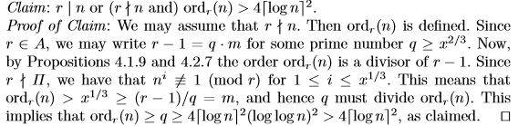

How do we see that $q$ must divide $ord_r{(n)}$ ? (Thinking)
  • #91
From what came before we have that:
$\operatorname{ord}_r n \mid r-1 = qm \tag 1$
$\operatorname{ord}_r n > x^{1/3} \ge m \tag 2$
Suppose that the prime $q\not\mid \operatorname{ord}_r n$.
Then by (1) it follows that $\operatorname{ord}_r n \mid m$, doesn't it?
Thus $\operatorname{ord}_r n \le m$, which is a contradiction with (2) isn't it? (Wondering)

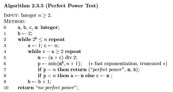

I have also an other question. It says the following about the algorithm of post #17.View attachment 7781Why are the numbers bounded by $n^2$ and not by $n$ ? (Thinking)
  • #93
In line 6 we're calculating $n^i\bmod r$ where $r$ can be as high as $n-1$.
With the fast exponentiation algorithm that means we need to evaluate numbers up to $(r-1)^2 = (n-2)^2$ don't we? (Wondering)
  • #94
In line 6, don't we compute at the beginning $n \mod{r}$, then at the second interation $(n \mod r) \cdot (n \mod{r})$, and so on? (Thinking)
  • #95
Yes.
So the result of the first iteration is $n^2 \bmod r$.
Then we calculate $(n^2 \bmod r)\cdot (n^2 \bmod r)$ don't we? (Wondering)
And in one of the iterations we could have $r-1$.
From wiki:
The following is an example in pseudocode based on Applied Cryptography by Bruce Schneier.[1] The inputs base, exponent, and modulus correspond to b, e, and m in the equations given above.
Code:
function modular_pow(base, exponent, modulus)
    if modulus = 1 then return 0
    Assert :: (modulus - 1) * (modulus - 1) does not overflow base
    result := 1
    base := base mod modulus
    while exponent > 0
        if (exponent mod 2 == 1):
           result := (result * base) mod modulus
        exponent := exponent >> 1
        base := (base * base) mod modulus
    return result
As you can see, we even have an assert in there that says we need to have support up to $(r-1)^2$. (Worried)
  • #96
I like Serena said:
Yes.
But then we could also need to calculate $n^5 \mod{r}$, which is equal to $n^4 \cdot n \mod{r}$. (Worried)
So why can we pick $n^2$ as an upper bound? (Thinking)
  • #97
