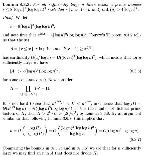

Then we check how many times the while-loop is executed. There is the following lemma.
First of all, how do we get that $\Omega\left(\frac{x}{\log{x}}\right)=\Omega((\log{n})^3 (\log{\log{n}})^2)$ ?
I got that $\frac{x}{\log{x}}=\frac{8 \lceil \log{n}\rceil^3 (\log{\log{n}})^3}{\log{8}+3 \log{(\lceil \log{n}\rceil)+3 \log{(\log{\log{n}})}}}$... But is this in $\Omega((\log{n})^3 (\log{\log{n}})^2)$ ?
Also how do we get that $n^{\frac{x^{\frac{2}{3}}}{3}} <\Pi<n^{x^{\frac{2}{3}}}$ ? (Thinking)
Don't we have $\frac{x}{\log{x}}=\frac{8 \lceil \log{n}\rceil^3 (\log{\log{n}})^3}{\log{8}+3 \log{(\lceil \log{n}\rceil)+3 \log{(\log{\log{n}})}}}
\ge \frac{8 \lceil \log{n}\rceil^3 (\log{\log{n}})^3}{4 \log{(\lceil \log{n}\rceil)}}$ for sufficiently large $n$? (Wondering)
Let $X=\lfloor x^{1/3}\rfloor$.
Then:
$$\mathit\Pi = \prod_{i=1}^X (n^i-1) < \prod_{i=1}^X n^X = n^{X^2}$$
and:
$$\mathit\Pi = \prod_{i=1}^X (n^i-1) > \prod_{i=1}^X n^{i-1} = n^{\sum (i-1)} = n^{\frac 12 X(X-1)} > n^{\frac 13 X^2}$$
Isn't it? (Wondering)
  • #73
This holds when $\lceil \log{n}\rceil \geq \frac{(\log{\log{n}})^3}{8}$, right? If so, how can we easily prove this? Do we use induction?
Then we have the following.
$$\frac{x}{\log{x}} \geq \frac{8 \lceil \log{n}\rceil^3 (\log{\log{n}})^3}{4 \log{(\lceil \log{n}\rceil)}}\geq \frac{8 \lceil \log{n}\rceil^3 (\log{\log{n}})^3}{4 \log{(\log{n}+1)}} (\star)$$
We have that $4 \log{(\log{n}+1)} \leq 4 \log{(2 \log{n})}=4(\log{2}+\log{(\log{n})})=4(1+\log{(\log{n})}) \leq 4(2 \log{(\log{n})})=8 \log{(\log{n})}$.
So we get that $(\star) \geq \frac{8 \lceil \log{n}\rceil^3 (\log{\log{n}})^3 }{8 \log{(\log{n})}}=\lceil \log{n}\rceil^3 (\log{\log{n}})^2$.
Right? Or have I done something wrong? (Thinking)
Then:
I see... (Nod)
Why does it hold that $\prod_{i=1}^X (n^i-1) > \prod_{i=1}^X n^{i-1}$ ?
The last inequality holds for $X>3$, right?
  • #74
Can't we use that $\log n > \log\log n > \log\log\log n > 8$ for sufficiently large $n$? (Wondering)
All correct. (Nod)
Doesn't it hold for any $X$ as long as $n \ge 2$?
That is:
$$n^i -1 = n^{i-1}(n-n^{-(i-1)})>n^{i-1}$$
(Thinking)
  • #75
So is it as follows?
$$\log{8}+3 \log{(\lceil \log{n}\rceil)}+3 \log{(\log{\log{n}})} \leq \log{(\log{n})}+3 \log{(\log{n}+1)}+3 \log{(\log{n})} \leq 4 \log{(\log{n})}+3 \log{(2 \log{n})}=7\log{(\log{n})}+3 \log{2}\leq 7 \log{(\log{n})}+3 \log{(\log{n})}=10 \log{\log{n}}$$
Thus, we have $\frac{x}{\log{x}}\geq \frac{8 \lceil \log{n}\rceil^3 (\log{\log{n}})^3}{10 \log{\log{n}}}=\frac{8}{10} \lceil \log{n}\rceil^3 (\log{\log{n}})^2= \Omega(\lceil \log{n}\rceil^3 (\log{\log{n}})^2)$.
Right?
That is:
(Thinking)
This holds only when $n-n^{-(i-1)}>1 \Rightarrow n^i-n^{i-1}-1>0$, right? (Thinking)

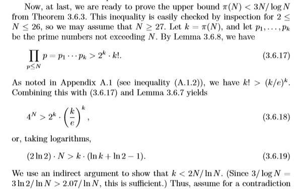

What is the argument following lemma 3.6.8? (Wondering)
For $x>1$, with $\pi(x)$ we denote the number of primes $p \leq x$.
  • #80
evinda said:
Doesn't $n^{\frac 12 X(X-1)} > n^{\frac 13 X^2}$ only hold when $\frac{1}{2}X^2-\frac{1}{2}X>\frac{1}{3}X^2 \Rightarrow X>3$ ?
Also having shown that $\mathit\Pi > n^{\frac{1}{3}X^2}=n^{\frac{1}{3} \lfloor x^{\frac{1}{3}}\rfloor^2}$ we haven't shown yet that $\mathit\Pi > n^{\frac{1}{3}x^{\frac{2}{3}}}$, do we?
Indeed. (Thinking)
That leads up to $\mathit\Pi > (2k/e)^k$.
Taking logs brings us basically to $k\log k <c\cdot N$, where $N=\log\mathit\Pi$ and $c$ is some constant.
From there we are supposed to get to $k<c\cdot \frac{N}{\log N}=c\cdot \frac{\log\mathit\Pi}{\log\log\mathit\Pi}$.
It seems that is explained right after your fragment with 'an indirect argument'.
What comes after? (Thinking)

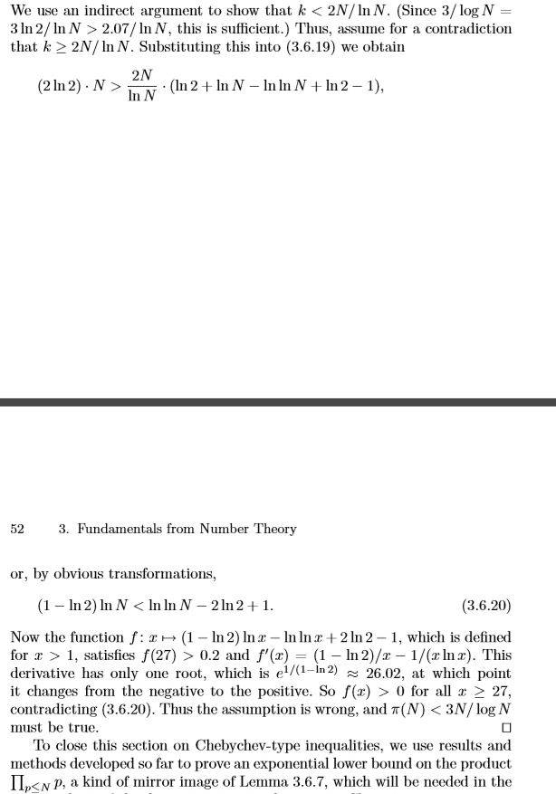

  • #81
I like Serena said:
Indeed. (Thinking)
How else could we get the lower bound? (Thinking)

  • #87
evinda said:
I like Serena said:
Isn't the first step where it says in the proof in http://mathhelpboards.com/number-theory-27/test-whether-integer-prime-22804-post103344.html#post103344 that $\mathit\Pi > 2^k\cdot k! > (2k/e)^k$ by lemma 3.6.8? (Wondering)
Yes. Do we use this somehow to conclude that $k=O{\left( \frac{\log{\mathit\Pi}}{\log{\log{\mathit\Pi}}}\right)}$ ? (Thinking)
I like Serena said:
Yes. Can't the next step be similar to what we have in post http://mathhelpboards.com/number-theory-27/test-whether-integer-prime-22804-post103372.html#post103372?
That is, we're taking logarithms,
$$\ln\mathit\Pi > k\cdot (\ln k + \ln 2 - 1)\tag{3.6.19a}$$
(Thinking)
evinda said:
So then we suppose that $k \geq \frac{\ln{\mathit\Pi}}{\ln{\ln{\mathit\Pi}}}$, in order to get a contradiction.
Using the relation $\ln{\mathit\Pi}>k(\ln{k}+\ln{2}-1)$ we get that
$$\ln{\mathit\Pi}> \frac{\ln{\mathit\Pi}}{\ln{\ln{\mathit\Pi}}}\left( \ln{\ln{\mathit\Pi}}-\ln{\ln{\ln{\Pi}}}+\ln{2}-1\right) \\ \Rightarrow \ln{\mathit\Pi} \ln{\ln{\mathit\Pi}}> \ln{\mathit\Pi} \ln{\ln{\mathit\Pi}}-\ln{\mathit\Pi} \ln{\ln{\ln{\mathit\Pi}}}+ \ln{2} \ln{\mathit\Pi}-\ln{\mathit\Pi} \\ \Rightarrow \ln{\mathit\Pi} (\ln{(\ln{\ln{\mathit\Pi}})}+1-\ln{2})>0$$
Do we now look at the function $f(x)= \ln{x}(\ln{\ln{\ln{x}}}+1-\ln{2})$ ?
If so, accrding to Wolfram, it has one solution and its derivate has no solution. What can we get from this? (Thinking)
Isn't that expression true for sufficiently large $x$? And the function positive as well?
Then it won't lead to a contradiction. (Worried)In the argument given in http://mathhelpboards.com/number-theory-27/test-whether-integer-prime-22804-post103374.html#post103374, we assumed that $k \ge \frac{2N}{\ln N}$. Note the extra factor $2$.
So let's first define $M=\ln\mathit\Pi$, and let's assume that $k\ge \frac{2M}{\ln M}$ for a contradiction.
Then we get:
$$M>k\cdot(\ln k + \ln 2 - 1) \tag{3.6.19a}$$
and it follows, when $\ln M > 0$, that:
$$M>\frac{2M}{\ln M}\cdot\left(\ln\left(\frac{2M}{\ln M}\right) + \ln 2 - 1\right) \\
\Rightarrow\quad\frac 12\ln M > \ln\left(\frac{2M}{\ln M}\right)+ \ln 2 - 1 \\
\Rightarrow\quad\frac 12\ln M > \ln M - \ln\ln M+ 2\ln 2 - 1 \\
\Rightarrow\quad(1-\frac 12)\ln M < \ln\ln M-2\ln 2 + 1$$
so by obvious transformations,
$$(1-\frac 12)\ln M < \ln\ln M-2\ln 2 + 1\tag{3.6.20a}$$
Now we can look at the function $f: x \mapsto (1-\frac 12)\ln x - \ln\ln x + 2\ln 2 - 1$, which is defined for $x > 1$, can't we? (Wondering)
