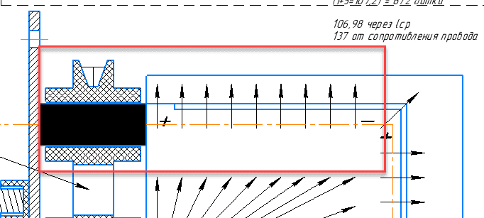

Is the rotating external circuit in electrical contact with the disk through something like carbon motor brushes that touch the stationary disk at 2 different points outside of the magnetic field? Or is the circuit like a floating piece of disconnected wire traversing a circular path completely external to the disk?
Yes, that's right. The rotating external electrical circuit has sliding contacts (carbon brushes), which are installed at the boundary of the magnetic field.
Brushes cannot be installed outside the boundaries of the magnetic field. At least one brush must be installed directly at the edge of the magnetic field of the disc.
This may seem paradoxical, but my experiments confirm it. I believe that this phenomenon can be explained as follows.
An observer located in an external circuit detects an electric field directly at the boundaries of the magnetic field. At the same time, the observer located in the disk does not detect any electric field. That is, this electric field exists only for a moving external circuit. In order for the electric field to enter the external circuit, it must be in direct contact with at least one brush. If the brushes are located at some distance from the observed electric field, despite the fact that they are attached to the metal of the disc, the electric field does not reach them, since this field does not exist for the disc and it does not conduct it. This is a very important point to consider when designing.

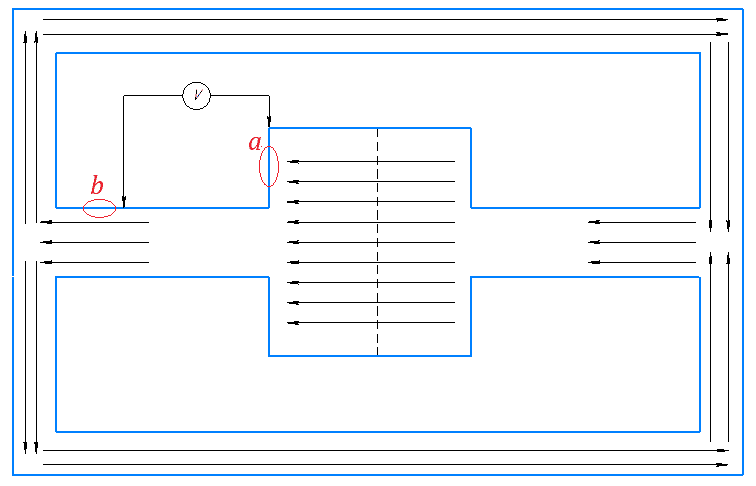

  • #53
I need to correct a statement that I made in post #40 regrading region ##b## in the figure below:
I blundered in stating the following
TSny said:
At the interface in region ##b##, the tangential component of B is discontinuous. This violates ##\nabla \times \mathbf B = \mu_0 \mathbf J + \varepsilon_0 \mu_0 \dfrac{\partial \mathbf E}{\partial t}## assuming that there are no surface currents on the interface.
A discontinuous jump in the tangential component of the magnetic field at region ##b## does not violate the Maxwell equation. The magnetization of the material produces an effective "bound" current at the surface of the material. Therefore, there will be a discontinuous jump in tangential component of ##B## across the boundary at ##b##. The B field in the region of the external circuit will be small compared to the field inside the magnetized material.
I believe this means that the apparatus will not be very effective in generating current in the external circuit. And this will be true whether you (1) rotate the material while keeping the external circuit at rest or (2) keep the material at rest and rotate the external circuit.
  • #54
As an amateur of electric engineering, I find shielding static magnetic field is a challenging task in real world ,e.g. in medical NMR.
Meisner effect may be useful by making the external line with superconductor. But a fundamental question here. Does Lorentz force, which is zero for zero B, apply electrons in moving superconductors or not ? Does Faraday disk made of superconductor generate emf ?

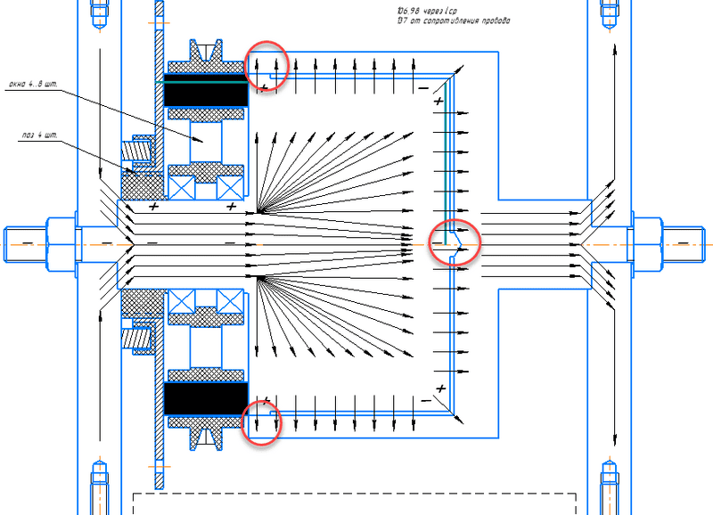

Ivan Nikiforov said:
Good afternoon! I would like to understand how the Faraday disk works and get answers to two questions. The working conditions are as follows: 1) we rotate the external circuit with a voltmeter relative to a stationary disk; 2) the external circuit is not in a magnetic field. Questions: 1) will an electric current flow in such a system? 2) what forces will act on the external circuit with the voltmeter? I would like to consider these processes precisely from the point of view of the theory of relativity, since the Faraday disk is based on the principle of relativity of simultaneity. Thank you in advance!
I am a bit confused - isn't the whole point that the rotating part of the disk is in a magnetic field? I'll assume that this was a typo.

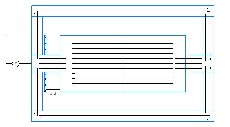

  • #63
renormalize said:
Thanks for the clarification, but that still begs the question: is there any component of the magnetic-field that is both nonzero within, and normal to, the area enclosed by the dashed orange line that is the closed path of the circuit? If not, Faraday's law of induction states that there can be no EMF and no current.

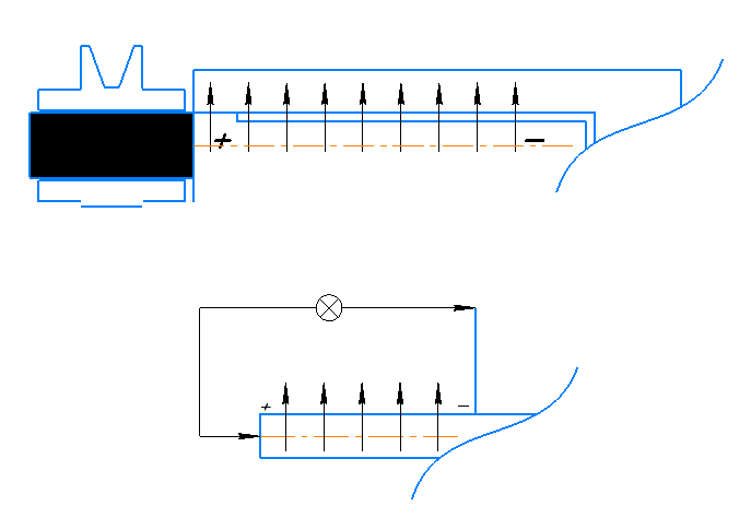

I imagine the distribution of the magnetic field in the core of the generator to be something like this. I made an air gap in the generator core and non-gap surfaces (highlighted in red). It turns out that the external circuit in any case moves perpendicular to the lines of force of the magnetic field. In essence, the core of the generator is a disk, the edges of which are folded to the axis like an umbrella. I have indicated the orange line more precisely, as I imagine.

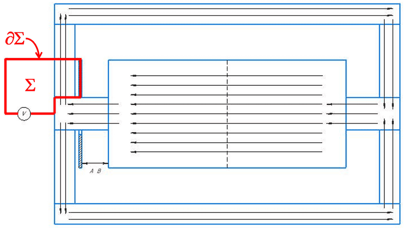

  • #64
Then there is no magnetic-field component normal to the surface ##\Sigma## bounded by the orange path and the magnetic flux ##\Phi_{\Sigma}=\int\!\!\!\int_{\Sigma}\vec{B}\cdot d\vec{S}## through that surface is zero. Hence there is no EMF and no current. By Faraday's law of induction, you must have a nonzero, time-dependent flux through ##\Sigma## (i.e., ##\dot{\Phi}_{\Sigma}\left(t\right)\neq0##) in order to develop an EMF around the orange path.
  • #65
It is possible that your question can be answered as follows. In Tamm's book "Fundamentals of the Theory of Electricity", the rule for calculating the electromotive force for contours, which opens during movement, is considered. The picture shows a model for such a case. The book claims that when calculating the flow change, the flow through the closed contour C'OAVBCC' is applied. This contour is obtained when contour C'OAVBC is deformed using a segment of the trajectory CC' along which the contour break point C' moves.
As I understand it, contours are breaking in my generator and the circular sector COC' must be taken into account to calculate the electromotive force. In addition, it is not yet clear to me what is the fundamental difference between the geometry of the magnetic field of my generator and the Faraday disk? In the drawing, I have depicted a part of the generator and a part of the Faraday disk. In both cases, the external chain moves inside the sheet. It seems to me that the configuration of the magnetic field and the velocity vector is the same in both cases.

  • #66
As I imagine, if the external circuit moves inside the sheet, it should detect something like this electric field pattern - the entire inner surface of the magnetic circuit is positively charged, and the entire outer surface of the magnetic circuit and the axis are negatively charged. It seems to me that the same process is obtained if an observer (a blue ball) flies through a toroid with a closed magnetic field. Therefore, if the entire inner surface of the magnetic circuit is positively charged, then the outer circuit will be in contact with an electric field.

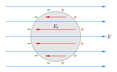

I would like to consider this issue in more detail. I have analyzed the results of experiments over several years and have come to the following conclusion. In models where the brushes are located at some distance from the boundary of the magnetic field (and the observed E-field), the electromotive force is not observed. I even introduced a special term: "inert conductor" to denote the part of the circuit between the boundary of the M-field and the brush.
In fact, this phenomenon is explained as follows. It is important to understand that the electric field that is detected by a moving observer is by its nature an electrostatic field. That is, the electric fields in the Faraday disk and in most modern electric machines are inherently different.
The figure shows a metal conductor located in an electrostatic field. Under the influence of this field, the charges of the conductor are distributed in such a way that the electric field inside the conductor completely compensates for the external field. Thus, the electric field detected by a moving observer within the boundaries of the magnetic field is completely compensated by the internal E-field of the conductor (in our case, the disk). As a result, the observed electric field does not extend beyond the part of the conductor that is in the magnetic field. This is how the absence of an electromotive force can be explained if the brushes are installed outside the boundaries of the magnetic field.

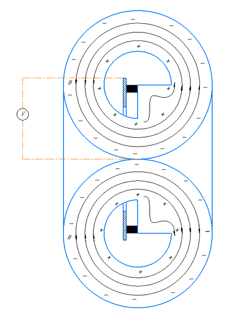

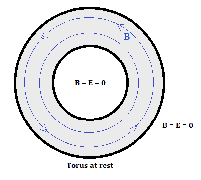

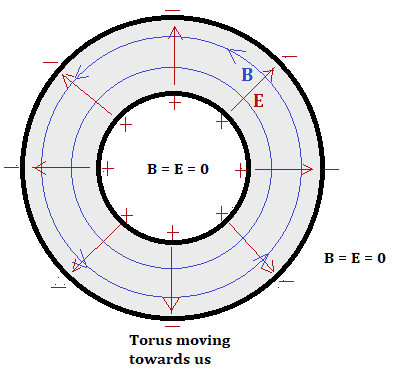

  • #68
When the toroid is at rest, there is no electric field anywhere and the magnetic field is confined to its interior.
Now, suppose we move toward the toroid. In our frame of reference, the toroid is moving out of the page towards us. In our frame, the toroid has surface charge as you indicated. There will exist both electric and magnetic fields inside the toroid. But there will still not be any B or E field outside the toroid. In our frame, a free charge carrier inside the toroid experiences a magnetic force and an electric force. The two forces cancel so that the charge carrier is in equilibrium.
Is this how you see it also?

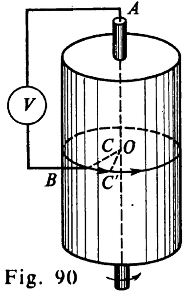

Tamm says:
So the cylinder in Fig. 90 is a permanent magnet similar to the one shown at right and thus it contains a nearly-uniform, vertical magnetic-field ##\vec{B}## inside. Note therefore that the moving closed current-path has segments ##C,C'## inside of, and orthogonal to, the field ##\vec{B}##. Consequently, an EMF develops in the circuit and registers on the voltmeter. That's the fundamental difference: Fig. 90 has a current path partly inside the strong magnetic-field region, whereas you declare that your moving current path is entirely outside of the field. If that's truely the case, you will see no EMF nor current. Think about the situation this way: unless there is at least some portion of your moving current-path immersed inside the field ##\vec{B}##, there can be no Lorentz force ##q\,\vec{v}\times\vec{B}## to drive electrons around the circuit as a current.
  • #70

Thanks for the detailed explanation. As I understand it, my generator also has sections of an electrical circuit similar to OC and OC', that is, part of the electrical circuit passes inside a magnetic core, that is, in a magnetic field. In this case, only the external circuit physically rotates, followed by the OC section, which is essentially a current path. Thus, taking into account the small differences in geometry, my generator is an analog of the model in Figure 90.
  • #71
TSny said:
Когда тороид находится в состоянии покоя, электрическое поле отсутствует, а магнитное поле ограничено его внутренней частью.
Теперь предположим, что мы движемся к тороиду. В нашей системе отсчёта тороид движется по направлению к нам. В нашей системе отсчёта тороид имеет поверхностный заряд, как вы и указали. Внутри тороида будут существовать как электрическое, так и магнитное поля. Но за пределами тороида не будет ни магнитного, ни электрического поля. В нашей системе отсчёта свободный носитель заряда внутри тороида испытывает воздействие магнитной и электрической сил. Эти две силы компенсируют друг друга, и носитель заряда находится в равновесии.
Вы тоже так это видите?
Спасибо за интересное объяснение и иллюстрации. Да, вы правы, я понимаю процесс именно так, как вы описали. Наблюдаемое электрическое поле всегда находится в границах магнитного поля, то есть в данном случае электрическое поле будет находиться внутри тора.
The generator can be equivalently represented as a torus. The external circuit moves inside it in a circle, like a particle in a particle accelerator. In the figure below, a ring with a magnetic field is rolled into a ring in the vertical plane (the section of the torus is shown). The upper carbon brush (in black) is moving away from us, the lower carbon brush is moving towards us.
  • #72
OK, I think we're now on the same page: we agree that there is a portion of your complete circuit that is inside the B-field region, as there must be to generate an EMF in that circuit. Then my only remaining question is: can you explain what is the practical advantage of your configuration, with its magnetic-field confining chambers and moving external pickup? How does that improve on the simplicity and performance of a simple Faraday-disk type homopolar/unipolar generator?

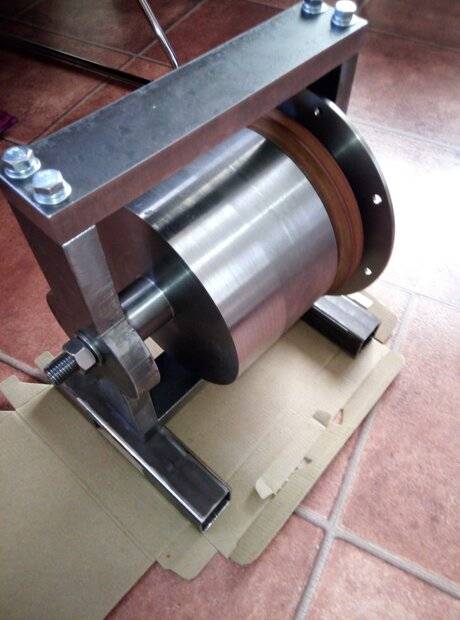

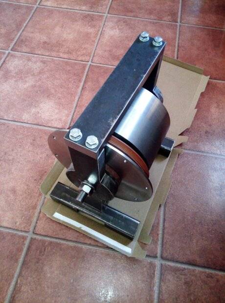

  • #76
Dear participants of the discussion! I am glad to inform you that the experimental sample is ready. It also needs to make excitation coils and purchase some equipment. I will certainly inform you about the results of the experiment. I may be away for a while, so I apologize in advance if I don't respond to comments.
  • Wow
Likes anuttarasammyak
  • #77
Good afternoon! I checked the operation of the prototype and got the following results. For measurements, I used a mirror galvanometer with a division price of 2.5 x 10.9 A. 1) When the external circuit rotates relative to the core at a speed of about 2 revolutions per second, the galvanometer deviates by 2 divisions, always in one direction, regardless of the direction of rotation. Thus, no EMF is detected when the external circuit is rotated. 2) When the core is rotated relative to a stationary external circuit, at a speed of about 30 degrees per second, the galvanometer confidently shows 20...30 divisions. It reacts correctly to the direction of rotation. Thus, when the core rotates, the EMF is detected. Previously, the following conclusions can be drawn from these results. 1) The external circuit is indeed not in a magnetic field. Otherwise, when it rotates, the result would be the same as when the core rotates. 2) The geometry of the magnetic circuit is executed correctly, since an EMF is observed when the core rotates.
That is, when the core rotates, the sample confidently operates like a unipolar generator. I'm trying to analyze the results, but I still can't figure out why there's no EMF when the external circuit is rotating. The external circuit moves relative to the magnetic field of the core. Therefore, it must detect the electric field on the sides of the magnetic field. Therefore, this electric field creates an EMF. But there is no EMF. It turns out that an observer moving relative to a medium with magnetization, in order to detect an electric field, must himself be in a magnetic field? I would appreciate it if you could comment on my results and explain why there is no EMF when the external circuit is rotating.
