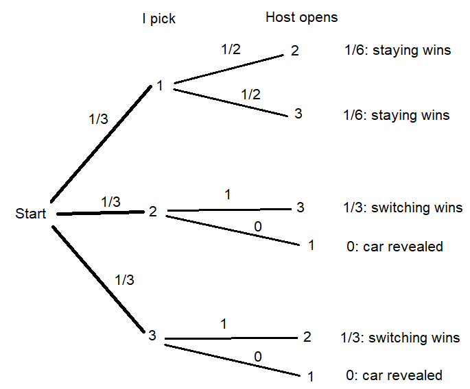

I'd love to see this table fleshed out to show the correct outcomes.
I would do it myself (as I have done in the past) but I keep tripping over the same logical errors.
I can even see where the OP made the error. S/he is equating possibilities with probabilities: (2 rows each "must" mean 50:50 probability - which is wrong*) but I can't figure out how to correctly represent it in the table.
cmb said:

Numbers on lines are relative probabilities, numbers on the right are absolute probabilities.
Edit: Now with 6 cases for symmetry.
Likes DaveC426913, sysprog, phinds and 1 other person
The probability tree or decision tree shown by @mfb is the most efficient tool for analyzing this scenario. However, if you insist on a table, here is the full table.

Just multiply the probabilities by 100 and you can treat them as games out of 100, after rounding them suitably.
I still think the simplest approach is "if you pick the right door initially then you win when keeping it, if you do not you win when switching". What is the probability to pick the right door initially? 1/3, obviously.
