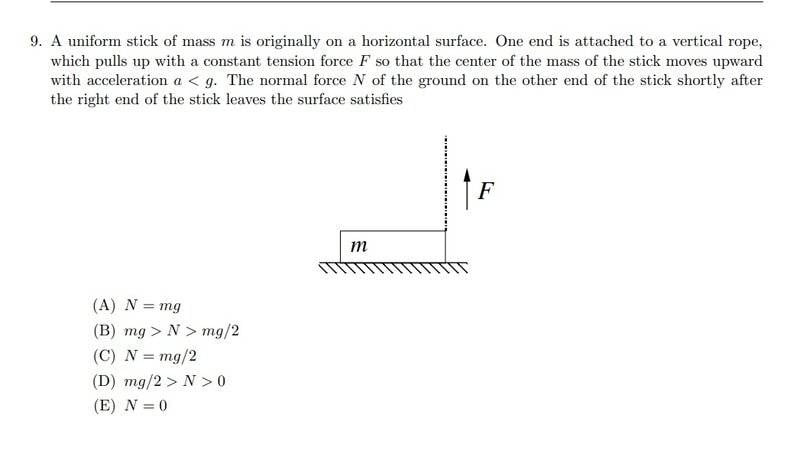

This US Physics Olympiad problem 2018A Question
A uniform stick of mass ##m## is originally on a horizontal surface. One end is attached to a vertical rope,
which pulls up with a constant tension force ##F## so that the center of the mass of the stick moves upward
with acceleration ##a < g##. The normal force ##N## of the ground on the other end of the stick shortly after
the right end of the stick leaves the surface satisfies ##mg > N > mg/2##

I would love to see a free body diagram.
:wink:
Likes MatinSAR
kuruman said:
The diagram at the link shows the stick still horizontal and possessed of some thickness.
The thickness bothers me. It does not say a thin stick, but neither does it call it a rectangular block. Allowing an arbitrary thickness, I can still show N<mg, but not N>mg/2, not even N>0.

It seems to me the author of the problem failed to understand the subtlety and should have described it as thin, showing it as such in the diagram.
This is the stick depicted in the original question: it is actually quite thick:
This is the shape you are talking about:
That does not seem to me to be a "subtlety", rather it seems to be a completely different problem.

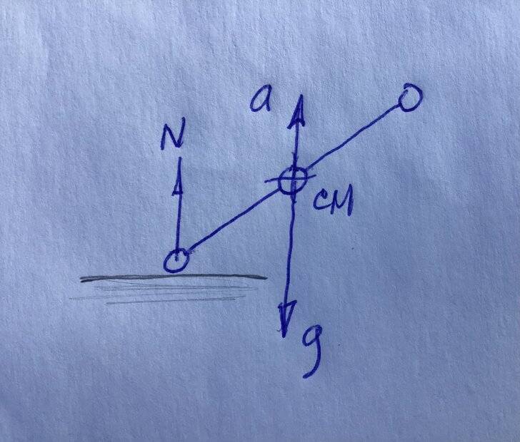

Thank you, professor.
I should have written ##N=0.5[m(g-a)]##
Still incorrect?
Likes MatinSAR
How do you get that?
Please, see diagram in post #21.
That diagram is not a FBD. If you want to mix forces and accelerations in one diagram you need to discriminate them.
##a## is an acceleration, but what is ##g## here? Nothing is accelerating at g.
In the usual formulation, the FBD would show forces F and N up, mg down. The resulting acceleration is ##a## up, giving ##F+N-mg=ma, F+N=m(a+g)##.
Another view is to use the frame of reference of a free falling object. That makes the force of gravity go away, but adds ##g## upwards to all observed accelerations, again leading to ##F+N=m(a+g)##.
But this does not lead to ##N=\frac 12m(a+g)##. The stick is not only rising at an increasing rate but also rotating at such, so there must be a net torque (anticlockwise in the diagram). Hence ##F>N##.

  • #31
I fully understand that.
That diagram is not a FBD one, it is simply a way to quickly visualize the net acceleration (g-a) that the CM is experimenting at the initial instant of lift.
The three minutes allowed time is not enough for calculations, just for a quick reasoning, it seems.
The reason behind that crude visualization, which intentionally leaves the rotational acceleration out, is to conclude that the additional upward force causing acceleration a is making the object "lighter".
At the same time, ...
... At the same time, the pivot point can't receive the full magnitude of that additional force because the CM is moving up at the same time the rotation is happening.
I don't understand that.
Isn't the CM always potentially accelerating at g?
If considering the length/height 3/1 proportion shown in the diagram, what the correct answer should be, according to your reasoning?

  • #32
Note in this video on tilt-up concrete walls, how the pivot edge slides toward the vertical line of action of the lifting force at the end of the erecting process.
  • #33
##a## is defined as the CM's initial upward acceleration. How can it also equal g-a or a-g?
An unjustified oversimplification, unlikely to lead to a valid result.
I have no idea what you are saying there. What additional force, F or something else?
That's what the force mg represents, but it makes no sense to add or subtract an actual acceleration to/from a potential one.

I contacted AAPT thus:
" … q9 at https://www.aapt.org/physicsteam/2019/upload/Fma-2018-A.pdf also caused some head scratching. The difficulty is that the diagram shows a rectangle nearly a quarter as high as it is long. Rather thick for a "stick", leading to the suspicion that one is supposed to treat the thickness as non-negligible. I.e., that for a solution to be considered correct it would have to allow for a thickness (height) y>0.
Remarkably, it turns out that the official answer is then no longer valid. For a uniform rectangular block with y> x*sqrt(2) we find N < mg/2, and for sufficiently large F can even vanish! Admittedly, the diagram does not suggest a stick thicker than it is long, but the crucial point is that to arrive at the answer validly the student would have to allow for a thickness, assume a three dimensional shape (block? cylinder?) discover the threshold y/x ratio, and observe the diagram implies a ratio below the calculated threshold.
All a bit much for a 3 minute effort."
Had this response:
"we (the current coaching staff) totally agree. Unfortunately, we've had a lot of turnover since 2018. I don't think any of us have access to the LaTeX source for that year, so we can't easily correct it. But we'll check our future diagrams very carefully with this sort of thing in mind."
Likes berkeman
