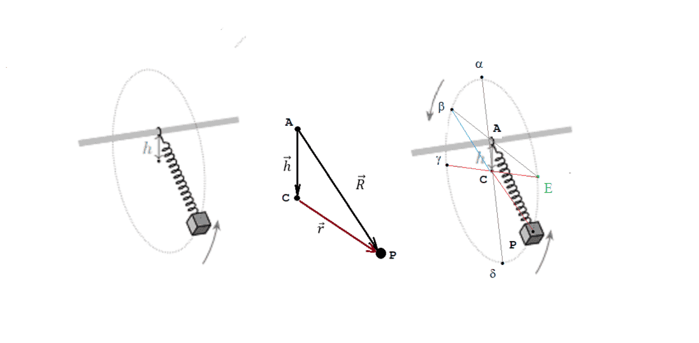

  • #52
sysprog said:
Why does the periodic varying of the direction of ##\text P## between toward the ground and away from the ground not affect the speed of ##\text P##, as it would if the spring were a rigid tether, or if ##\text P## were like the bob of a pendulum in that regard?
Because the string has zero relaxed length (which is not so in the other scenarios you mention) it happens that the vertical component of the tension is determined by the vertical height of the bob and the horizontal component by the horizontal displacement. The motions in the two directions become independent.
Therefore each motion is SHM and the two have the same frequency. By arranging that they also have the same amplitude and are 90 degrees out of phase, we have circular motion. It is clear that the peak velocities will also be the same magnitude, and that this will be the speed at all times.

  • #62
ehild said:
The problem maker might have took that straightforward, when assuming constant speed.
I don't buy that. It's far too big a jump to be made knowingly in a "textbook solution".
  • #63

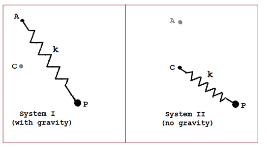

  • #65
hutchphd said:
OK. Let me try this. Do you believe that the constant speed is true if there were no gravity (g=0)?
Yes, but then the rotation would be circular about ##\text A##, rather than about ##\text C##.
  • #66
But gravity can be eliminated from the equation of motion by simply moving the origin : y→ y+##\frac {mg} k## This constant translation cannot change any velocities. It does change the origin to C
I am frankly mystified that there is an argument here.

  • #71
haruspex said:
No, in the absence of gravity A and C would be the same point.
That's a definitional difference. The mass rotates about point ##\text A## in either case. Removing the gravity would make the rotation about point ##\text A## circular with the center at point ##\text A##, instead of the rotation being circular about the point formerly called point ##\text C##. In discussing the effect of removing gravity, I regarded point ##\text C## as a static point already defined as in the original problem. You're using a dynamic definition of point ##\text C## to mean the center of the circle of rotation, wherever that is. The effect of removing gravity is the same by either description.

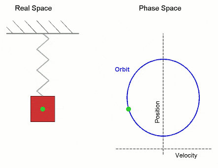

  • #75
hutchphd said:
What I said was much stronger than that and much simpler. With a simple change in origin, the equations of motion have complete circular symmetry and no longer contain the gravity constant g.
What is there to discuss? (If I seem vexed it is because I am! This is just a simple truth. If you feel the need to describe the springs in gory detail then OK we can do that but it cannot change the result)
In SHM the velocity constantly varies, unlike in uniform circular motion. I alluded to the variation in velocity in post #21, without using the term 'SHM' (I said that the variation in velocity of the rotation would be sinusoidally periodic). I think that strictly uniform rotation is not present, and that the constancy of the period and frequency suffices, along with the problem statement, to justify the argument in sentences 1 and 2 of the given solution.
From: https://en.wikipedia.org/wiki/Simple_harmonic_motion:
(edited to freeze the animation)
No-one who has done (or even witnessed) a bungee cord jump would suppose that the velocity is constant, but some might be surprised that the period and frequency are (ideally) constant

  • #77
It is SHM in each coordinate independently. Given the same amplitude and frequency but 90 degrees phase separation, the velocities are of the form ##v\sin(\omega t)## and ##v\cos(\omega t)##. The speed is therefore v, always: uniform circular motion.
Likes hutchphd

  • #82
As requested:
The equation of motion for the position r(t) of the mass without gravity is $$m\ddot {\mathbf r}+
k\mathbf r=\mathbf 0$$
Notice this describes a spring of zero unstretched length. If we put gravity in then the equation for R(t) contains the force
$$m\ddot {\mathbf R}+k\mathbf R=m\mathbf g$$
This still describes a spring of zero unstretched length.
Notice that any solution r(t) of the first (homogeneous) equation gives rise to a corresponding solution R(t) of the second (inhomogeneous) equation (and vice versa) $$\mathbf R=\mathbf r+\frac m k \mathbf g$$
and of course $$\mathbf { \dot R =\dot r}$$and $$\mathbf { \ddot R =\ddot r}$$
QED.
  • #83
hutchphd said:
As requested:
QED.
Ok, fine, but this just looks like a vector representation of the same method I outlined. And you are using the zero relaxed length, which was not clear in your earlier posts.
We are in violent agreement.

The vertical axis would not be restricted to 'down' only, but the gravity is always downward.
The equation of motion in coordinates is
##m\ddot x=−kx##
##m\ddot y=−ky+mg##
Given that ##k## is always directed along ##\vec r## toward the center, while ##mg## is always directed down, the ##\ddot y## acceleration of ##mg## alternates between
##m\ddot y=−ky+mg##
and
##m\ddot y=−ky−mg##.
This is a linear , constant coeffient, inhomogeneous DE. the solution of the homogeneous part is a two-dimensional vibration with angular frequancy
##ω=k/m## A particular solution of the inhomogeneous equation is ##h=mg/k## that corresponds to the steady state.
For the new variables ##X=x## and ##Y= y-h##, the differential equation becomes ##m\ddot X=−kX## and ##m\ddot Y=−kY##. The solution can be a circular motion with angular frequeny ##ω=\frac k m##, and arbitrary radius ##R##. Then the speed is constant, ##ωR##.
No basis is shown for assuming constant speed.
Given only the spring force, gravity, and from an initial static state at the equilibrium point an external initial tangential impetus sufficient to incipiate rotation, I think that the speed component of the angular velocity ##\omega##, although it would be of a constant frequency and period, would vary within the cycle, increasing in the left semicircle, and decreasing in the right, with ##v_{max}## at the lowest point, ##v_{min}## at the highest, and ##v_{mean}## at the two exactly vertical exorbital tangent points, downward and upward, at the leftmost and rightmost points, respectively.
The rightmost of these is the one that the problem recipient is in the solution asked to consider, and it is in my view sufficient for purposes of the argument that this point has the mean vertical velocity; the velocity is not, and need not be, constant throughout the cycle.
If there's something that I'm missing it wouldn't be the first time.

For either the gravity or no gravity case, if the mass starts at equilibrium and at rest and is imparted a horizontal impulse, it will oscillate in a line horizontally. The vertical velocity will be zero. Period.
  • #86
sysprog said:
Tension on the spring points inward from the circle to its center, while the gravity always points downward.
If the weight is moving counter-clockwise:
then on the left side of the circle, $$\frac {v^2}r=\frac{mg+T}m,$$so$$T=m\frac{v^2}r−mg,$$ and on the right side of the circle, $$\frac{v^2}r=−\frac{mg+T}m,$$so$$T=\frac{mv^2}r+mg.$$The spring alternates between storing the acceleration of gravity on the downward part of the circular path, and restoring it compensatorily on the upward part of the circular path.
Given that ##k## is always directed along ##vec r## toward the center, while ##mg## is always directed down, the ##\ddot y## acceleration of ##mg## alternates between
##m\ddot y=−ky+mg##
and
This is not right. The force of gravity always causes downward acceleration, and the spring force causes acceleration opposite to the displacement.
##m\ddot y=−ky+mg## is true
##m\ddot y=−ky−mg##. is false.

  • #88
sysprog said:
How then does the trajectory get to be circular, as in the drawing in the problem description? ##-## this version has the original, along with @TSny's vector diagram (which has ##\vec h##, where the original drawing has ##h## next to a ##\updownarrow## segment), and my syncresis from those two renditions ##-## I think that at point ##\delta## a tangential acceleration would be horizontal, and the spring tension is orthogonal to, not diametrically oppositional to, the horizontal exorbital tangent, and so coerces orbital, rather than linear, trajectory.
At point δ there are no horizontal forces, so no tangential acceleration.
I didn't understand the last bit, about linear trajectory. Are you arguing against circular motion now or against the special case of linear reciprocating motion that @TSny mentions?

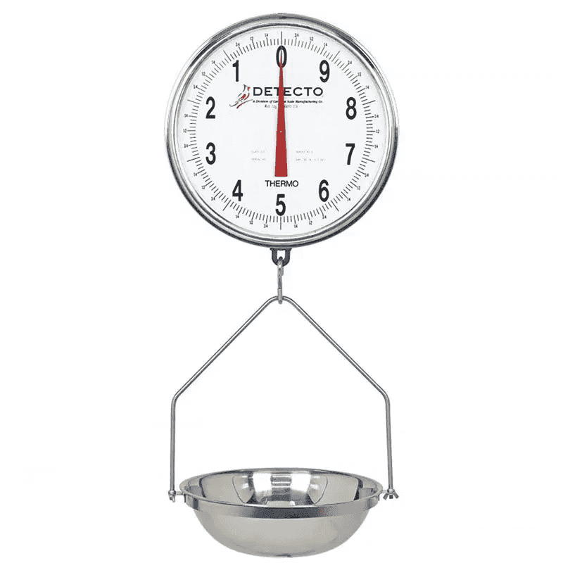

I'm grateful to @haruspex, @hutchphd, @TSny, @ehild, for responding to my meanderings regarding this matter, and to @guv for posing the problem and commenting regarding the responses.
When I was earlier today at the grocery store, although I was trying to be not too conspicuous, despite my desperado-style SARS-II COVID-19 kerchief, I went to the brink of consternating one or two members of the staff, by conducting a few crude experiments with the produce scale, which looked pretty much like this:
The one there was branded Ohaus, but it looked pretty similar otherwise. It had an attached ring (not present in the image here presented) above the 0 numeral, by which it was hanging from a hook attached to a substantially heavy steel frame.
The results of my necessarily overly hasty experiments confirmed nothing firmly, except that when I pushed and held mostly horizontally and somewhat upward at the U-shaped fixture below the ##\text 5## numeral, the red needle continued to point pretty much straight up, so that it was indicating a little below the ##\text 9## numeral on the scale, and that result was not inconsistent with my surmises regarding the tension and the effects of gravity and of opposition thereto thereon.
I think that my hope that I won't have to resort to doing second derivatives and definite integrals to try to clarify or justify, even to myself, what I've already said here about the velocity may be in vain.

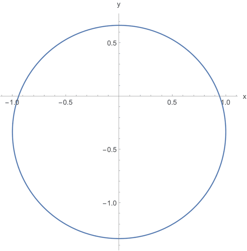

  • #96
sysprog said:
Why would both the radius of the circle and also the velocity of the weight be invariant within the cycle whatever the varying direction of the weight within the cycle with respect to the invariant direction of the gravity?
I think it is intuitive that this is possible in the absence of gravity (yes?). It certainly is easy to show also.
It has been shown almost trivially (see #83 ) the solution with gravity is identical in shape and speed and acceleration to the no gravity one.
Therefore it is absolutely true. One need not look farther.

  • #99
I am a latecomer to this thread, but there is a simple heuristic way to look at this by bringing two considerations together.
First, a vertical spring-mass system in gravity behaves as a horizontal spring-mass system with the equilibrium position lowered to ##\dfrac{mg}{k}## from the relaxed position.
In this case the position of the mass relative to the relaxed position can be written as $$y(t) =A\cos(\omega t)-\frac{mg}{k}.$$ The initial conditions are ##y(0)=A-\dfrac{mg}{k}~;~~\dot y(0)=0.##
Second, a mass, undergoing uniform circular motion in the ##xy##-plane of radius ##A## with angular speed ##\omega##, has coordinates $$x(t)=A\sin(\omega t)~;~~y(t)=A\cos(\omega t).$$ That's for a line of sight along the ##z##-axis. If viewed along the ##x##-axis the motion is the same (mathematically) as that of a spring-mass system oscillating along the ##y##-axis such that ##\sqrt{\frac{k}{m}}## matches the angular speed of the circular motion.
Putting the two considerations together, we can immediately write an expression for the position of the mass$$\vec r(t)=A\sin(\omega t)~\hat x+\left(A\cos(\omega t)-\frac{mg}{k}\right)~\hat y.$$We can verify that this works with a parametric plot (##A=1;~mg/k=A/3##)
Clearly, $$\ddot x =-\omega^2 x~;~~\ddot y=-\omega^2 y$$which are the equations of motion for a spring of zero length placed at the origin of Cartesian coordinates. Thus, we have a solution that is consistent with Newton's second law. Initial conditions and anything else one cares to find can be obtained from ##\vec r(t)##. Finally, I see no reason why this cannot be extended to a sphere in three dimensions.
