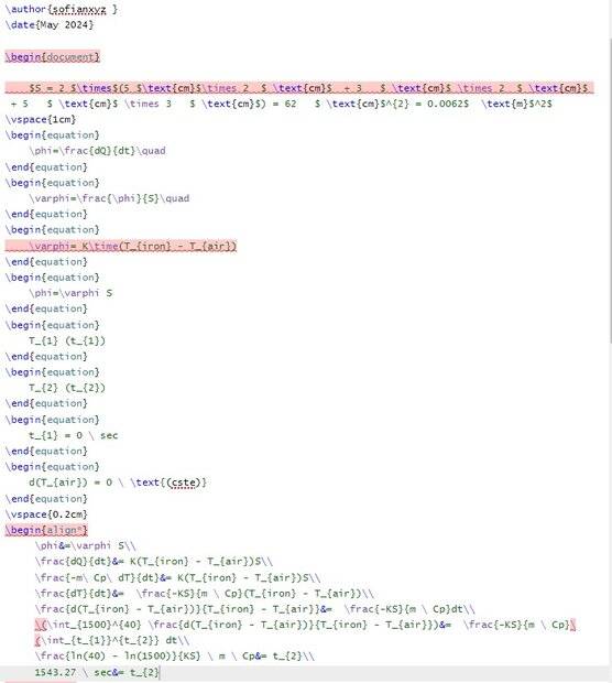

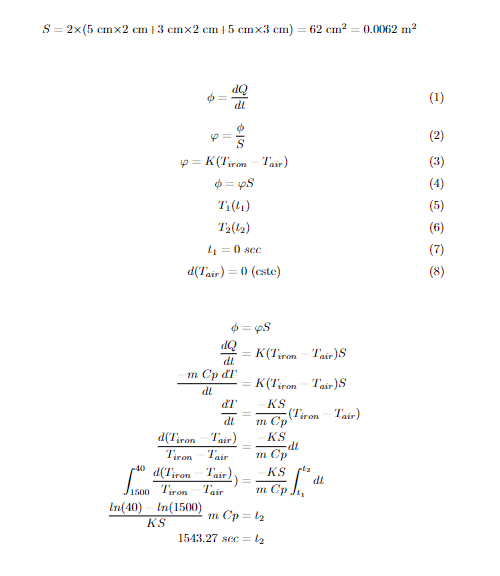

“We want to determine the time required to cool a block of iron weighing 240 grams, heated to 1500°C by forced convection in contact with air at the ambient temperature of 20°C.”
- We consider that all faces are exposed to the ambient air.
- surface = 62 cm^2
- Kconv = 40 W/(K * (m)^2)
- Cp = 440 j/(kg * K)
We have to use the formula : 𝜑S =𝜑 ∫dS and I really don’t understand why and how we use the integrals for the calculation.
Φ = 𝜑S
(dQ/dt) = k*S*dT
avec dT = (1500 + 273.15) - (40 + 273.15) = 1460 [k]
avec dQ = - 0.24 [kg] * 440 [j/(kg * k)] * 1460 [k] = - 154176 [j]
donc,
-(154176)/dt = 40 [W/(k * m²)] * 0.0062 [m²] * 1460 [k] = 362.08 [W]
It goes like this: The initial temperature is 1500 C and, apparently, your final temperature is supposed to be 40C.

Thank you for the link but that’s my resolution and I don’t know if it’s correct or not. Here´s my code LaTex on overleaf :
It looked right, though I did not examine it carefully.
It is poor practice to post images of text here rather than the text itself. For instance, you could have used:
Code:
\author{sofianxyz}
\date{May 2024}
\begin{document}
$S = 2.5$\times$(...
Or you could have enclosed the whole thing in a $$ pair and checked whether it rendered.
The advantage of posting text rather than images of text or of posting rendered rather than images of equations is that it allows us to correctly quote and comment on individual portions of your content. Or to post corrections. Or to accurately read what is written. It also allows you to snip away irrelevant context and post the relevant details.

No, that’s MY resolution. That’s MY code LaTex on overleaf :
walterminator said:
My reasoning: I found out about the method of separating variables and then I put everything that had to do with temperature on one side and everything that had to do with time on the other. I thought about it and told myself that the ambient temperature remained constant, therefore that d(Tair) = 0 and that t1 = 0 sec. since I separated my variables, that d(Tair) = o, then this gave the form 1/x dx and therefore it was necessary to limit the side relating to the temperature in relation to the temperature and that on the other side t1 = 0, the antiderivative of dt2 (using the constants of the integral) gave t2, the time necessary to cool this block of iron exposed to the ambient air by forced convection.
(by removing the constants from the integral)*
Am I right in thinking that you evaluated this:
by summing numerically?
The integral can be done algebraically:
I don’t understand at all what you are saying.
It is a standard integral, .
Yes ! That’s what I used but I’ve skipped this Line.
ok, I see it is tucked down the end of that near-unreadable LaTeX.
So is there anything you still need?
I think I got a slightly bigger answer, around 1800 seconds.
