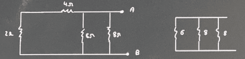

My attempt at a solution:

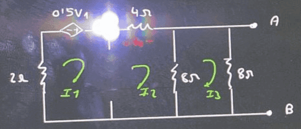

a) ##\boxed{V_{TH}}##
  • Current source equations ##\rightarrow \boxed{2=I_2-I_1}##
  • Control variable equations ##\rightarrow V_1=4I_2\rightarrow \boxed{0=4I_2-V_1}##
  • Super Mesh ##\rightarrow -0,5V_1+2I_1+I_2(4+8)-8I_3=0\rghtarrow \boxed{0=2I_1+12I_2-8I_3-0,5V_1}##
  • Mesh 3 ##\rightarrow 16I_3-8I_2=0\rightarrow \boxed{-8I_2+16I_3=0}##
$$\boxed{I_1=-1,5\, \textrm{A}\qquad I_2=0,5\, \textrm{A}\qquad I_3=0,25\, \textrm{A}\qquad V_1=2\, \textrm{V}}$$

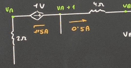

We know that ##\rightarrow V_B=V_{TH}##
$$V_A=0+1,5\cdot 2=3\, \textrm{V}$$
$$V_B=V_A+1-0,5\cdot 4=2\, \textrm{V}$$
$$\boxed{V_{TH}=2\, \textrm{V}}$$
##\boxed{R_{TH}}##
$$\dfrac{1}{R_{TH}}=\dfrac16+\dfrac18+\dfrac18 \rightarrow \boxed{R_{TH}=2,4\, \Omega}$$

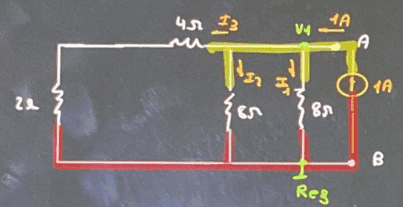

$$V_1\rightarrow -1+I_1+I_2+I_3=0\rightarrow$$
$$\rightarrow 1=\dfrac{V_1}{8}+\dfrac{V_1}{8}+\dfrac{V_1}{6}\rightarrow$$
$$\rightarrow 12=3V_1+2V_1=5V_1\rightarrow$$
$$\boxed{V_1=\dfrac{12}{5}=2,4\, \Omega}$$
$$V_1=R_{TH}\rightarrow \boxed{R_{TH}=2,4\, \Omega}$$

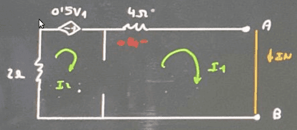

##\boxed{I_N}##
  • Current equations: ##\boxed{2=I_N-I_2}##
  • ##S\rightarrow \boxed{4I_N+2I_2-0,5V_1=0}##
  • ##V_1=4I_1\rightarrow \boxed{0=4I_N-V_1}##
$$\boxed{I_N=1\, \textrm{A}}$$
$$R_{TH}=\dfrac{V_{TH}}{I_N}=2\, \Omega \rightarrow \boxed{R_{TH}=2\, \Omega}$$
I was doing this exercise and the time to calculate the intensity and the Norton resistance doesn't add up... I've done it in different ways and I don't know where I fail. I don't know which one is right.
Well, since you've no replies yet and we don't want you to feel neglected...
I’m no expert and I haven’t checked much of your work. But this might help…
The supermesh (with my limited knowledge) will consist of the left and middle loops only - because they share the current source. The right-hand loop is not part of the supermesh.
So. my supermesh equation would be (starting on the negative side of the voltage source and going clockwise):
##0.5V_1 - 4I_2 -8(I_2 – I_3) - 2I_1= 0##
Also, avoid writing down things like ##V_1 = 2.4Ω##. A voltage can't equal a resistance. It suggests you are confused.
Note you could simplify the problem. Replace the two parallel 8Ω resistors by a single 4Ω; this gives you an easier circuit to analyse.
If you are struggling with supermesh analysis, there are some good YouTube videos.
I have found the error. It's working fine now.
