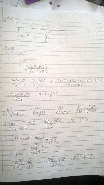

Hi can someone explain why my answers are different I am well confused
  • my answer.pdf
  • #77
Check your calculation of the load impedance. What's the magnitude of the impedance that you calculated?

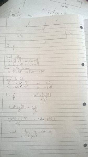

This question has been killing me for weeks. I thought I was gaining a good understand and this question just blew me away, so I had to look for assistance on the net - I'm a bit relieved that I'm not the only one that's struggled with it.
gneill, I looked at your post #17 (below) and went away to try and make the voltages based on the same trig function and the t time aspect of it completely knackered me, as I had no idea how to get rid of it. Then I see your post above - and I don't think I have come across that in my course notes - and it almost looks too easy. You can just lose ##sin(\omega t)## or ##cos(\omega t)## and that's OK?
Initially we're told that v1 = √2 x 415 x (cos (100 x pi x t)) Volts
and we're then saying that:
v1 = 415 ∠ 0 Volts and subsequently that v2 = 415 ∠ 90 Volts as (sin (x) = cos (90 - x)) and 90-0 = 90.
That can't be right, surely?
I'm confident - if i can get to that point - that I can convert polar to rectangular form and vice versa, but could you just explain what you mean when you say "... polar form of the signal in the frequency domain". This has done me in a bit. And once again you just can't get away from this question.
gneill said:
Take a close look at the definitions of those voltages. If you're going to use phasors to do the calculations you want to make sure that both of them are based on the same trig function, either sine or cosine. That or carry the full functions through the math and use trig identities to sort out adding or subtracting them. It's usually easier to just make them both either sines or cosines right from the start.
  • #79
Yes, that's okay. This is the beauty of using phasors to analyze AC circuits. By Euler's formula:

v1 = √2 x 415 x sin(90)
v2 = √2 x 415 x sin(0)
Not quite sure why you're setting t to zero, unless its to highlight the phase constants?
Anyways, there's no point in playing with t since you're about to abandon the time domain entirely and move to the frequency domain (or I suppose one might call it the Laplace domain) by switching to phasor notation.
Now at this point i refer to my own notes i can see "V = V∠θ (r.m.s) or V = √2 x V ∠ (peak)" and i assume that's relevant. Although at this point i just hit a brick wall. People are just losing √2 and i have no idea why or how. Can anyone help me please?
A few things to note:
When sources are given in the time domain they are usually specified in terms of peak value. So unless otherwise indicated, a source that's defined by a sine or cosine function of time will have its magnitude specified as a peak value.
To convert between peak and RMS for sinusoids you divide the given magnitude by √2. To convert from RMS to peak you multiply the magnitude by √2.
Algebraically the √2 is just a scaling constant, so for voltage and current values you can take it out or put it back anywhere along the line of your calculations to convert from one to the other.
If you are doing power calculations, unless you're looking for instantaneous power values in the time domain you want to use RMS values for the voltages and currents. Using RMS leads to the proper "real world" power values for steady state operation of the given circuit.
In the present problem the author conveniently specified the time domain voltage sources with the √2 in plain site, allowing one to simply trim it off and have nice round numbers for the RMS values.
At the end of the problem if you need to convert from the phasor domain back to the time domain then you are welcome to tack the √2 back onto the magnitude when you write the sine or cosine functions of time.

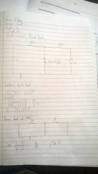

  • #83
I've read and gone over this feed so many times and I'm still confused. I can find the thevenin reactance, that's easy. But this is what I've got and I have no idea why it's so different to everyone else's in regards to the current out.
j4 + j6 = j10 ohms
V1= 415angle90 = j415
Therefore, to find the current I1 and thus find the thevenin voltage:
j415/j10 can't divide by a j number so multiply by conjugate.
j415/j10 x -j10/-j10 = 4150/100 = 41.5A so I1 apparently = 41.5A
Then multiply I1 by the resistance in parallel with the load/exposed terminals, as far as I can see that's both of them.
41.5 x j10 = j415 and I'm back exactly where I started.
This is how the hand out says to do it. Then do the same for the other voltage source and add the two voltages together to get Vth.
Where have I gone wrong?

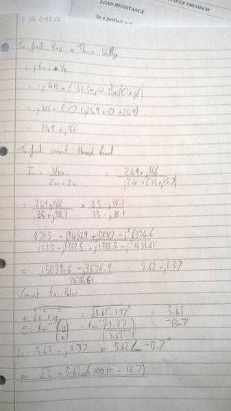

Right, so now, on that logic. I have got.
j6 x (41.5 - j41.5) + 415
Which gives
j249 + 249 + 415 = 664 + j249?
If this is correct wink twice.
  • #91
Ok.
I haven't checked your maths, but using that, you will now have a Voltage, Vth connected to j2.4, connected to Z_load, with current, i through the load.
Calculate Z_load (pretty simple)
Hence current in load is:
Vth = ...
  • #92
The current in the load will be
Vth/(Zth+ZL) which from this I'm going to go for.
664 + j249/ j2.4 + 40.95 + j28.68
Therefore
IL= 7.36 - j3.95
In polar 8.35angle28.2
Therefore
IL= root2 x 8.35 sin (100 pi t + 28.2)
Is that the right way?

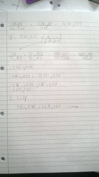

Ok, I'm going to start again and work my way through making sure I get each stage right. Then I'll post my calculations and results.
Thank you magician, you've been a massive help! :)
  • #96
Just a quick one, the -v1+ j4 x I + j6 x I + v2 that's from nodal analysis isant it?
  • #97

iL = 5.71 + j0.89 or 5.77angle8.86 or root2 x 5.77 sin (100 pi t + 8.86)
I thought I had it right, but then did the superposition theorem in the next question and the answers are completely different.
  • #98
Okay, so your Thevenin approach looks good, and your answer looks fine.
For the superposition version, can you first describe in broad strokes what your approach is?
  • #99

Okay so I've got up to..
V1 = j415
V2 = 415
But when substituted into the circuit equation for 'i' ( -V1+(j4*i)+(j6*i)+V2 = 0) I'm getting i = -41.5 + j41.5, where am i going wrong?
  • #103
I've completed parts a) and b) thanks to some heavy swatting and a whole load of coffee.
now to part c) anyone willing to lend me a hand with this one?
  • #104
V1 = j415
V2 = 415
I too am getting I = -41.5 + j41.5.
-V1 + (j4 * I) + (j6 * I) + V2 = 0
-j415 + (j4 * I) + (j6 * I) + 415 = 0
j10 * I = -415 + j415
I = (-415 + j415) / j10
I = -41.5 + j41.5
Why am i going wrong there?
I = -41.5 + j41.5
I = (-415 + j415) / j10 can be rewritten as:
I = -415 / j10 + j415/j10 and further as:
I = 1/j * -415/10 + j/j * 415/10
If 1/j = -j and j/j = 1, what do you get if you carry out the arithmetic?
It really helps to have a calculator that can do complex arithmetic.
