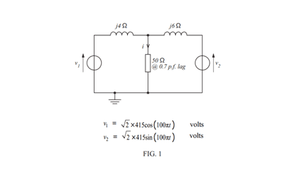

FIGURE 1 shows a 50 Ω load being fed from two voltage sources via
their associated reactances. Determine the current i flowing in the load by:
(a) applying Thévenin’stheorem
(b) applying the superposition theorem
(c) by transforming the two voltage sources and their associated
reactances into current sources (and thus form a pair of Norton
generators)
2. Homework Equations [/B]
Could someone please help me get this started? The 'hand outs' I have been given are awful, and do not explain how to incorporate the reactance and p.f.
If all of the loads were simply a resistance, I can see this being fairly easy. Although I could be wrong! Any help is appreciated.
Many thanks

Hint: Convert the load to a complex impedance. Then treat everything like resistors but use complex arithmetic.

Not quite. The 50 Ohms is the magnitude of the load impedance. The power factor tells you what the angle of the impedance is (for a complex number in magnitude / angle form). Remember that the power factor happens to be the cosine of the angle.

No. You are given Z=50 ohms, not R=50 ohms.
With the angle and the magnitude you have the load impedance in polar form. Thus
$$Z_L = 50 \Omega ~~\angle 45.57°$$
You can convert this to rectangular form if you need it that way.
By the way, before you dive into the calculations for the Thevenin equivalent, take a close look at the definitions of the voltage supplies. While they both have the same frequencies they won't have the same phase angle (why is that do you think?).

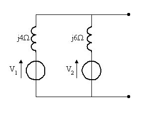

With the load removed, you are left with two equal-frequency voltage sources connected by a pair of inductances. Find the voltage at the junction of the inductors and that's going to be your Thévenin voltage.

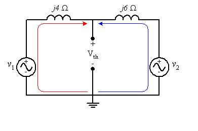

The load stays right out of the picture while you are determining the Thévenin voltage.
You are at the stage of trying to determine the voltage at the junction of the inductances.
If you're concerned about how the circuit looks when the load is removed, redraw it so it looks more familiar:
Once again I encourage you to look at the specifications of V1 and V2. See post #7.

Since you're looking for the Thevenin equivalent, my instinct would be to find Vth using nodal analysis. Take a look at the circuit rearrangement I presented in post #15.
I suggest that you want to keep the components separate because you have other methods to apply (problem parts b and c) that will require them to be separate.
