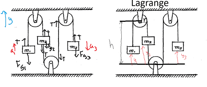

In the illustration that follows, a mass of ##m_3=7kg##, drag the mass ##m_1=2kg## and ##m_2=4kg##. The rope and pulley masses are negligible. What are the masses's acceleration modulus and the Tension of each ropes.
$$\sum \vec F = m\vec a$$
It has been a while since I did a atwood problem and this one has stumped me. I am not sure if this is the right place (please tell me if so). I want to see if anyone has insight.
Using the y-axis, I have defined and each forces on each masses. Knowing that ##a_1=-a_3## and each Tension ##T## are the same (massless pulley), I have written three equations for each masses.
1) $$-m_3 a = T-m_3 g$$
2) $$m_1 a = T - m_1 g$$
3) $$-m_2 a = T - m_2 g - T = -m_2 g$$

This can easily give the acceleration as ##a=5.44m/s^2## and ##T=30.5N.##
However that 3rd equation centered in mass 2 is not consistent. it shows that a=g for that mass all the time. My thought would be that my understanding of the tension for that mass is wrong or it somehow is not accelerating at the same speed as the other two masses. The first one being a way better reasoning, changing one of the tension (the one of the rope under ##m_2##) to the opposite direction yield

It seems to me that you are excluding the inertial effect of m2 in the overall acceleration of the 3-mass system.
My calculated value for that acceleration is 6.79 m/s2
If the masses are accelerating, which they are, not all pieces of rope have the same tension that you labeled ##T##. Specifically, mass ##m_3## is shown being pulled up by tension ##T## and also down by the same tension. The two tensions would cancel each other out and the only force left acting on ##m_3## would be gravity which means that this mass is in free fall as your equation 3) shows.
I recommend that you label the tension in the piece of rope that goes over the top left pulley ##T_1## and the tension is the other piece ##T_2## and rewrite the equations.

This is actually on point! I have just redone it and I have made a grave mistake, I took it as one full long string/rope instead of two separate one with their own tension!
Doing so I get
$$a = \frac{-g(m_3+m_2-m_1)}{m_1+m_2+m_3}$$
which truly gives 6.79 ##m/s^2## with the value given.
You also get back the ##m_2## dependance on the other masses. This was truly a blunder and I can't believe I found it an hour after I wrote this.
I have also used the Lagrangian method considering two rope of fixed lenght ##\alpha_1## and ##\alpha_2## and I recover the exact same result for the acceleration.
