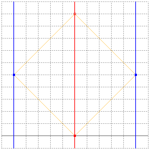

  • #44
To be sure that I can follow your explanations, that with the number of replies can become a little confusing with so many different replies to consider, let me check a few basic premises to be sure that I am correctly appreciating the concepts.
1. The view of space from any Inertial Frame of Reference is at rest; i.e. there are a set of axes that give a fixed set of coordinates for any point in space.
2. A full set of four coordinates specifying a fixed point in space, at a specific point in time, constitutes an event.
2. Every event can be mapped, that is given a unique set of coordinates, in any Inertial Frame of Reference.
3. Events, being fixed in time cannot move.
4. There must be a fixed point with a set of unique spatial coordinates, midway between any two events, in every Inertial Frame of Reference.
5. If light from two events, arrive at the fixed point midway between them at the same time, (which constitutes a single event), then those events were simultaneous. (Einsteins definition of simultaneity).

  • #47
Grimble said:
So following point 2, the two events, let's all them A and B, from which light was emitted that met midway at, let's call it point C; those two events A and B would occur in every inertial frame of reference?
(my emphasis)
Events are events. They exist, therefore they exist in all frames. If I meet someone at the station at 8pm that is an unchangeable physical fact. My worldline intersected with the other partys worldline. Everyone will agree that we met, furthermore everyone will agree that our clocks read 8pm when we met.
