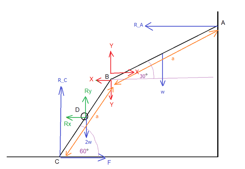

Could I ask for a hint as to where to go next with this question please?
I've done this first part, to find the reaction on the wall. Here's my diagram:
I've labelled the internal forces at B in red.
In green I've shown the reaction at the ring.
So I need to find sqrt(Rx^2 + Ry^2) = R.
So I need to find Rx and Ry in order to calculate R.
For the whole system:
Vertically: R_C + Ry = 3w
Horizontally: R_A + Rx = F
For BA only:
Vertically Y = w
Horizontally: R_A = X
Moments about B gives: R_A * a sin(30) = w * (a/2) * cos(30) which yields R_A = sqrt(3)*W/2 as required.
Now that we know R_A, for whole system:
Taking moments about C leads to: sqrt(3)*Rx + Ry = w
Not sure how to proceed.
If I take moments about C for BC only, this leads to the same equation sqrt(3)*Rx + Ry = w
If I take moments about D for BC only this yields: R_C - sqrt(3)*F = w/2
All my answers above are consistent with the book answer, but I can't see how to proceed.
Book answers is: R = sqrt(Rx^2 + Ry^2) = w/2
So, I am trying to find Rx and Ry in order to calculate R.
Thanks for any pointers.
The ring is smooth. Can you deduce from this anything about the direction of the reaction force ## \vec R##?
Yes, of course, thank you. The reaction force R must be perpendicular to CB, and so using my already derived formula sqrt(3)*Rx + Ry = W and replacing Rx with R cos(30) and Ry with R sin(30) I find that R = w/2 as required. Thank you very much indeed.
