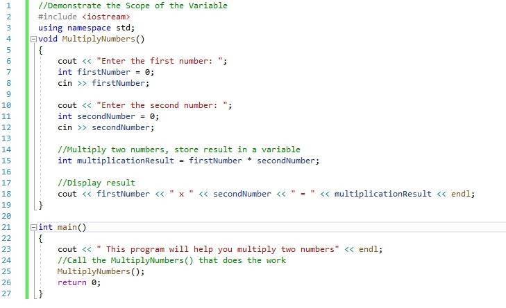

yungman said:
So those are not called subroutines, they called declarations or prototypes of the functions now a days?
What you're calling subroutines are functions. Both Fortran and Pascal distinguish between blocks of code that return a value (functions) and blocks of code that perform some action (subroutines in Fortran and procedures in Pascal).
Some additional terminology that is used in object-oriented languages is method, a function that is associated with a particular class.
Here is an example of a function prototype. The prototype (or declaration) provides the name of the function (triangleArea), the number of parameters (four) and types of the parameters (all are type double), and the type of value returned (double)

Here is an example of a function definition. The function definition includes the function header and the code for the function.
C:
double triangleArea(double sp, double a, double b, double c)
    double area = std::sqrt(sp * (sp - a) * (sp - b) * (sp - c));
    return area;
In large programs, it's often convenient to place the function declarations in their own file -- a header file, usually with a .h file suffix.

The Include folder contains the standard library header files. If you write your own header files, you could add them to the Include folder, but this is not a good idea. Usually any user-written header files would be placed in the same folder as the source code for your program.

  • #52
yungman said:
Hi
I just want to learn a language, but I don't know which one is best for me. I did programming back in the 70s and early 80s, mainly in assembly language. I learned Fortran, Basic and Pascal before, but they are so old. I since changed my career to analog and RF electronic designs and had not tough programming since. This is mainly for mind excise, I rather this than crossword puzzles for retirement.
I am thinking about C# or C++ as this is used in firmware design. Another one is like Python because both my grandkids are into gaming, I bought a book of Python for Kids to my teenage grand daughter and she is learning it. So that is like playing with grand kids. One kind I don't want is language for business, I have no interest in business, mainly scientific or maybe gaming.
Any suggestion will be appreciated. Also how to get started when I decide on one language.
Thanks

I just put in and ran a little program on my own! This started out as an exercise, but I added in display and making new lines by using <<endl command and put text in it. It worked! this is my little program:
#include <iostream>
int main()
int x = 8;
int y = 6;
std::cout << std::endl;
std::cout << "x-y=" <<x - y << "" << std::endl
<< "x*y=" << x * y << "" << std::endl
<< "x+y=" <<x + y << "";
return 0;
}The cmd.exe shows:
This is my first one. I am stoked.

No no, I way passed that 2 days ago, this is writing a local function and how to declare global variables. It's like the program showed in post #67. I'll try the new project from existing code.
thanks

  • #99
yungman said:
Thanks for you response
So the syntax: int moreNumber[ Square( ARRAY_LENGTH ) ]; is correct?
This looks like it's a constant array of 25 elements. Which has NOTHING to do with constexpr at all.
It's not a constant array. If it were, you wouldn't be able to change the values of any of its elements. constexpr in line 3 creates a constant that is the square of another constant.
yungman said:
So what is line 3 constexpr int Square(int number) {return number*number} for?
It essentially defines a function that is evaluated at compile-time, rather than at run-time, where functions are typically evaluated.
yungman said:
that's my whole confusion. doesn't seems like I need line 3. The book say nothing about this. I am starting to think this is not a good book, throwing out stuffs it has not covered.
You need line 3 because it defines what happens in line 10. The program wouldn't compile without line 3.
yungman said:
Maybe I should buy another one as backup. Nothing so far is complicate or complex, I just need a simple syntax instead of guessing like what I am doing. I don't buy that because it's a C++ book that it doesn't cover the basics in C. I just went through 60 pages of the book describing the simplest of the simple syntax, then all of a sudden skip the more complicate one like this. The next example show to look for the size of the array with like moreNumber.size() without even explain about it also.
The arrays you have in the program we're discussing here are ordinary C-style arrays. If you have an example that uses moreNumber.size(), they must have declared the array differently, using the Standard Template Library (STL) array template. Here's an example of what I'm talking about.
C:
#include <array>
array<int, 4> ai = { 1, 2, 3 };
int size = ai.size();           // size is set to 3
If they jumped from C-style arrays to STL container classes with little or no explanation, this is probably not the best book to learn from.
Although C++ builds on many C concepts, most C++ books are not going to teach you C before presenting material on C++.
Likes yungman
