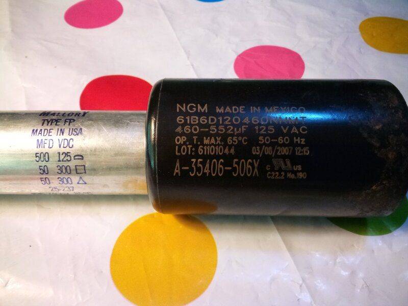

Have farm motor 1 hp 600 mf capacitor failed can one slip old tv style capacitor in old can as this motor runs on 220 ac?

NO. The motor capacitors are Bi-polar AC, not DC like those used in electronics.
How many capacitors does it have?
Is the AC capacitor rated at 250 VAC for starting, or 450 VAC as a run capacitor ?
If it has only one, a start capacitor, then it needs a value somewhere between 30 uF and 60 uF.
Motor start caps are available from electrical providers and on teh web.
The unit uF = 1x10-6, once used to be called mmF, = 1x10-3 * 1x10-3 = 1x10-6 = uF.

Instead the bottom of the capacitors please add some pictures about the text on the sides.
Also, something about the motor so we can identify it.
If it remains a guesswork as it is right now, then the general answer is - no.
Motor starting capacitors really can't be replaced with anything else. Why are you wanting to take this shortcut? Are you concerned the motor is defective and don't want to waste the money on the correct part?

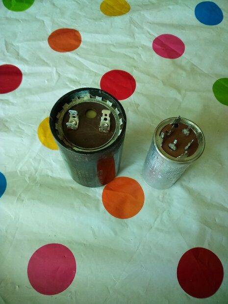

Only difference I see and don't understand is motor capacitor is AC and tv capacitor is DC, see no reason to not try either motor will start or not.

It is all to do with the chemistry at the surface of the aluminium foil.
From: https://en.wikipedia.org/wiki/Electrolytic_capacitor
"Electrolytic capacitors are polarized components due to their asymmetrical construction and must be operated with a higher voltage (ie, more positive) on the anode than on the cathode at all times. For this reason the anode terminal is marked with a plus sign and the cathode with a minus sign. Applying a reverse polarity voltage, or a voltage exceeding the maximum rated working voltage of as little as 1 or 1.5 volts, can destroy the dielectric and thus the capacitor. The failure of electrolytic capacitors can be hazardous, resulting in an explosion or fire. Bipolar electrolytic capacitors which may be operated with either polarity are also made, using special constructions with two anodes connected in series. A Bipolar electrolytic capacitor can also be made by connecting two normal electrolytic capacitors anode to anode or cathode to cathode."

DC caps cannot handle AC. It'll just explode.
And it'll be quite violent too. Just don't do do this.
